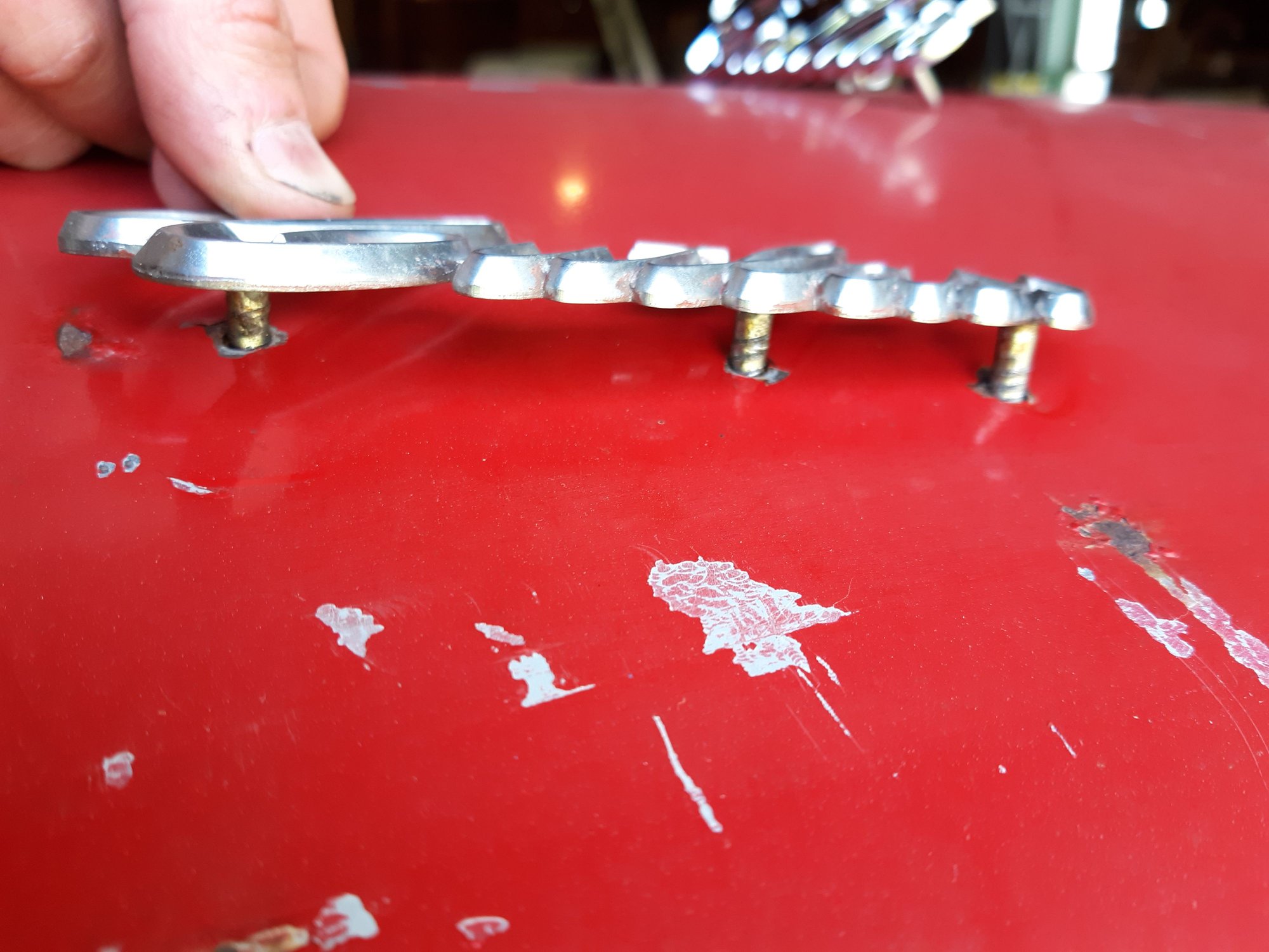

Repro - Using pin at C as reference
Repro - Whole pattern is off.
Original slips right in.
Original
Repro in back, original in front
Repro on top with pin at C as reference
The whole pattern is off. For example, I could not cut off the pin in the middle and use it with two.

I did some comparisons and it ended up taking a while as I bought emblems and learned as I went. As stated above the emblems from PP (EM2453T) do not line up with original pin holes and original emblems. Next I bought a set from Fusick (SE12FP). Unfortunately, they too did not line up with the original pin holes in my old fenders and may have the same pin pattern as the PP emblems. Then I bought some NOS emblems and they did line up with my pin holes and match my old original emblems. However, they were not as nice as I had hoped they would be especially when you compare them against the repro emblems which are crisp and have beautiful chrome plating.
So, I got another set from OPG (C230023). They make a claim right in their catalog; "correctly-located mounting pins". They were on back-order for a couple months but finally arrived today. They came through... They match up with my original emblems and fit right into the factory holes in my original fenders.
So if you are buying emblems keep all this in mind. If you want repros that match the originals in terms of pin location, OPG is your best bet. If you don't care about the pin location, the emblems from PP and Fusick are really nice but will not work if your fenders are already drilled per original factory emblems.
