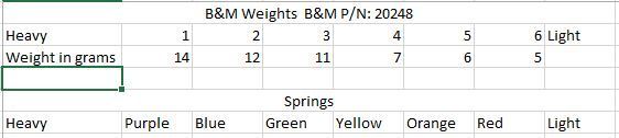

FYI - There are actually 6 different weights included in the B&M Kit (P/N 20248)

Seems V8al is correct. The kit has 6 different weights, not 3 pairs of weights as I thought. They are stamped with a number (1-6) I didn't see with my old eyes. 1 being heaviest 6 being lightest. What is deceiving is that the shape of them does not dictate their weight. What I mean by that is what I thought were 3 pairs because of thier shapes, one of each pair is made of thinner material so is much lighter than its match. I actually used weights #3 and #5. I plan to go back in and change something to bring that shift point down. I don't care for that 5700. Think I should use 3&4 or 2&3? I would be more comfortable around 5200-5400.

Today I took the #5 weight out and changed it for #4. I didn't hook up the tach yet but it brought the rpm down a bit. I'm much more comfortable with it now. If I had to guess I bet it's more like 5500 shifts now. I'll post actual RPM when I test with tach.
