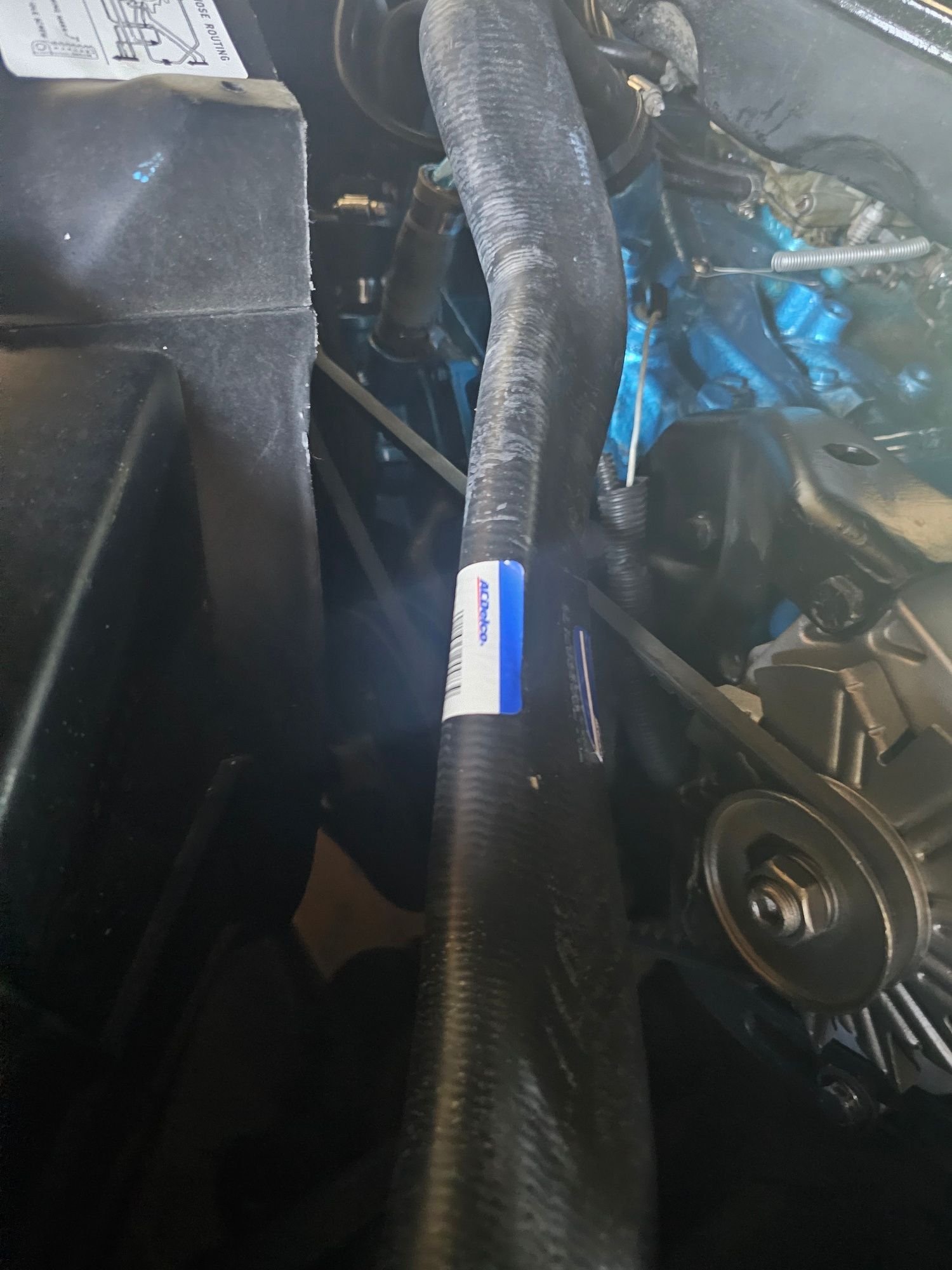

Do I have an issue to address or is this normal? See Pic. The upper hose off the radiator to the block collapses after the engine cools down, or at rest.? Is that normal.

Maybe you have a vacuum / blockage condition being created during those periods which is sucking the hose in. Maybe try bleeding/burping your cooling system the cap off.
If the hose is old, try changing it out. It not too old, maybe put a spring in it like bottom hoses have.

Also check the radiator cap. Does this car have an overflow jug or just a puke hose?
Old Sep 19, 2024 | 12:35 PM
Posts: 42,475
Your radiator cap may be faulty.

New hose and has a overflow jug.

Just put a new hose on old one did the same thing.
I'll try "burping the system" and also try a new cap?

Is it an overflow (like puke bottle) or a coolant reservoir where coolant flows back into the radiator when needed. As a reservoir, there should be little to no vacuum on the system when it cools, so it makes the cap suspect.

Changed out the radiator cap with a new one from NAPA (16lbs pressure rating). We'll give that a try. The other one was marked 0.9!!

The 0.9 was probably 0.9 bar or around 13 psi.

Is your new radiator cap made for recovery? Most are nowadays, but there's also ones that do NOT have the vacuum break that were made for non-recovery situations.

Here's what the website says....I think I'm OK - your thoughts?
Bob
Napa #703-1699
  • The SWIV-EL design allows the cap to be installed and removed much easier than conventional radiator caps. Meets original equipment specifications.
  • Made from premium materials. Designed to function on open cooling systems and overflow reservoir type systems.
  • 100% tested to ensure proper pressure and longevity
  • Meets all OEM specifications

Insert a hose spring.

Thanks I think I'll do that. Sometimes it's the little things that annoy me, but this just doesn't seem right (the hose collapsing). I did get that new cap too.
