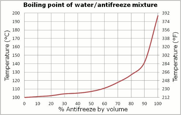

Observing the shape of Joe’s graph, is there a good reason to go the other way - 20% water / 80% coolant for added boil over protection?
I believe Fun71 is correct about water being a better absorbent/conductor of heat, so in theory you’ll never _get_ to that boiling point if things are working right, but it wouldn’t bother me to run more coolant and less water if that’s better for the lubricants, anti-corrosion additives and a higher boiling point. To be sure Northern California isn’t as hot as Phoenix, but we had 10-14 days this year of 100+ and at least 2 or 3 north of 110°, so I’m open to all theories and experiences with coolant.

Originally Posted by cfair
Gang,
Thanks for the echo on 70/30 mix approach. I don’t have a big thing about being right, but if 50/50 has higher boiling point, maybe I’ll do that next time.
I’m not fussed about a few bucks on coolant every 5 years either, I don’t drive these cars anything like daily, so I swap coolant more as a preventative maintenance / cleaning thing.
Didn’t mean to ignite a kerfuffle over coolant, just trying to learn as I go after 40 years or so with these dinosaurs.
Happy Glycol to all
Chris
Plus, that chart appears to be at atmospheric pressure. Put the system under pressure and it will raise the boiling point. Doesn't lower the freezing point unless you get to like 60 psi by much, then only like 10 degrees F.
Agreed, but it raises the boiling point of all the mixture ratios similarly, so the delta T between them is essentially the same.

The boiling point difference between 30% and 50% antifreeze is negligible.
The difference between 20 and 30 is just as negligible. Why don't we run 20%, or even 10%? In fact, why run anti-freeze at all?
What is the difference in corrosion protection? If there is no harm in running 30% vs 50%, then why has every owner's manual since the beginning of time said to put in a 50-50 mixture? To sell coolant?

This is the chart that really matters. What do the various percentage mixtures boil at at 15 (or 16) psi, not 1 atmosphere.
At 16 psi, plain water boils at 252, a 1/3 mixture of anti-freeze boils at 260, and a 50% mixture gets is 267. 60% is even better, buying you a 13 degree increase over the 1/3 mixture.
