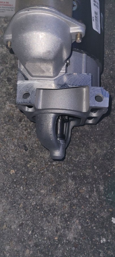

Got both starters today and the mounting holes are correct. Now my dilemma is while I like the thought of using the AC Delco, it was remanufactured in China, and both the surfaces of where it makes contact with the engine block, as well as the "bosses" for the flanged bolts aren't machined like the Remy (see pics below). On the other hand, while the Remy looks to better made, well, it's Remy, so I wouldn't have the satisfaction of having a genuine AC Delco part, but it was put together in Mexico.
Here's the AC Delco:
...also, notice the hole in the bottom of the casing. Any ideas on why that's there?
And here's the Remy:
Note there is no hole in the casing.
What would you do?

Posts: 25,795
It's a drain hole. It's purpose is to drain moisture in the form of liquid water from the inside of the starter. Depending on manufacturer the drain hole can be placed in a different location (or locations) - some round, some square, some rectangular and not all located in same areas. The drain hole(s) will be facing in a downward direction regardless of size &/or number of holes.
