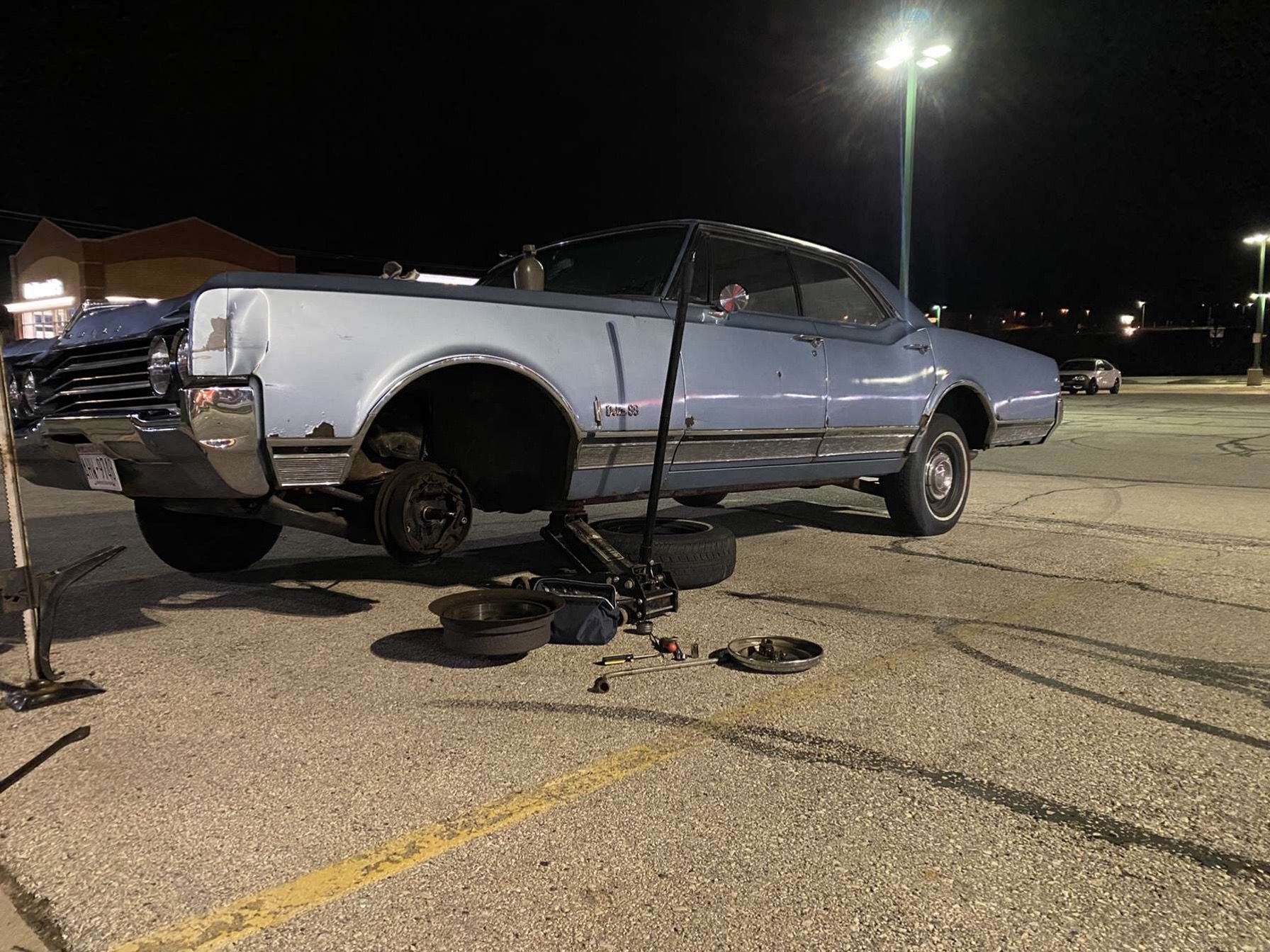

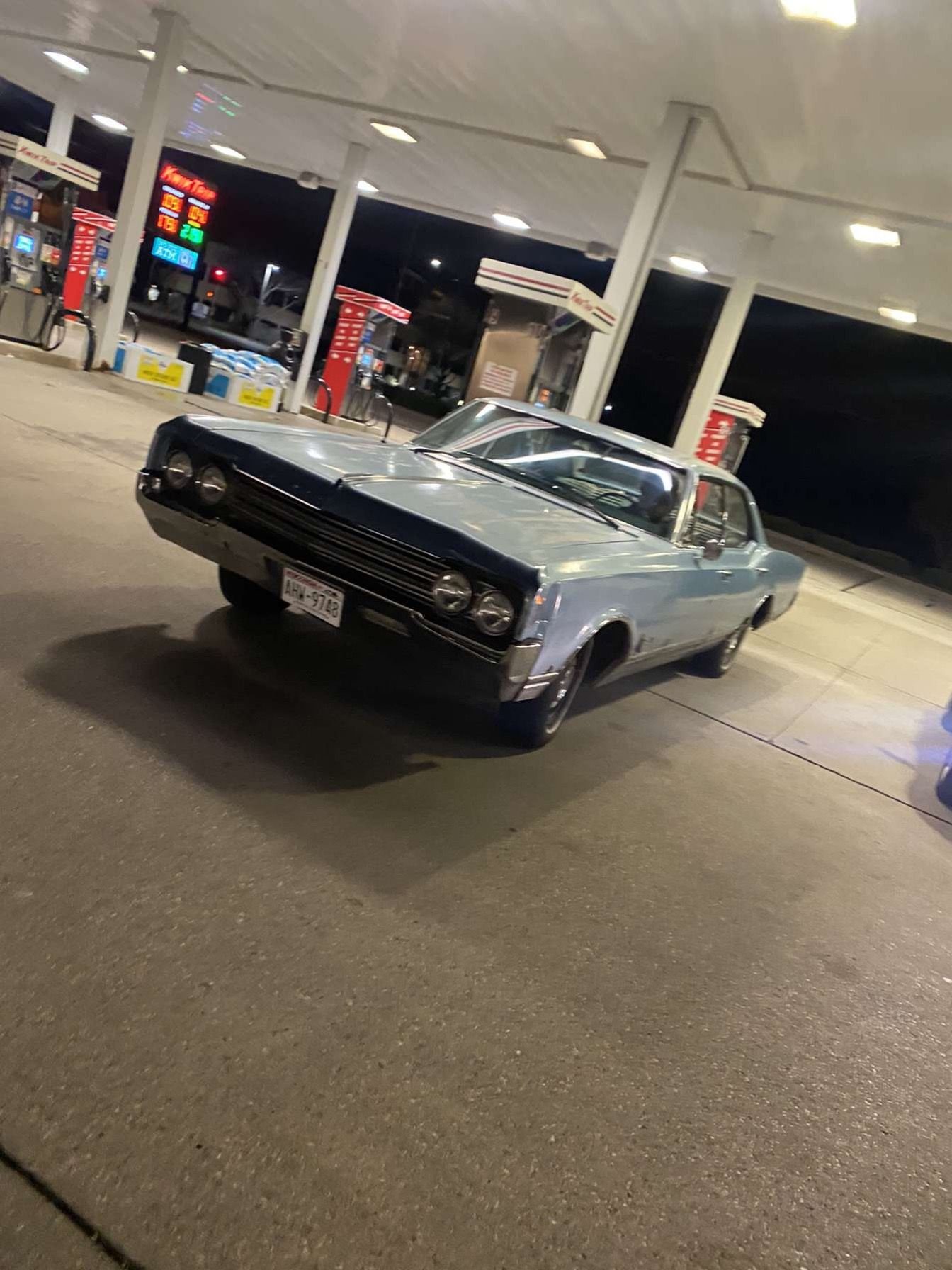

In my mind I picture an J2 tri-carb setup but it may not be practical in your application. Sounds like a great project. Pics please!

daily beater
It’s my daily driver that gets some more miles on the weekends with some occasional beatings on it. Dual exhaust on it Already, stock motor as far as I know from what the previous owner said and how it feels. It’s the 2gc 2Brl carb. Just thought with the dual exhaust that a 4Brl with an intake would help it flow just a tiny bit better, maybe some better throttle response or something but mostly want to upgrade it to learn how to do the **** on it.
