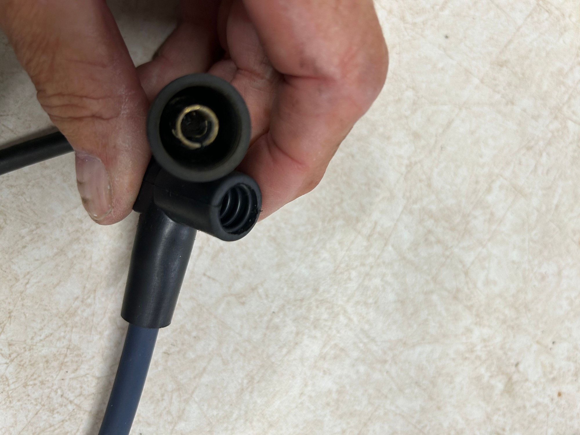

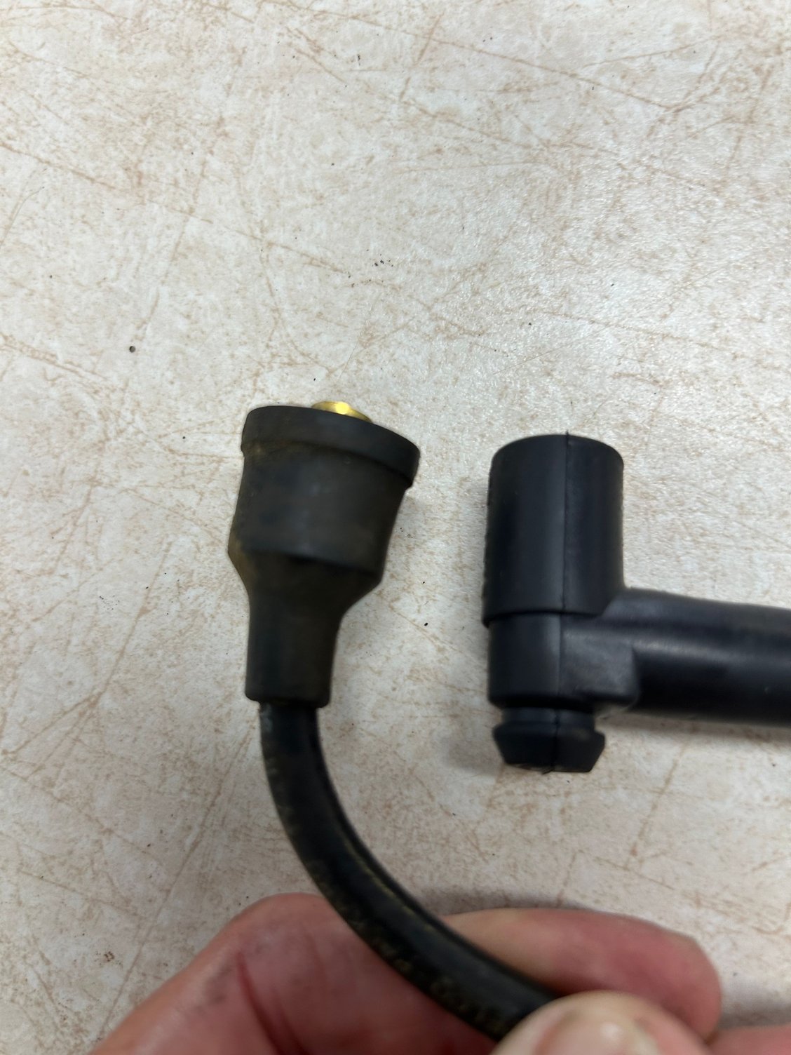

Found a good quality reasonably priced NAPA set that’s supposed to fit a 66 Olds V8 but the boots won’t fit on the distributor cap. Looks like all of these generic aftermarket boots are all 90 degree boots too small to fit. Assuming that I have the stock distributor, is there something available, preferably 8mm that will fit? Or do I need to change the distributor cap?
Old Jul 28, 2025 | 06:05 PM
Posts: 15,394
The boot on the right in the top picture is an HEI wire. They are not interchangeable with points wires.
Old Jul 28, 2025 | 10:12 PM
Posts: 16,688
^^^THIS! HEI's are a snap fit, points terminals are secured by the boot. If NAPA sold you HEI wires claiming they'd fit a factory-equipped '66 Olds, they need to be taken to school. HEI wasn't available until 1975.

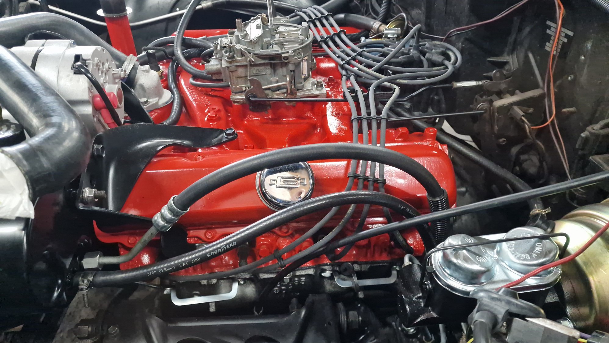

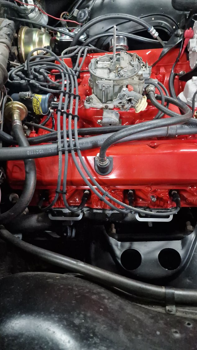

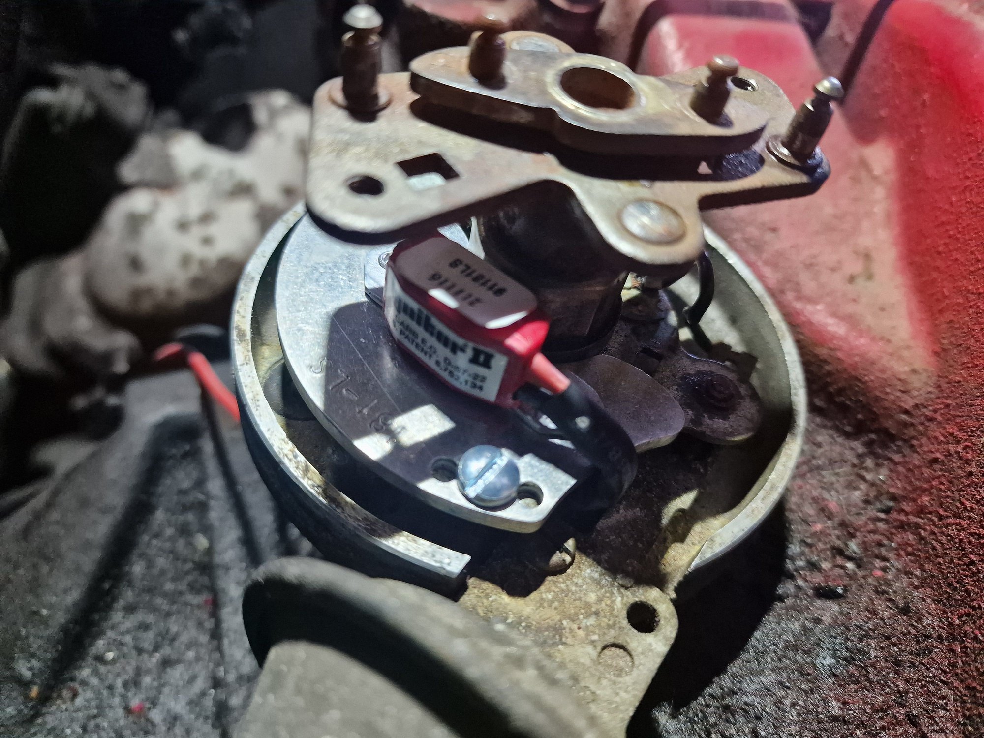

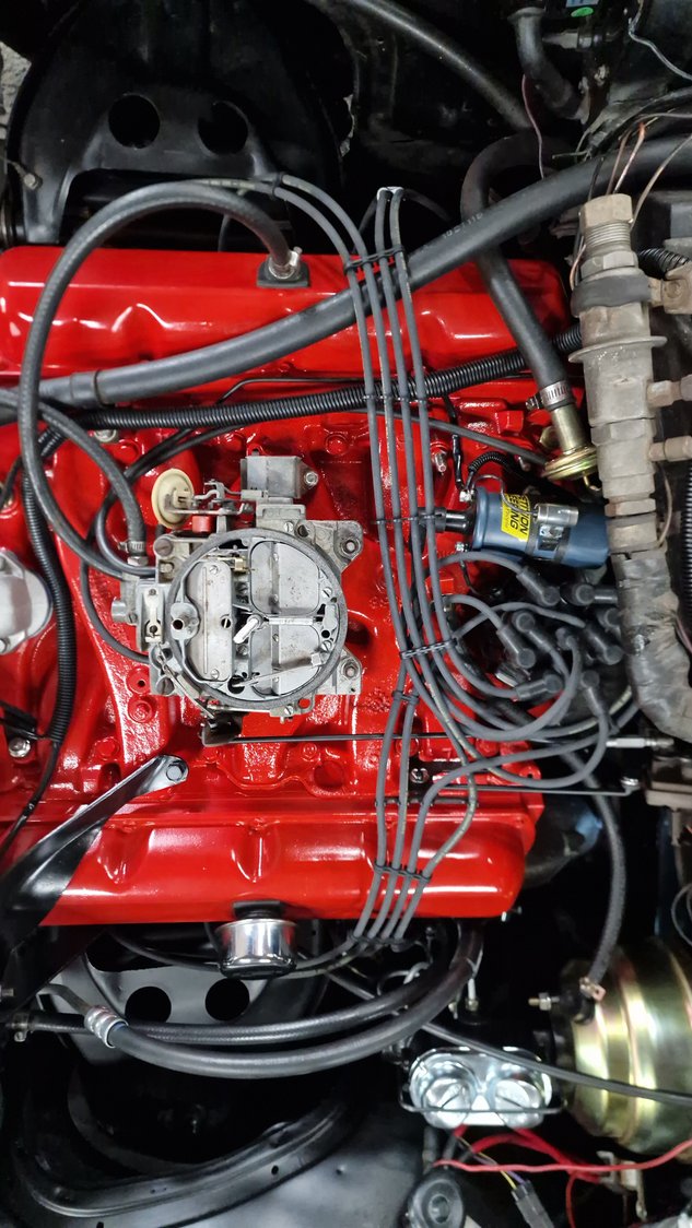

Completely agree. I removed aftermarket 8mm wires including valve cover brackets, and installed a set of new spark plug wires on my rebuilt 425 engine in my 1966 Starfire (also equipped with a Pertronix module in the stock small distributor). After almost having overthought it, I came back to the conclusion that 7mm wires were good for decades and still should be. You just want to make sure to use suppressive wires ones to not damage the Pertronix module.
I bought my spark plug wire set at Rock Auto and selected this one: https://www.rockauto.com/de/moreinfo...pt=7224&jsn=13. I'm very happy with their functionality so far, just maybe a bit early to say much since I have now only 700mls on them.
Routing was a bit of try and error due to different wire lengths, but finally the fit was quite good. Also regarding routing, I recommend from personal negative experience to NOT use "universal"clips for 7 & 8mm since they are loose and tend to slip over time. Instead, I bought some nice 7mm specific ones (from a vintage car shop in Germany, link for info following, they have clips for two, three or four wires: https://www.oldtimerbedarf.de/4-fach-Abstandshalter-7-mm-Zuendkabel) and I'm very happy with this solution.
CU, Steffen

Very nice cleanup. I think I need to get more wire separators. You did a really nice job organizing the wires coming off the distributor.
