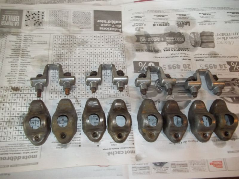

Posts: 42,475
If your rockers look like this, they are non adjustable and just need to torque them down. If they don't, they need to be adjusted similar to a Chevy.

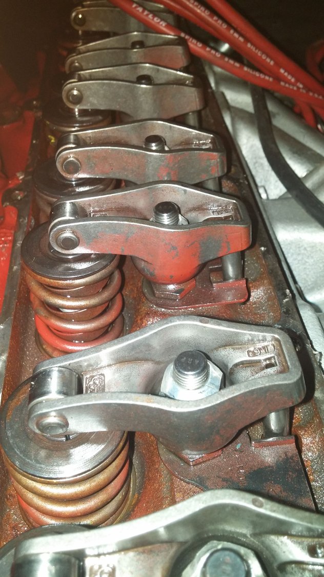

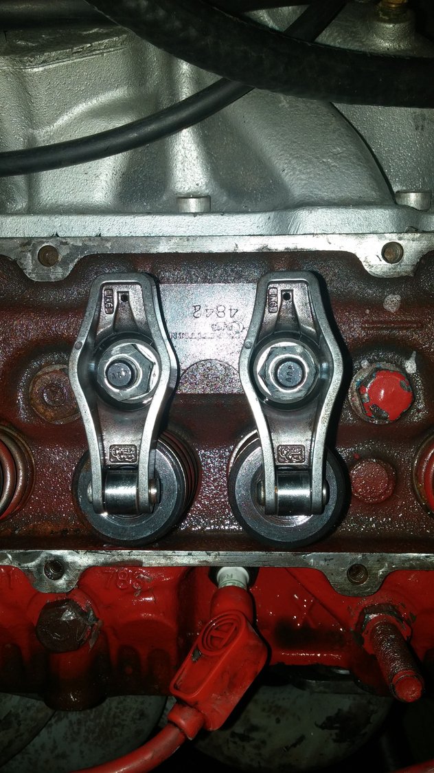

Old Oct 2, 2016 | 05:43 PM
Posts: 42,475
Have you checked to make sure your pushrod length is correct and your rollers are riding correctly on the valve stem?

As Steve said you have stamped steel roller rockers and crimp style lock nuts. Not a bad setup. The reason I asked about the pushrod length is because I see a lot of threads sticking out of the nuts and it looks like a few of your rollers are not centered on your valve stem from the pictures.
