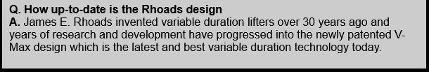

Here's a good FYI on Rhoads lifters
https://rhoadslifters.com/Pages/FAQs.html
They should update their FAQ, since Rhodes lifters have been around since at least the 1980s...
I see where he was done "inventing" in 1974. I remember all the ballyhoo introduction in car magazines which must have been in the 1960's. Back then, you had three cam choices......Stock, 3/4 Race, and Full race.
James E. Rhoads1913-1974
My Father, James E. Rhoads supported his wife and five sons by laying and finishing hardwood floors. He was, however, an inventor at heart with a strong interest in improving the performance of automotive engines.Dad set his mind to work and developed what has proven to be one of the most advanced performance products on the market...The Rhoads Variable Duration Lifter. It's been years now since my father went to be with his Father in heaven and Dad, if you can hear me you've got a lot of satisfied customers who would gladly tell you just how great your lifters truly are. ---Jack Rhoads
