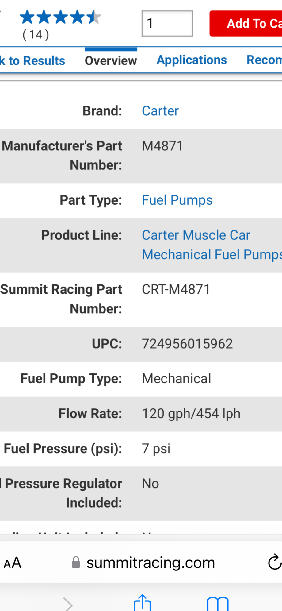

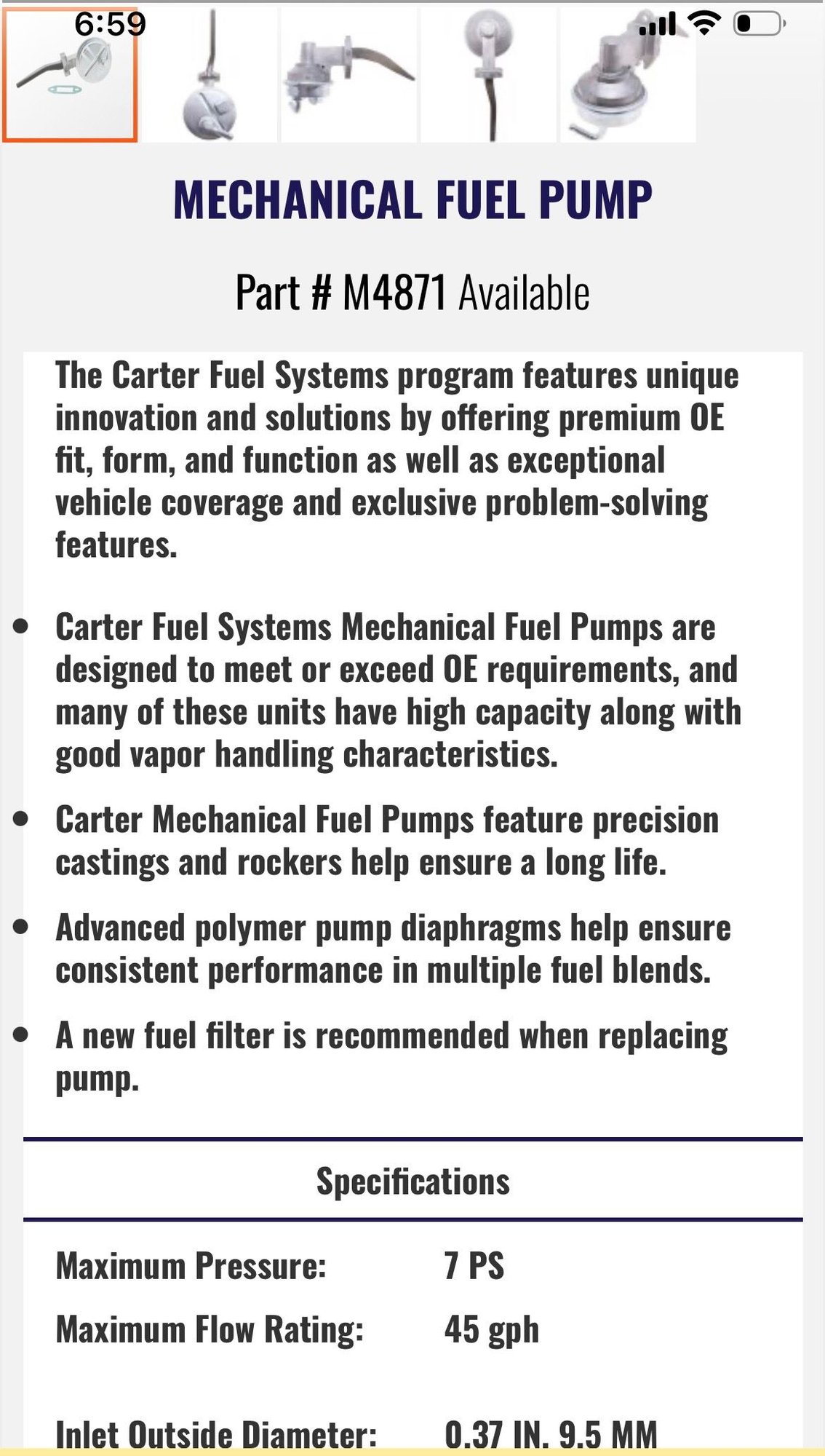

So I have a fuel starvation problem at full throttle. I was going to replace the fuel pump with a higher GPH, but the replacement pump with a higher GPH has the exact part number as the one I have. I’ve checked fuel lines pick up. everything is clear, switched carbs, still having fuel starvation problems. Other than an electric pump, what are my options. Summit racing has the Carter 4871 rated at 120 GPH. The unit I have on my vehicle, is rated at 45 GPH. With the exact same part number. Any idea why it would be this way? Any and all help is appreciated. Thank you.
