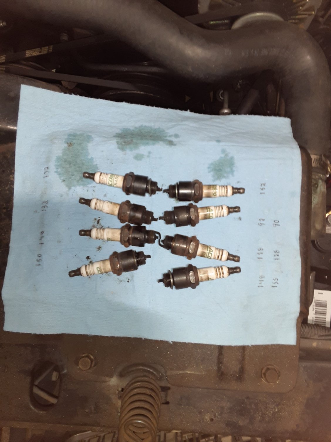

Definitely a PITA. Thanks for the kind words Norm. I forgot to post the pic of the spark plugs. Here it is:
No steam cleaning on any of the spark plugs, but I attribute that to the fact that the engine has only run less than 5 minutes since the radiator exploded.

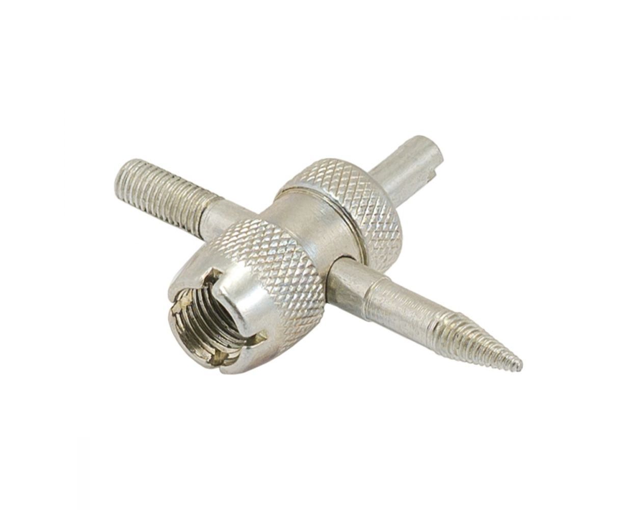

The cross threaded schraeder valve might be repaired with one of these 4 way valve core tools that should be available at your favorite auto parts store.
Good idea, I'll have to get one of those. Thanks for reminding me.

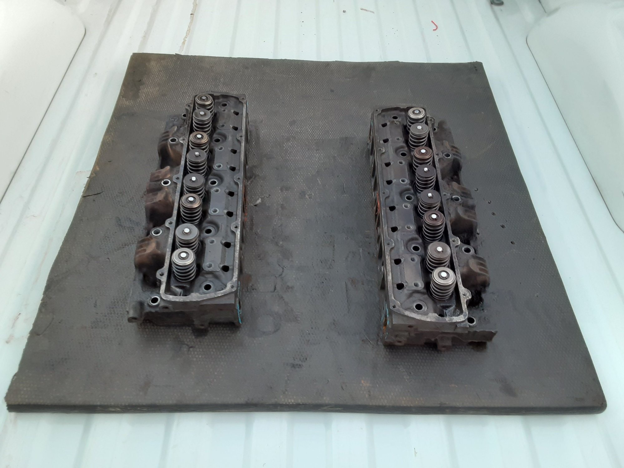

BTW, here's a pic of the heads in the back of my truck. I'll go ahead and drop them at a machinist today. I decided to tear down the engine yesterday. No steam cleaning in any of the cylinders.

I actually heard from the machinist today. He magnafluxed the heads and they're good cores. He said it would be over $1000 for the works. Including new valve seats, springs, guides, etc. He mentioned there are rotators on the intake valves and none on the exhaust valves. He sounded surprised. I knew Oldsmobile used valve rotators on top of the springs in the day.
I mentioned to him that $1000+ was too much. Especially considering that I'm not going to do anything to the short block and it has 90k+ miles. He revised his quote and said he could do it for $420 with new guides and cutting the valve face and seat without new seat inserts. I agreed and he says he should have it done before the holiday.
