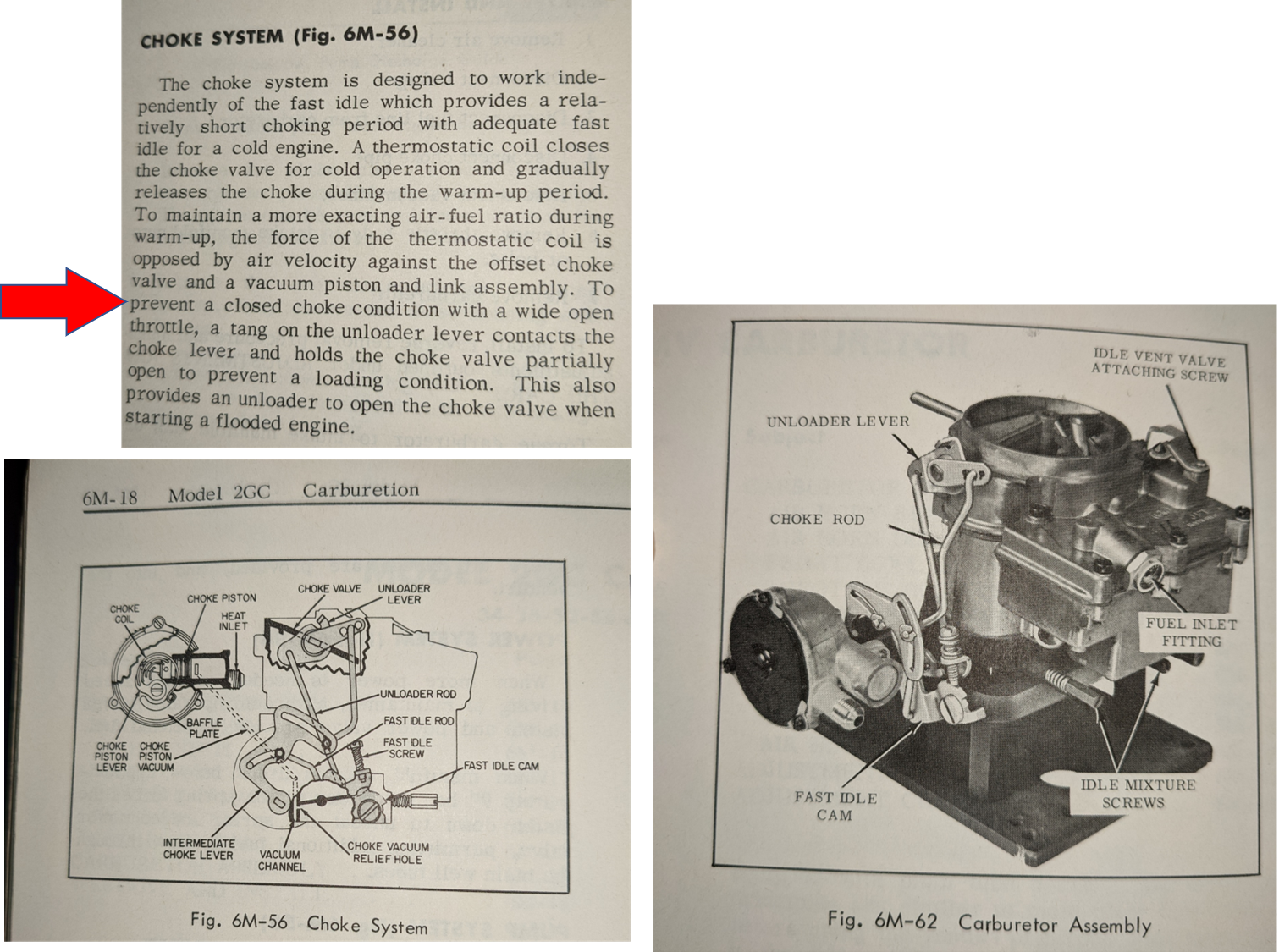

I have Oldsmobile Delta 88 1966 Holiday Coupe original 425cui High Compresion 310HP, the car was stored for the last few years and before the sale was allegedly refurbished the original carburetor Rochester 2 JET 2bll I do not know, but whether it was properly assembled.
The cold engine has a low speed when activating the automatic choke .. I noticed on the carburetor one difference on the control side of the rods from the choke (see photo carb01 is the current carburetor and photo carb02 is the same on another same car)
What is the little stop for ?
This has an effect on the function of the choke resp. damper control ?
Is the upper flap fully closed or slightly open when the choke is activated ?
Thanks for your tips.
Lucas
Old Apr 5, 2022 | 05:46 AM
Posts: 50,770
As I frequently write, this is yet another example of why you should get a factory Chassis Service Manual if you plan to do any work on your car. From the 1966 book:
The carb in the second photo you posted is correct for your car. The carb in your first photo is a frankencarb, assembled from parts that may or may not be correct, which is unfortunately what you typically get from rebuilders. It always pays to rebuild the original carb, not replace it with a one-size-fits-none rebuilt unit.
Old Apr 5, 2022 | 06:27 AM
LuckyLuke's Avatar
Joined: Feb 2010
Posts: 122
From: Czech Republic, Europe
Joe
thanks, I have a second carburetor that you write is correct, and I also have a carburetor kit from Fusick Automotive (code 1140) for it, so I'll probably go overhaul for the first time (I've never done it). The original factory manual Oldsmobile 1966 blue, thick, greasy I have a huge amount of information there, but I'm not a motorist :-(

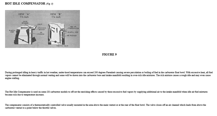

Another question is the differences in Rochester 2 JET carburetors in cars without A / C and equipped with factory A / C? At first glance, they look identical and the markings on the carburetor body are the same.
Old Apr 5, 2022 | 06:59 AM
Posts: 50,770
They are not the same. Non-A/C with automatic is carb no. 7026052. With A/C and automatic is 7026053. These numbers are stamped on a triangular tag that is held under one of the air horn screws. The tags unfortunately got lost over the years. There are two differences, one is that the A/C carb uses a different power piston. The other is that the A/C carb uses a hot idle compensator. A/C cars were expected to have higher underhood temperatures, and this would help smooth the idle under those conditions. The hot idle compensator on a 2GC looks like this:
Old Apr 5, 2022 | 07:16 AM
LuckyLuke's Avatar
Joined: Feb 2010
Posts: 122
Thanks for the valuable information .. the FUSICK overhaul kit for Rochester 2 JET 2BLL carburetors will be perhaps the same for both types (with A / C and without A / C), FUSICK does not divide them in its catalog. I will reconstruct what is in the car with A / C and replace the UNLOADER LEVER (I think who refurbished this carburetor mounted it incorrectly the other way around - with a stop on the other side)
