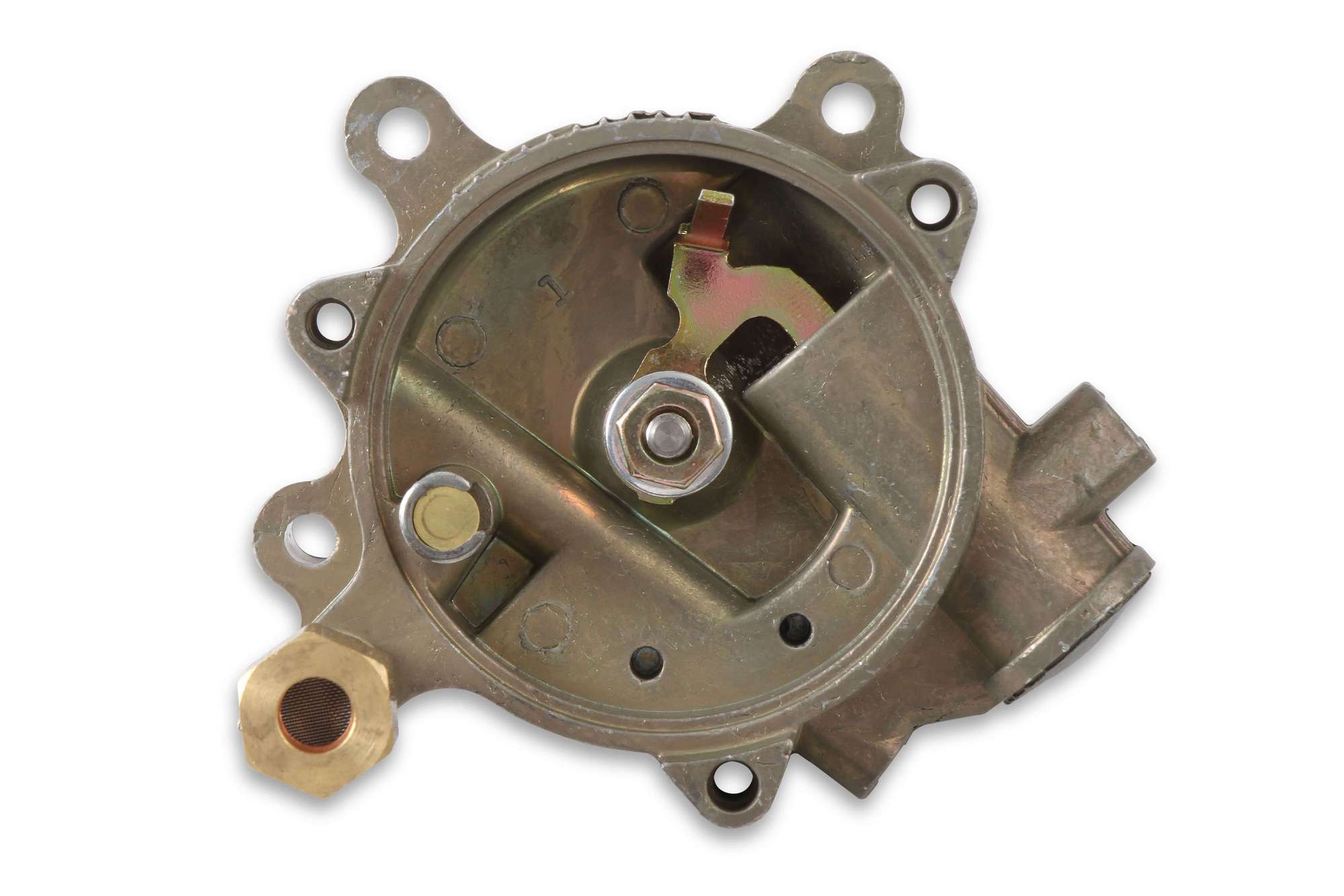

I attached a picture of your carburetor with a labeled parts layout in Post 12. In Post 25 I included a picture the choke housing with the pull off piston. If you remove the black plastic choke thermostat cover you find the pull off piston.
Before any parts are removed or replaced I suggest that any settings/adjustments that may have been changed be restored back to their original positions and the choke pull off fresh screen be checked for restrictions as I outlined in Post 25. If that looks ok perform the diagnosis that I suggested in the last paragraph of Post 23 to verify that we are going in the right direction of repair or replacement of the choke pull off.
If that is too much you can always roll dice on replacing the entire choke control assembly for $77. I included the link to the Holley parts web site in post 25. Myself I prefer to make a diagnostic check rather throw parts at a vehicle. The rest is up to you.

Old Apr 6, 2022 | 11:10 AM
Dynoking's Avatar
Joined: Jul 2019
Posts: 362
Here is a picture of the choke housing crudely labeled by me.
I Choke housing assembly with the thermostatic black cover removed.
II START HERE FIRST The screen I suggest you remove and carefully clean with parts clear or full strength Pine Sol (wear gloves!)
III Remove this nut to access the choke fresh air screen.
IIII The choke pull off piston linkage. Check here for binding of the pull off piston. It should move freely.
IIIII The pull off piston bore. The pull off piston is inside.
