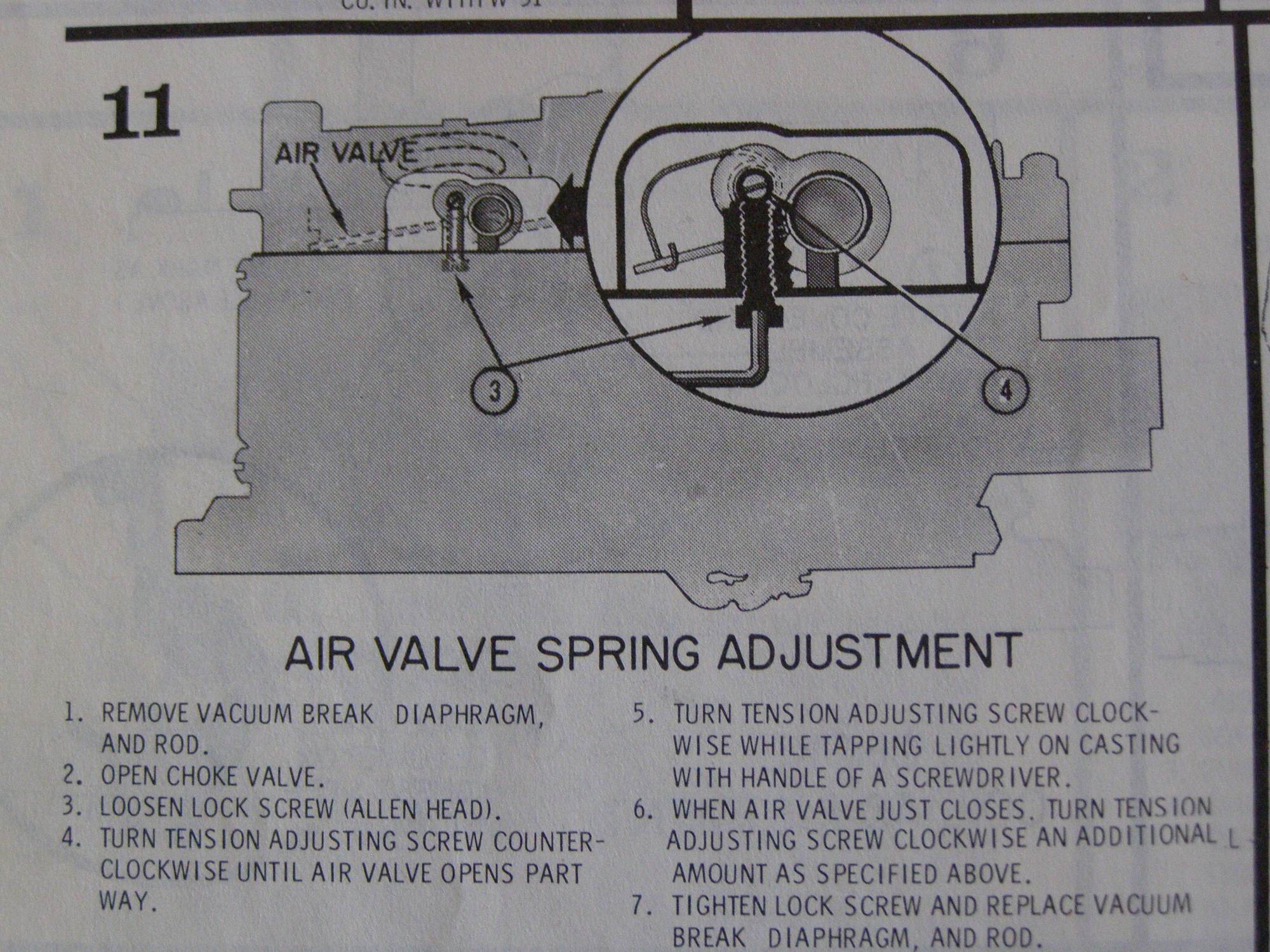

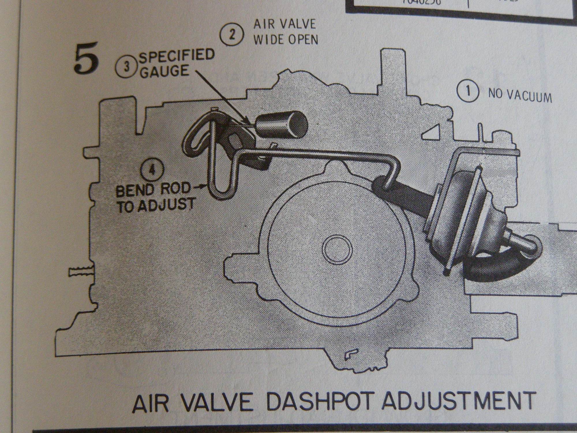

I checked the vacuum break dashpot & found that it leaks. I got a new one. I adjusted the dashpot as shown in the repair manual. before changing the dashpot, I had been adjusting the
air valve spring to no avail. I set the air valve spring to 3/4 turns after the flaps just closes (like what it says in the manual). Again, no real change. My question is do I just keep making
the air valve spring tighter till it slows the flap opening? or is something else wrong. I'm sure this has been addressed before but my search didn't answer my question.
