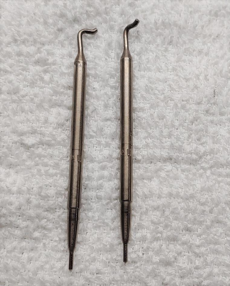

In the past week I have taken apart two different 7040252 Carburetors. Here's what I found.
Carb 1 is an new re-manufactured 7040252 carb that appeared to have been sitting on the shelf at an auto parts store for a very long time. I found that it has 7040701 "52C" Primary Rods and 7033655 "AU" Secondary Rods.
Carb 2 is a used 7040252 carb that I purchased from a fellow ClassicOldmobile member. It has been rebuilt at some point in its life , because the plugs on the underside of the body have been epoxied. It also has the 7040701 "52C" Primary Rods and 7033655 "AU" Secondary Rods.
FWIW, both of these carbs match the information on the Olds FAQ Chart, not the Dealer Tech Guild Chart
Old Jan 17, 2020 | 02:57 PM
Ugh. So to summarize, the list from the FAQ matches the Rochester manual, which matches two actual '252 carbs, both of which have been open before (though admittedly it's unlikely that someone swapped those rods during a rebuild).
The Dealer Service Bulletin matches the Olds Parts book.
Gotta love it.

I got good parts though. The 52C Triple taper W-30 AT Primary Rods. I'm building a backup for my 7040258.
