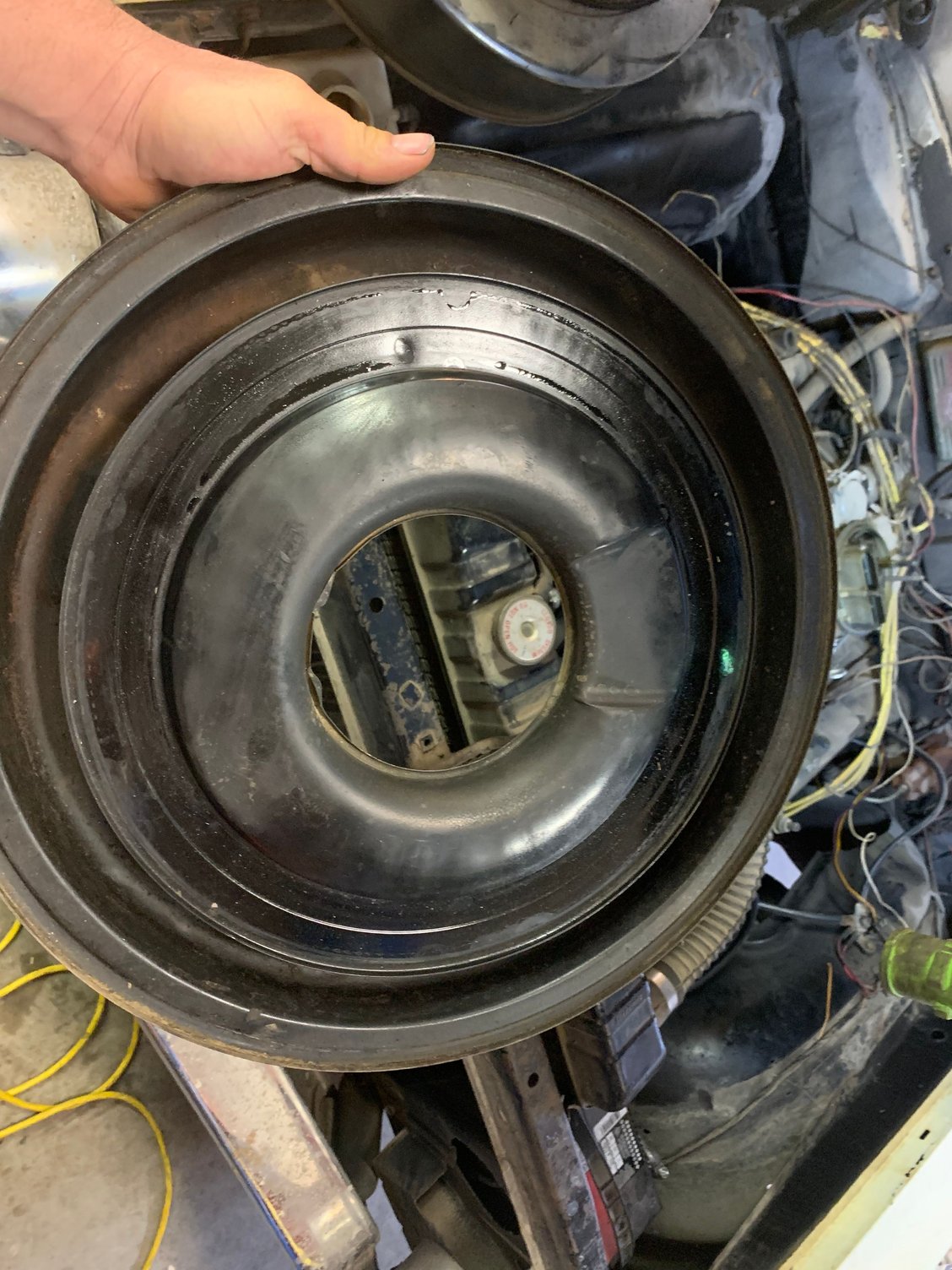

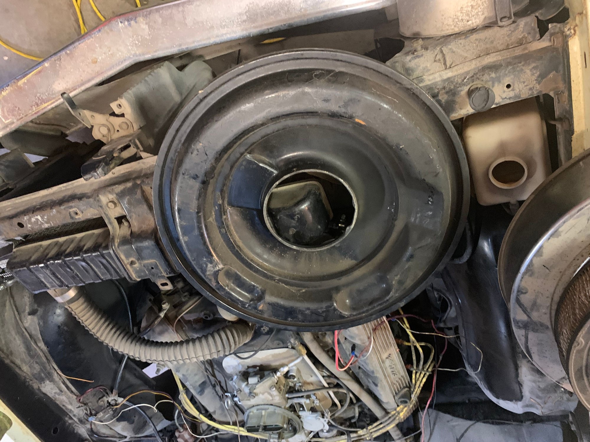

I have no idea what the previous own used. I can’t see any markings on the base bottom to help pin point what it is. All I know is I need two more lol
this is on a Holly carb

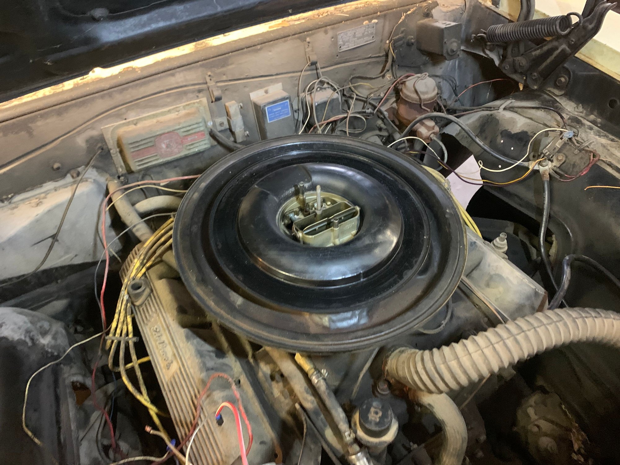

The '65 442 came with a q-jet late in the year. Bro 442 website has this info, my '65 was built in August and had q-jet on it.

do you have the base for that bad boy ?

Yes sir!
