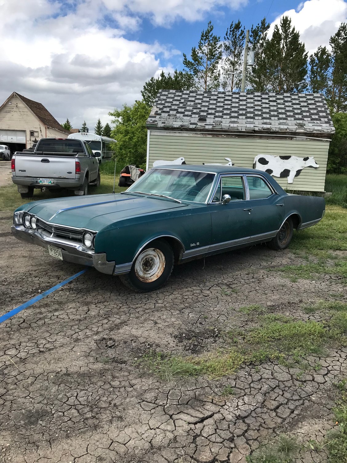

Hey folks,
Looking for headers for a 1966 Delta 88 with a 425. Anyone had any luck finding some with minimal persuasion? TIA
