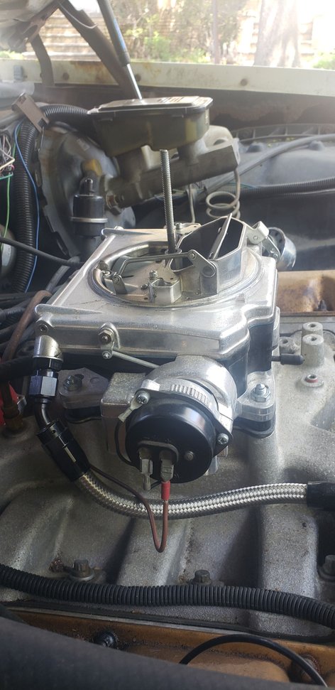

Well the good news is that you can do a Holley SNIPER 4150 unit and a new EFI tank with internal pump for less than $2K. It's very affordable and the results are amazing.

Installing EFI on a vehicle hoping to correct an existing problem is where many EFI installations go wrong. I suggest we work through your issues and get the vehicle to run as it should. Then you can consider an EFI installation.

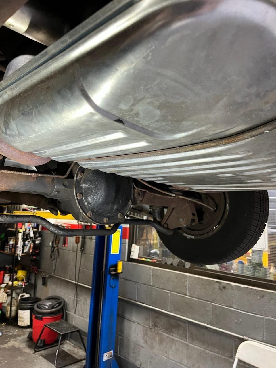

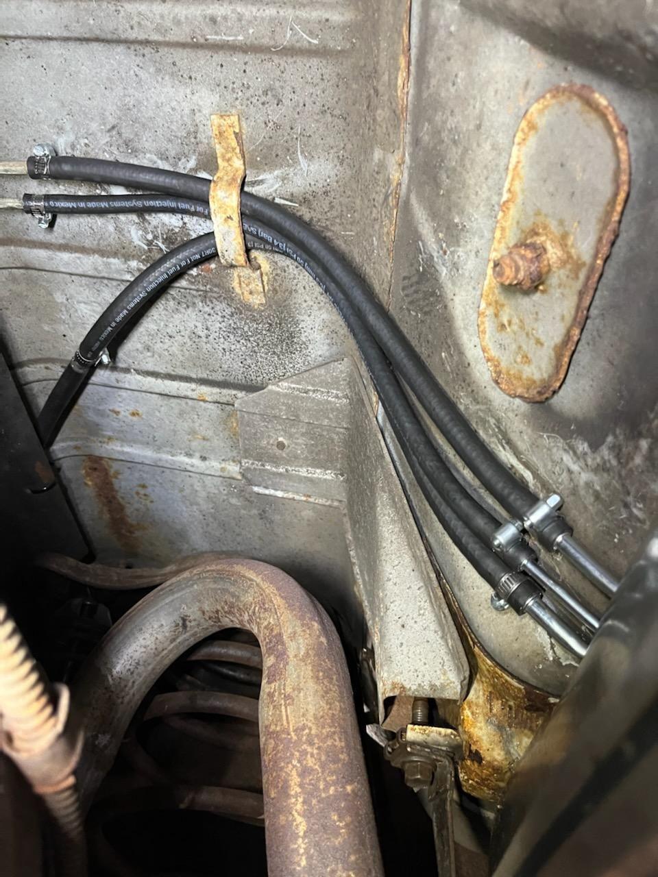

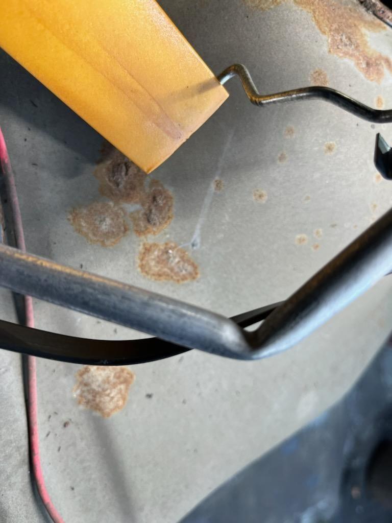

Mechanic dropped the dented tank and found a bent fuel line and collapsed sock. I was wrong, it was 35 year old parts failing.

New fuel lines, new sender, new tank.
This thing starts better than it ever did since the swap. The acceleration is night and day difference; what this car could do at 1/4 throttle is now happening at 1/8th throttle. FYI, the old 307 had 130 hp, I've driven a CRV with 130, a Crosstrek with 140, and Ford Econoline vans; I dont know what 515 HP and 550 TQ is supposed to feel like. I actually thought the switch from 1650 to 2000 stall converter was a factor in its low acceleration initially. Starving an engine of fuel certainly will do that.

Question about EFI Fuel systems. More and more I am thinking of making the plunge to multiport EFI before summer. I know in-tank pumps are the preferred method for EFI with a blockoff plate for the mechanical fuel pump. Inline pumps I wouldn't consider. However, one method that exists that I do not see a lot of info / reviews on are the "surge tank" method. This is where the original mechanical fuel pump feeds fuel to the small tank, and then the tank sends the fuel at much higher psi into the fuel injection system. Is it more of a gimmick than a viable solution?

They are a possible option, but if you have the ability to properly install an in-tank pump, that would be the preferred method. You'll need to run high pressure EFI fuel line the whole length of the vehicle.
An in-tank pump is a no brainer if your vehicle has an aftermarket EFI ready tank/pump combo available. If you have a less common car without an EFI ready tank available, or oddly shaped tank which makes it difficult/impossible to retrofit an in-tank pump, then the surge tank begins to make more sense.
I know a lot of people swap 91-96 plastic B-body tanks in the 80s wagons when they do LS swaps. I hate to do that after just replacing my metal tank with a new one, and I do not even think the 91-96 plastic fuel tanks are made aftermarket. Some modify the existing tank with a Walbro 255, but end of the day the tank would have to get dropped. I feel like I am in the "less common car" section already with the Oldsmobile powered Buick wagon and considered the surge tanks because they seem more abundant now than they did years ago.

Think I found out why my car doesn't start easily and turns off hard. My choke is wide open, and what I didn't capture on the first key turn is that it was partially open. I assumed you press the pedal down which would lock the choke closed, but it seems to progressively open more and more. I assumed after the last mechanic trip it was fixed since it would have problems starting but also ran extremely rich. Its a Street Demon 750, btw. Anyone have this experience before with this specific carb? I feel like I can fix this myself vs sending it out again.

The electric choke is adjustable. Do you have fuel in the carb at cold start? It sounds like the bowls may be empty.

Was the car cold before you started it? What was the outside temperature? Did you press the gas pedal to the floor once before starting it (this sets the choke closed)?
Take a photo of the choke side of your carb and post it here.
As for the not shutting off cleanly. What is your idle speed before you turn it off? Preferably measured with a dwell tachometer (in car factory tachs are notoriously inaccurate).

Okay. Take #2 with better angles. The temperature was the same, 55 degrees. Also a week between start and drive, like the last start up. I noticed the choke did close initially. I did through a jumper on the battery for the last dragged out start. Also watch your ears from the starter.

I am sure that others here can answer you better, but after watching your video, I have a couple of questions and suggestions.
Questions:
1) Are you sure that your timing is good? It sounded like it was trying to backfire through the carb a couple of times.
2) Are you getting consistent spark?
As far as suggestions are concerned:
1) That choke looks REALLY closed in the latest video. It might be too closed. If that video was taken at 55F, I would expect it to be more open than that. You might want to check your adjustment.
2) I heard you pumping the gas pedal a few times when you struggled to get the engine started. I always pump twice before my first attempt, one to set the choke and the second to give it a little more gas. If it has been sitting too long (way more than a week), I might do this a second time, but never much more. Another thing to try would be to hold the gas pedal to the floor after your second or third attempt. If this works, you probably flooded the engine or the choke is too closed.
