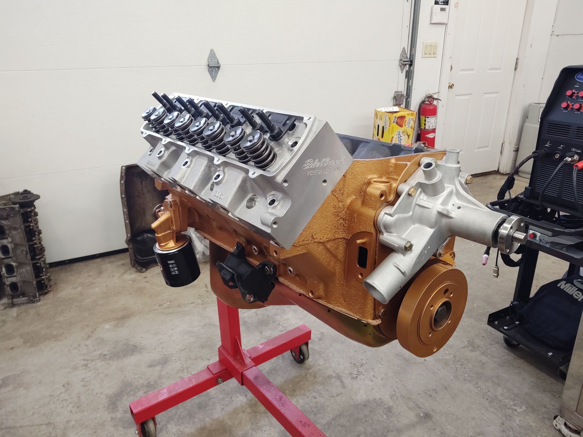

steel-and-fire's Avatar
Joined: Mar 2015
Posts: 71
From: New York, NY

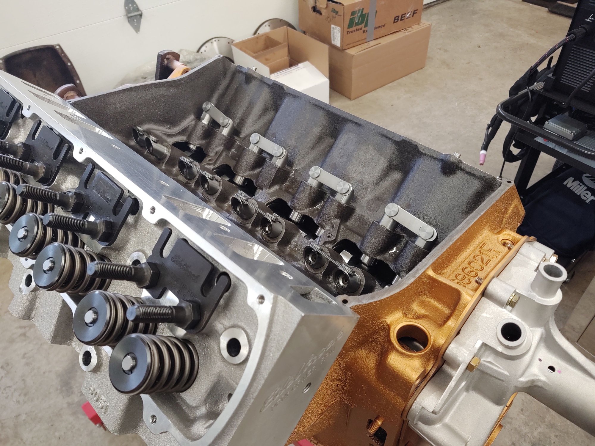

More engine goodness
Old Feb 5, 2020 | 05:40 AM
  #42
olds 307 and 403's Avatar
Out of Line, Everytime😉
Posts: 10,082
From: Melville, Saskatchewan
Very nice! All the specs please.

Get rid of those manifolds. They will ruin the engine.
Old Feb 25, 2020 | 12:48 PM
  #46
Joined: Mar 2015
Posts: 71
From: New York, NY

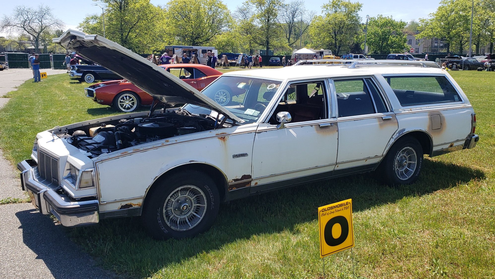

It is going into a 89 Buick Electra Estate; I'm already ruining that engine. Haha.

Old Feb 25, 2020 | 01:52 PM
  #47
cutlassefi's Avatar
Posts: 8,477
From: Central Fl
Originally Posted by steel-and-fire
And good headers are 500 to 800, so $300 manifolds will work until funds allow for better.
Sorry but I don’t understand the logic here. Your sacrificing at least 30 numbers on hp and tq and already plan on buying your exhaust twice. Save your money and just make one purchase, the correct header.
Just my opinion.
Just my opinion.
I had been going back and forth on it for a couple days. Was looking at Doug's or Hooker brand ceramic coated headers, but then there are always the complaints about header gasket maintenance and sticking to exhaust manifolds for just a street driver. I'll admit I took the cheap and 'ease for installation' option. I looked at it as I could have had just headers, instead I ended up with manifolds, carb, and distributor.
And I know I'm going to have to redo the whole exhaust again. Being a young kid and not knowing anything, the exhaust shop cut the rubber hangers and welded the exhaust hangers to the frame and pipes. Plus the left dual was smashed with a hammer to fit under the transmission crossmember. I've learned so many lessons about finding shops I can trust. And now I have a dual trans cross member from G Force Performance Parts that fixes that issue for the future.
Will get dynoed soon, but it'll be better than anything the 307 is producing right now.

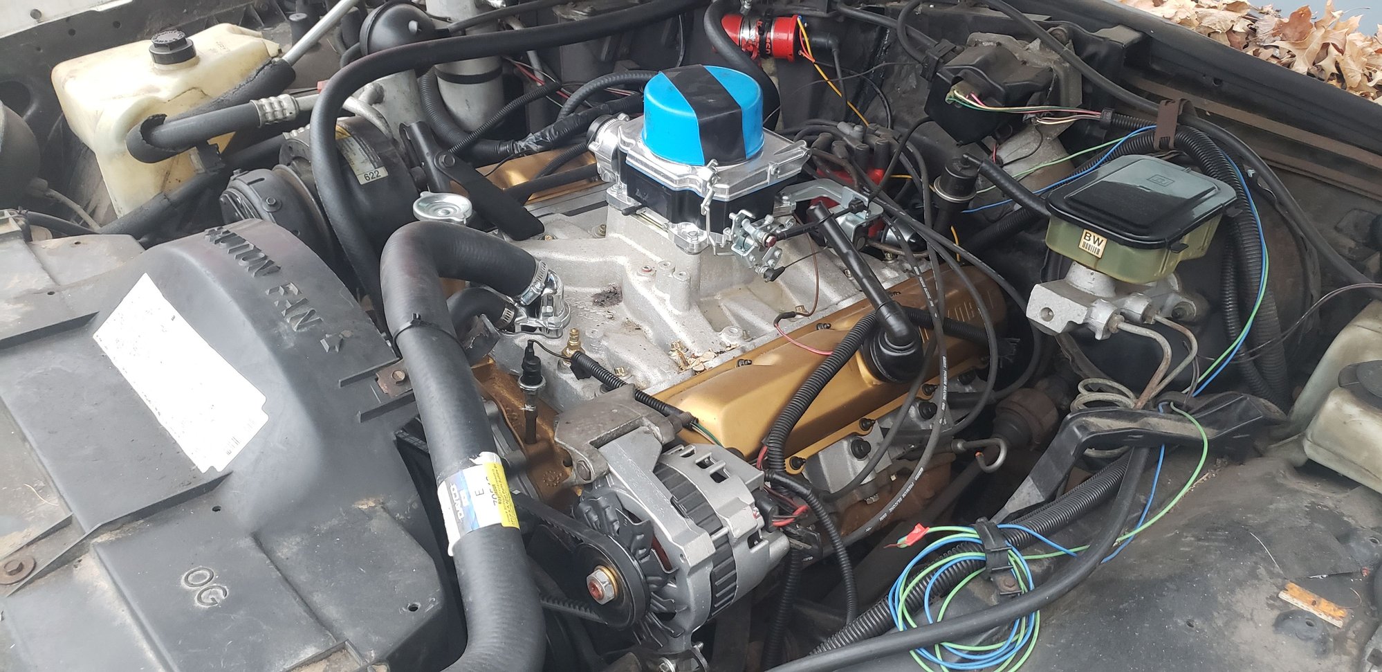

Still more to do, exhaust not hooked up, but finally got to hear my engine talk for the first time.
Old Dec 17, 2021 | 10:07 PM
  #63
Posts: 10,082
Nice to see your long term build come together. Was there any issues with the Street Demon on the Dyno? A member here and a few others have had secondaries run lean. Otherwise nearly everyone loves them. Nice numbers, it won't just haul the kids, it will haul ***.

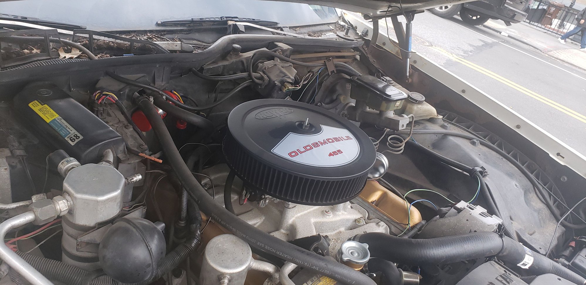

Did the first test drive yesterday. It is amazing how different she behaves with that much power. I was grinning like an idiot for about 10 minutes... then I think I grenaded the transmission...

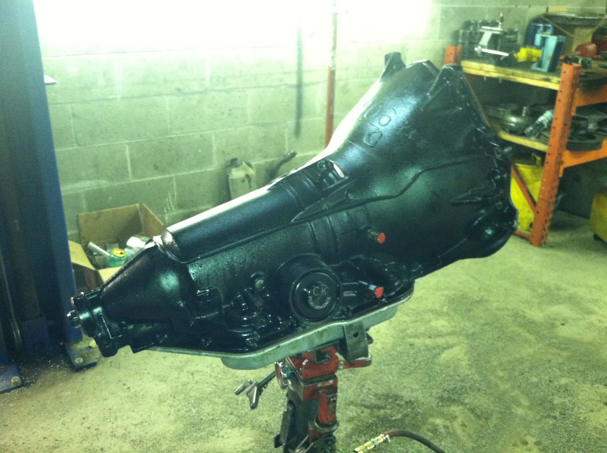

Originally Posted by Mr Nick
Unexpected noise, nervous looks at the dash & gauges... we've all been there!
Break it, fix it more better!

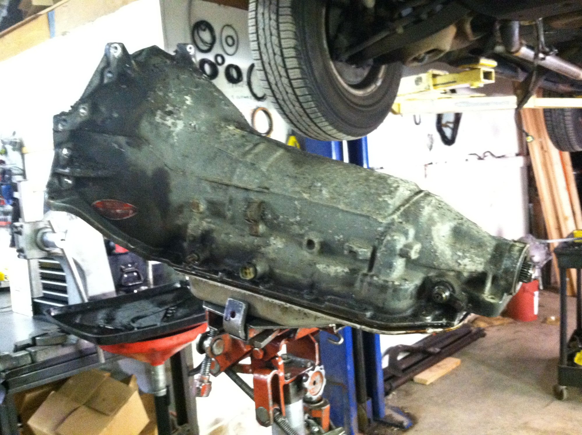

Just learned it was the input shaft that snapped. Turns out it was only going to last up to 475 HP.

That is a real bummer. But we've all been there....
My Extreme Automatics 200-4r trans died (band failure) and I decided to do the rebuild myself. Still waiting to see if it was successful.
There's a group on Facebook - 200-4r Nerds - that's excellent.
Switching to a billet input is pretty straightforward, and if the was minimal carnage then that may be all you need (and re-checking front endplay). Note that CK's input shaft and billet overdrive carrier use non-standard splines and only work with each other. Better to get a billet input from Art Carr (California Performance Transmission) and a billet carrier from, well, wherever you can. Lonnie does quick turn-arounds, but his first one he sent to me had TH325 planets in it (!!!!!). I went ahead and rebuilt the one he eventually sent because he re-used an old bearing and the needles were a bit crusty.
Basically can't trust jack **** - read up, check and recheck on your own.
The easy button would be sending the unit to Janis or Husek to repair. I'm deeply grateful for what CK has done for this transmission and his book, but his shop is just way too backed up and communication is too difficult. He might give you the run around on any warranty or helping out with the repair.
I'm pretty surprised the input shaft broke. It does sound like it based on what happened, but seems odd assuming the trans did downshift and the lockup released (if it was engaged). My 403 put out ~450ftlb and I romped on it a lot for the two years before the band burned up. No wear on any hard parts, just the band, direct and forward clutches.

mine was a stage 2. I talked to a couple of builders that didn't like Lonnie's servo design with the double ring seals. I think its interesting that Lonnie isn't listing his servo on his site anymore - now he advertises the sonnax servo. If the servo doesn't have enough holding pressure then the band slips and things go bad fast. I wasn't thrilled with the direct clutch setup so I got one of Husek's pressure plates and did a 6 clutch stack.
so my failure wasn't stage 2 vs stage 3 based. I went ahead and added billet input shaft, overdrive carrier and overdrive ring since my new engine build is over 500ftlbs.

Funny enough, I am getting parts from Extreme Automatics to fix it. CK doesn't have an input shaft, nor does the transmission shop, so I am certain I'll be in good hands; Extreme Automatics looks like they have severely hardened parts for the 2004r.

It was an older CK performance transmission. The Jasper 2004r (so it already had another transmission before I got it) I had swapped out in 2013. For those years it lived behind the stock 307 with a 3.42 rear end and TracRite helical diff. The gearbox limit was 500 HP but I always assumed my engine build would be 400HP, so there would be plenty of room. With 515 HP and 556 TQ attached nine years later, it was a bit beyond what that transmission could handle. TQ converter was a standard 1650 but it is getting upgraded to 2000, and the lockup is getting installed for 4th gear only since there is no more computer. Tires are 235 70 r15. When I visit the shop I hope to be taking the snapped shaft home as a memento.
Older pictures from 2013 transmission shop.

Second test drive with the Olds 455 swapped wagon a week or two ago. Good news, bad news, worst news.
Good news: 2004r. The rebuilt transmission ran well the entire drive home. Still needs the lockup torque converter solenoid installed for fourth gear, but handled 1/4, 1/3, and 1/2 throttle with ease. Didn't mash it or let it downshift.
Bad News: Cooling. On the highway, it stayed at 150 all day long as long as I was above 25mph. Slow 25 mph traffic was 180. Standstill or red lights, it creeped up to 210 and a little beyond so, despite the aluminum radiator, shroud, and clutch fan from the 307, I might need an auxiliary fan for standstill/idling. At very least, the fan clutch, coolant system, thermostat will be checked out. Olds facebook group said the 455 tend to run hot, but I am still going to take precautions.
Worst news: Pulled up to my mechanic. Turned off engine. For the next 60 seconds the engine struggled to try to stay running, shot two shotgun blasts out the tailpipes, and expunged a gust of steam out through the air filter. He thinks the engine is suffering from pre-ignition when turned off. Hopefully the engine isn't toast after 60 miles. I have much more respect for the computer controlled carb on the 307, and EFI in general. Also learned from the Olds facebook group if it happens again, turn it off in Drive while holding brake, then put in Park.
Been a long crawl with this project.
Old Mar 15, 2022 | 05:07 AM
  #75
Dynoking's Avatar
Joined: Jul 2019
Posts: 361
"Turned off engine. For the next 60 seconds the engine struggled to try to stay running, shot two shotgun blasts out the tailpipes, and expunged a gust of steam out through the air filter."
If I understand your description this was known as engine run on or dieseling.
The most common cause is engine idle speed set too high. Be sure to use the factory spec usually 600-650 RPM IN DRIVE. That is assuming you have a stock engine. You may have to experiment with idle speed if you are using a high performance camshaft.
Another cause of engine run on is hot spots in the combustion chamber. This can be caused by carbon build up. To remove excess carbon I used to use GM Top Engine cleaner with excellent results.
High engine temperatures can also cause run on. Correct any cooling system issues that may exist.
Another but less likely cause maybe a spark plug of a higher heat range than specification.
Please keep us posted of you progress.
Old Mar 15, 2022 | 05:41 AM
  #76
Posts: 10,082
First, get a seven blade fan to replace the 5 blade fan and get a new clutch for it. What are the specs on your aluminum rad? Get a high flow 160 or 180 thermostat as well, avoid the Mr Gasket version, a few of us have had issues with them. Yeah, I experienced what you are with my hot running 403, especially towing my boat.
Old Mar 16, 2022 | 07:12 AM
  #77
oddball's Avatar
Joined: Sep 2011
Posts: 2,148
From: Plano, TX
Have you made any upgrades/changes to the alternator and/or ignition? It's quite common to need a diode on the alternator excite wire to prevent run-on. There's not enough power for the ignition system to work well - just enough to stumble for a bit. Also try disconnecting the alternator, fire up engine, turn off. If it turns off right away then that's another clue.
The clutch fan is the best setup - it pulls far more air than any electric fan. As said, get the metal fan and clutch from an earlier car. Make sure the depth into the shroud is correct - the fan should be slightly poking out towards the engine. If the fan is all the way into the shroud - especially past the lip of the shroud - then it's too far in and won't work well. Depth can be a problem due to the various Olds water pump lengths.
