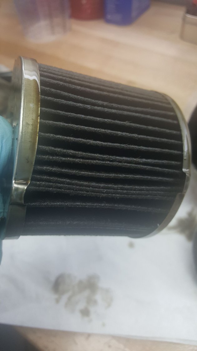

First thing I would do is take the filter off and cut it open. That way you can see if something serious is starting to happen and stop running it right now. If the filter is clean then you can keep trying to figure out the noise.
Assume you mean oil filter. Nothing out of the ordinary inside the filter. Pics are lousy, sorry.
