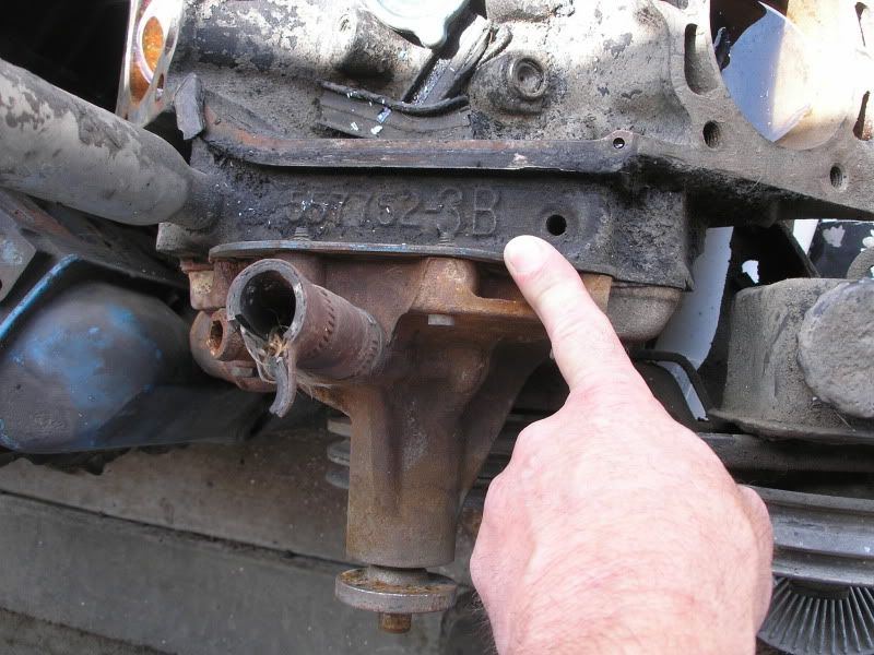

Post a pic of the front shelf next to the oil filler tube.

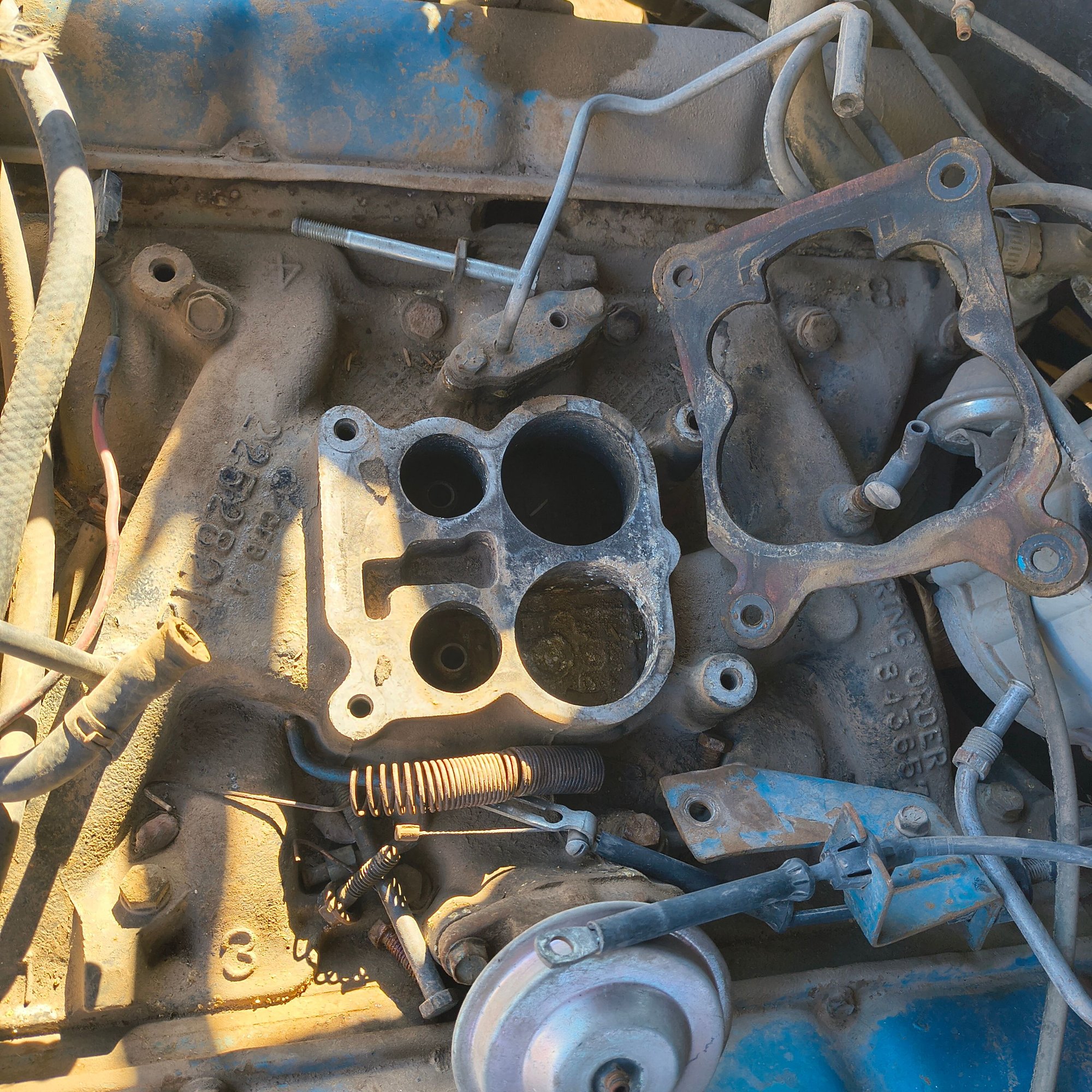

the intake manifold casting number indicates 307
We need more info but it looks like a 307

This is the location for the engine casting number between the oil filler tube and oil pressure sensor hole.

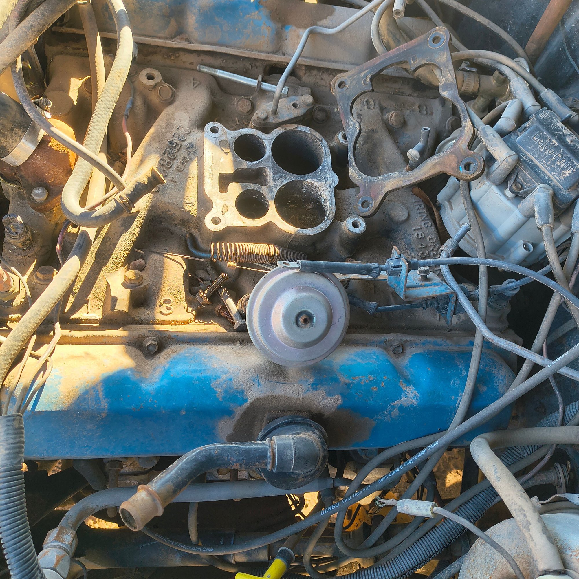

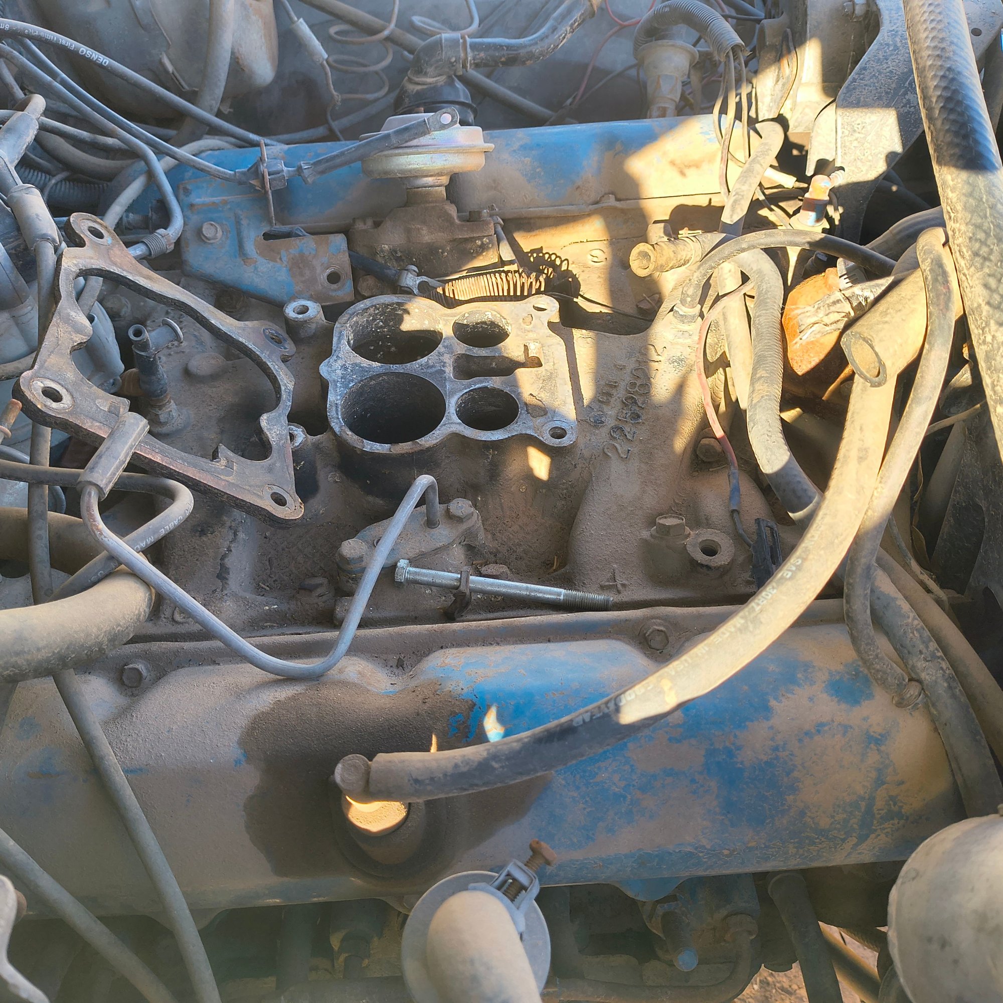

This is my engine. Took off the carb to put on a 75 Chevy shortened. But gonna reinstall after repairs
This is my engine. Took off the carb to put on a 75 Chevy shortened. But gonna reinstall after repairs. I want to know do I have a big block or small block.

When YOU post a pic of the engine block casting number, we can tel you. See post #7 for where to look.

Its definitely a small block. The big block intake manifold is much larger. As Don71 stated your pics show the intake manifold to an Olds 307.

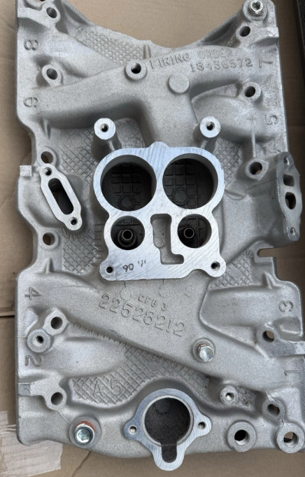

Here is your intake manifold matched with casting #, on bottom of screenshot.
https://www.chicagomusclecarparts.com/products/282122

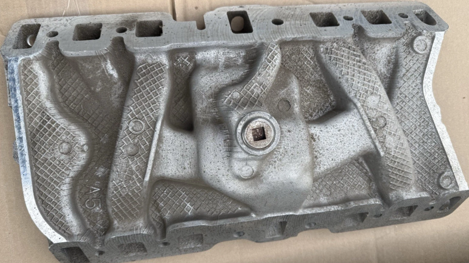

The intake is an A5 peanut port.intake. NOT great for performance, although a little torque plus on the low end. If the engine came with that intake, it's likely a VIN Y 307. 140 HP range.
Note the small ports and "A5".
86 and 87 442 (VIN 9) had 170 HP and used this intake. But the key is it had a thick balancer. Y engine balancers are super thin. You could almost shave with them. So look there. Doesn't mean someone couldn't have changed it, but...if the original carb is there, it's likely a 17086008 (Y engine) or 17086009 (VIN 9 engine). VIN 9 engines used cast iron exhaust manifolds and VIN Y had the stainless log tube exhaust. They used the 307 in later cars like Cadillac and stuff up through 1990 as well. They used the same 2 carb numbers previously mentioned from 86-90. Tow package Caddys and heavy framed cars supposedly got the VIN 9 engines and the others got VIN Y.
If that intake is on a 350 larger port head motor.....OMFG. No. Just...no.
