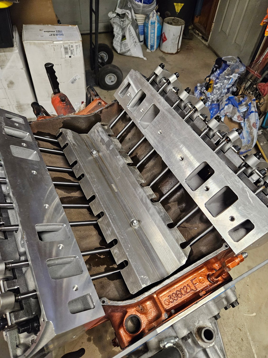

I had ordered one a few years back and thinking of using for a current 400E build. I want to run the stock cam baffle as I want to minimize the splash. I had used an earlier Mondello tray on an older build where it needed studs to mount it at an acceptable height (bends were different than current). Was thinking about doing the same with the current build and keep the factory baffle as it looks like there was some thought behind the design, whereas the "newer" Mondello tray now bolts directly to the block and is a replacement for the factory baffle.
Just wanted to know if it's even worth running. I've read the threads about the turkey tray, but I don't think I'm going to run one as I have Felpro aftermarket print--o-seal type gaskets. The main reason for buying the Modello tray was for heat reduction, but wondering if it actually does that. So I'd rather not use it if it doesn't provide anything useful. I may run a HSD intake(which I have) or considering a Performer RPM which will run cooler anyway due to the "air-gap", but unless someone has one for sale at a reasonable price I can't see spending $650 for that, so back to: What to do with my valley tray?

I have one. Worth it? Probably not. The factory one does a pretty good job of keeping the oil off the bottom of the intake. That said, it is still in the engine, but on studs to clear link bar roller lifters and above a factory unit.
Ya, that's what I was contemplating doing, similar set up. I have Edelbrock's so reading the other's have suggested the crossover being the "heat" issue.
