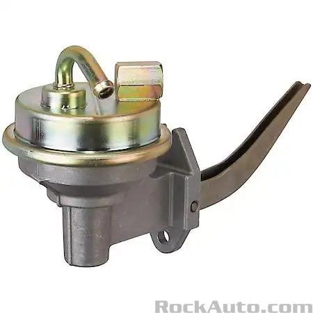

I went to the Rockauto website just now and looked up a fuel pump for a 1968 Delta 88 with a 455, the first year the 455 was available. They show availability of a pump with just a single inlet and the outlet for the carb. $13.

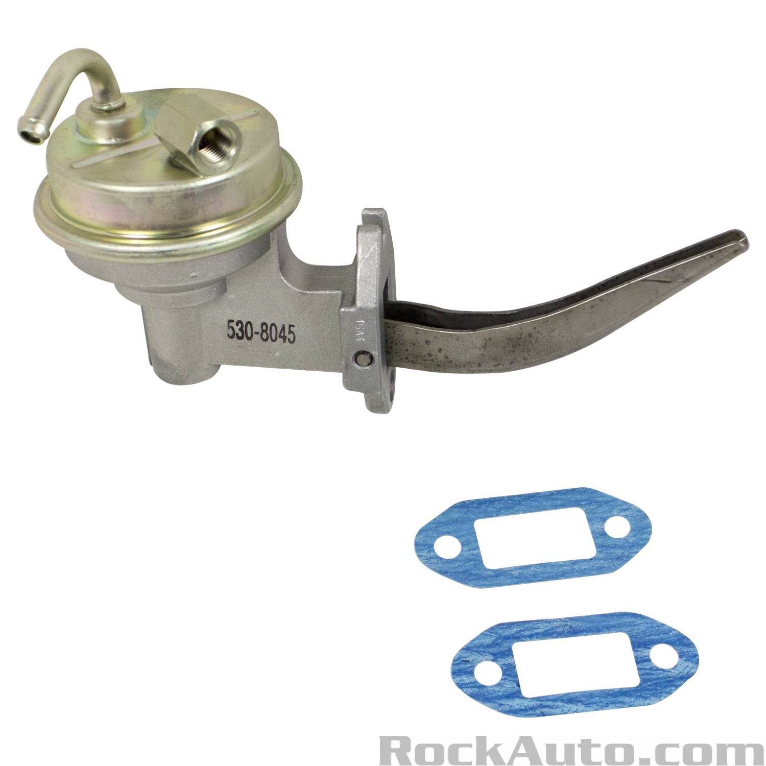

They also show this one. Costs nearly three times a much, and they say only one remaining.

Always noticed these things come with two gaskets. Any thoughts as to why?

Of the photos of pumps at the Rockauto site that show gaskets at all, some show two gaskets and others one. In googling around, I've seen some comments where they say that some pumps need a spacer between the pump body and the engine block. So a gasket is needed for each side of the spacer. I've never seen a fuel pump with a spacer.

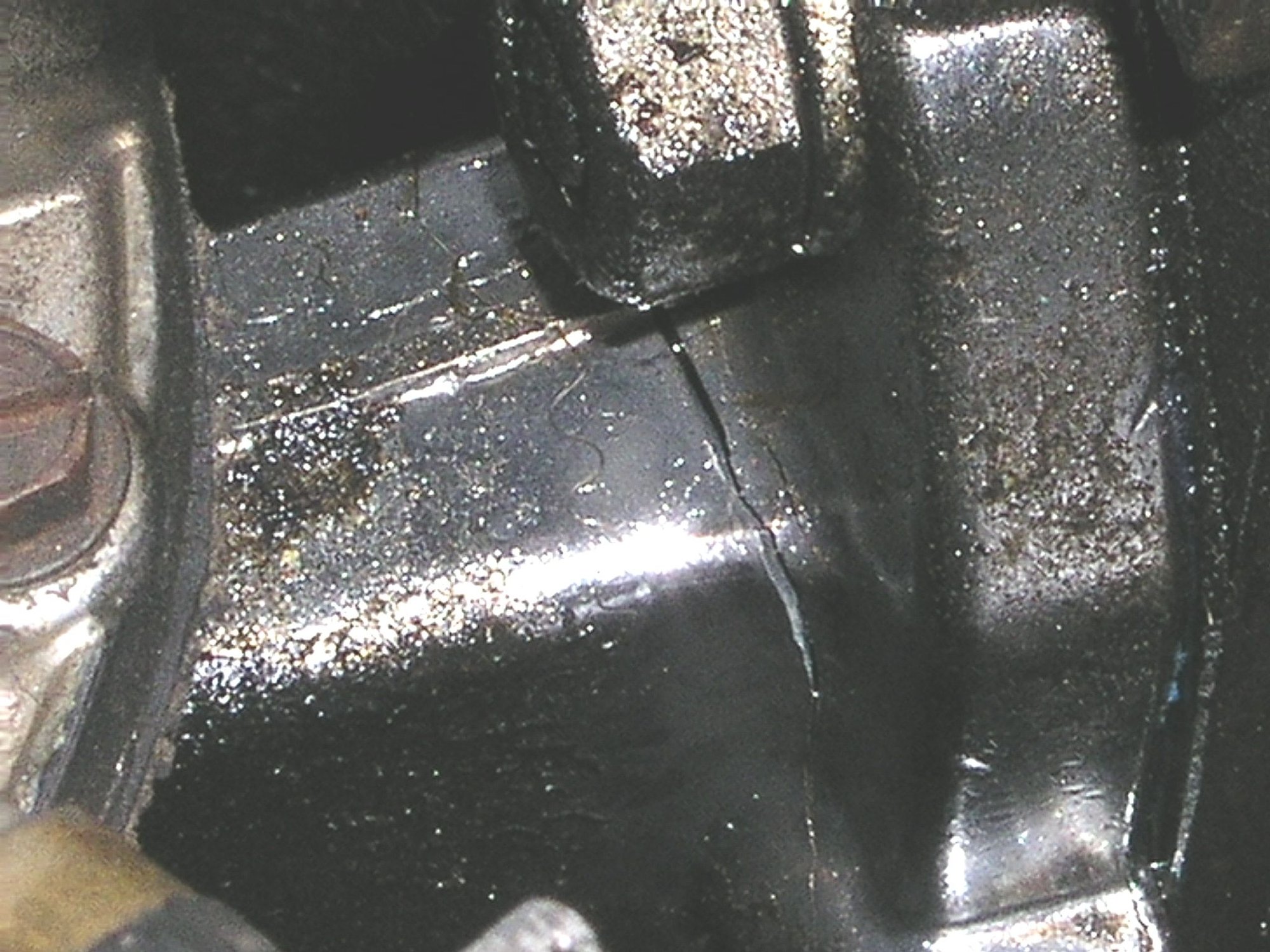

Also, the Holley pumps were prone to cracking through the pump arm pivot pin hole. The one I had eventually cracked. I wonder if the TSP chrome pump is prone to the same cracking issue?
