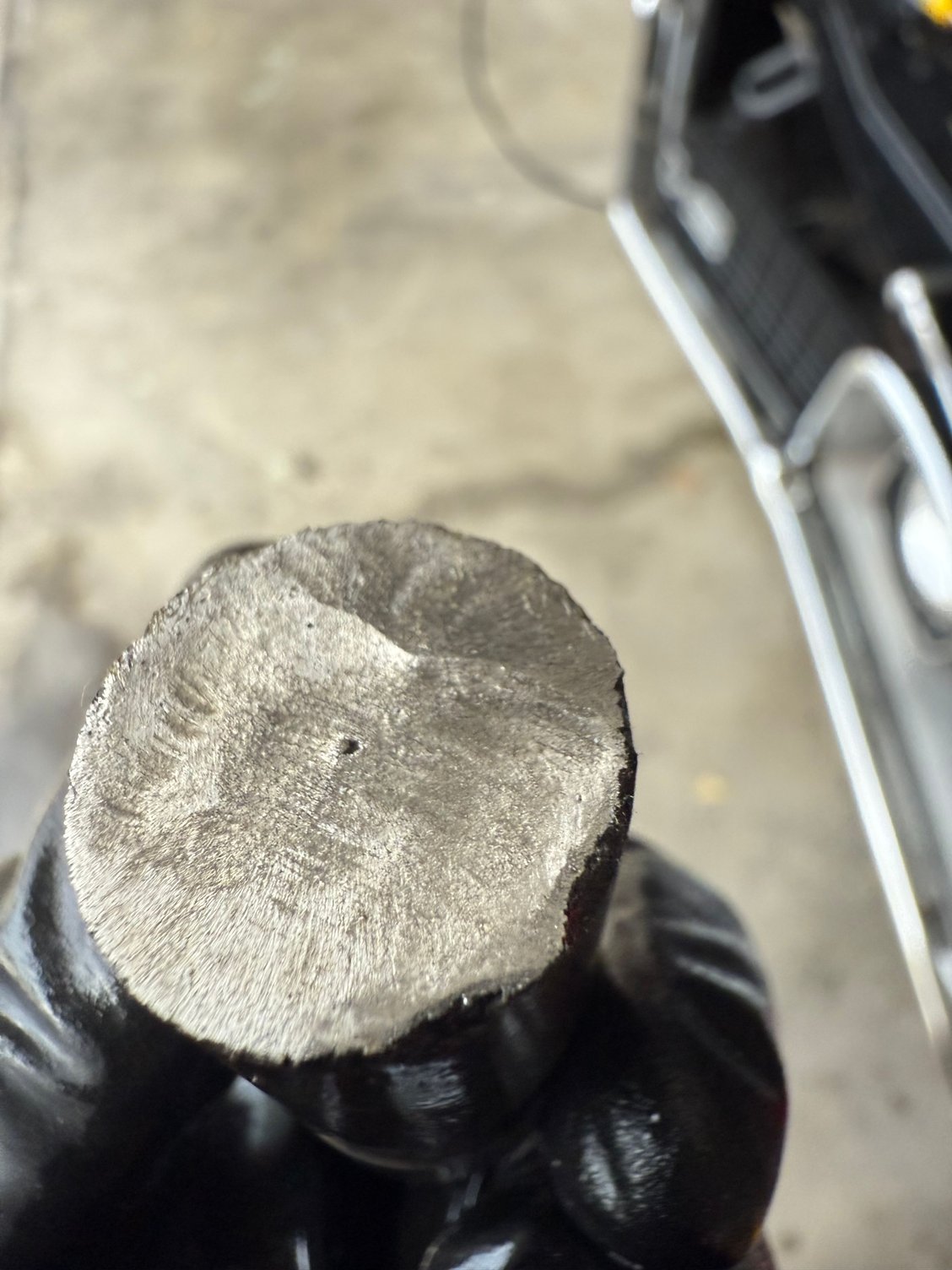

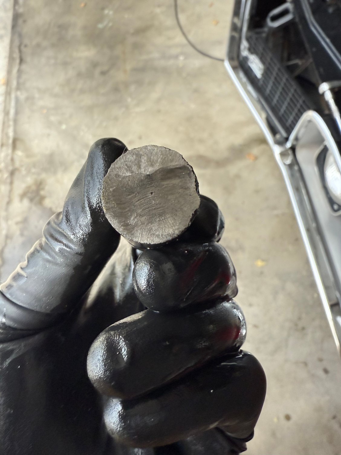

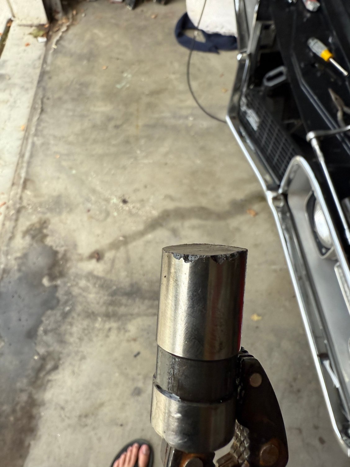

So gentlemen, This WAS a brand new lifter on a brand new cam, brand new pushrods, new rockers, new heads, new intake.
Heard the exhaust rocker tapping, took the valve cover off, found the exhaust pushrod loose, and the lifter was “squishy.” Took off the manifold and removed the exhaust lifter to find this nonsense. All of the other lifters are solid, including the intake on the same rocker.
Thoughts? Just a bad or clogged lifter? Any suggestions on cleaning out the removed material that is now certainly in the block…without a rebuild? Can I just throw a new cam and lifters in and call it good?

You need to figure out why that lifter was not spinning.
Well, it was certainly a pain to remove. The lifter bore felt smooth once the lifter was removed. I attributed the rough removal to a slightly misshapen lifter?

What was your break-in procedure and what oil did you use? In 40 years I've never lost a flat tappet cam.

Definitely check those lifter bores. I know you can use a dial bore gauge to measure the concentricity of the cylinders. I suppose you could use precision instruments to measure the lifter bores too.
I used valvoline zr1 10-30, the zinc added oil. Drove around trying to keep the rpm at 2k, except for the occasional stoplight, for a solid 45 minutes. I used assembly lube on the cam, and primed the oil pump before throwing the engine in the car. There was certainly some idling when I first fired it up in order to set timing and carb, but I felt like I did a good job of breaking it in? Didn’t take any shortcuts…in my mind.

Absolutely the incorrect break in procedure. 20/50 high zinc no additions. Don't drive it. Do it in the driveway. Also cam and lifters slathered up with assembly lube.

Well, it’s possible I didn’t break it in correctly. I read all posts on this thread and reviewed the instructions on the cam itself. Hard to get a “right” way to break in the engine. Beyond the break-in period issue, is there any option for removing any removed material without removing and disassembling the engine?

Most people are going to say pull it apart. For some of us, basically remove the old cam inspect and rinse off cam bearings, install new cam and lifters. I like Isky Rev-lube, a light coating on the cam lobe, bearing wear surfaces, and lifter bottoms. Coat the bores with oil. I use the old method for breakin oil, straight 30w non-detergent, and change the oil right after breakin with VR1. Do a couple of short oil and filter change intervals to ensure the metal particles are rinsed out the best you can and run it.

Based on these pictures, you have some large pieces of hardened material from around the perimeter of that lifter somewhere in your engine, not to mention everything else that abraded off the face. Personally, I couldn't sleep at night without knowing I cleaned the block and oil passages but you might be comfortable not tearing it down.

More than likely, you will find some serious bearing issues. That’s a lot of metal to be floating around in there.

Cam lobe has to be wiped Looks like someone hit that lifter with a bench grinder.
