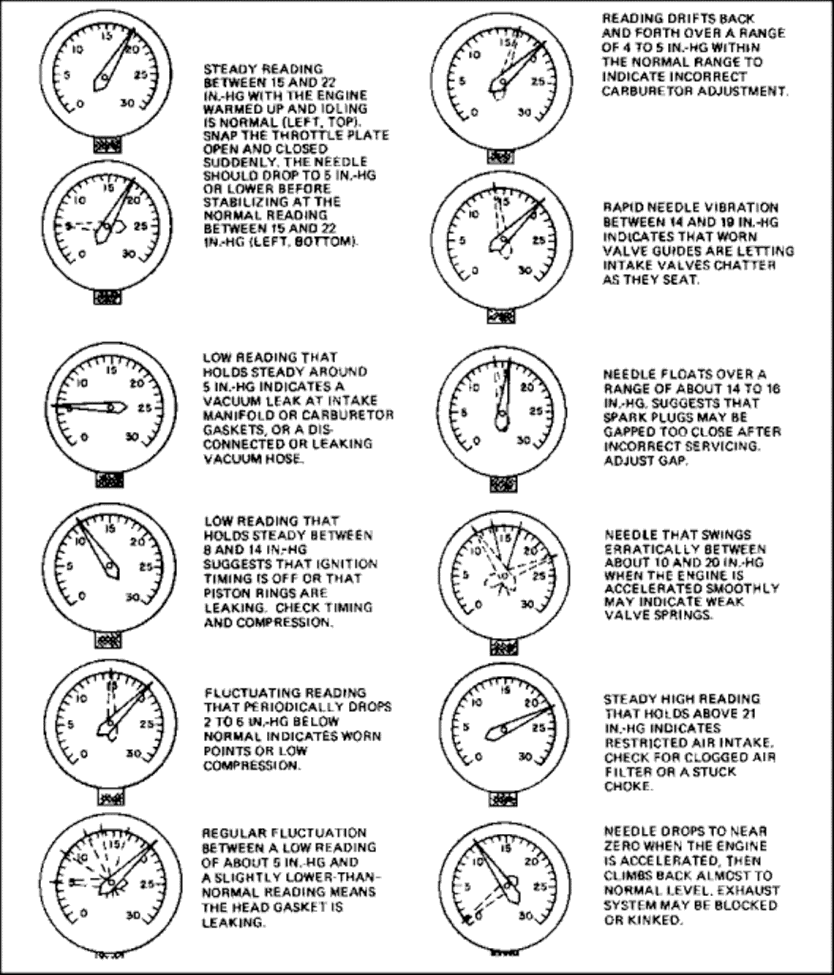

Generally, perform a leak down test when prior results suggest further diagnostics. (1) Perform both a dry and a wet compression test on each cylinder - compare results between dry & wet; (2) Perform a basic vacuum test noting readings suggested from chart below.
