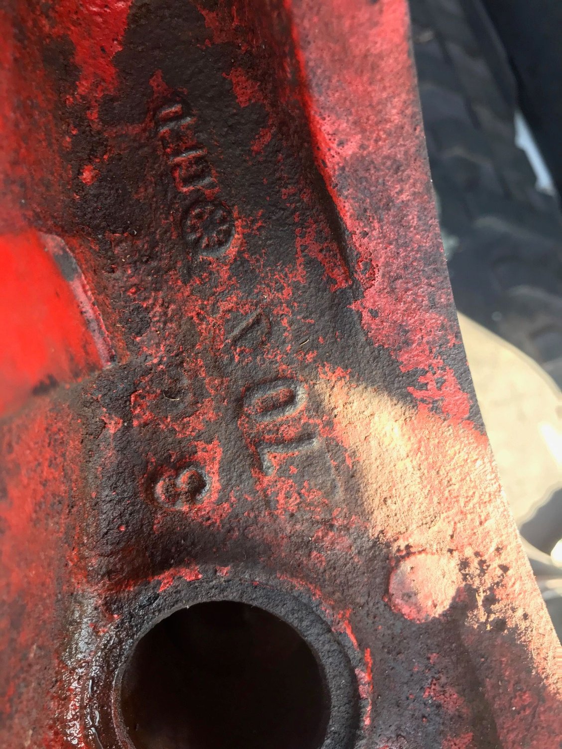

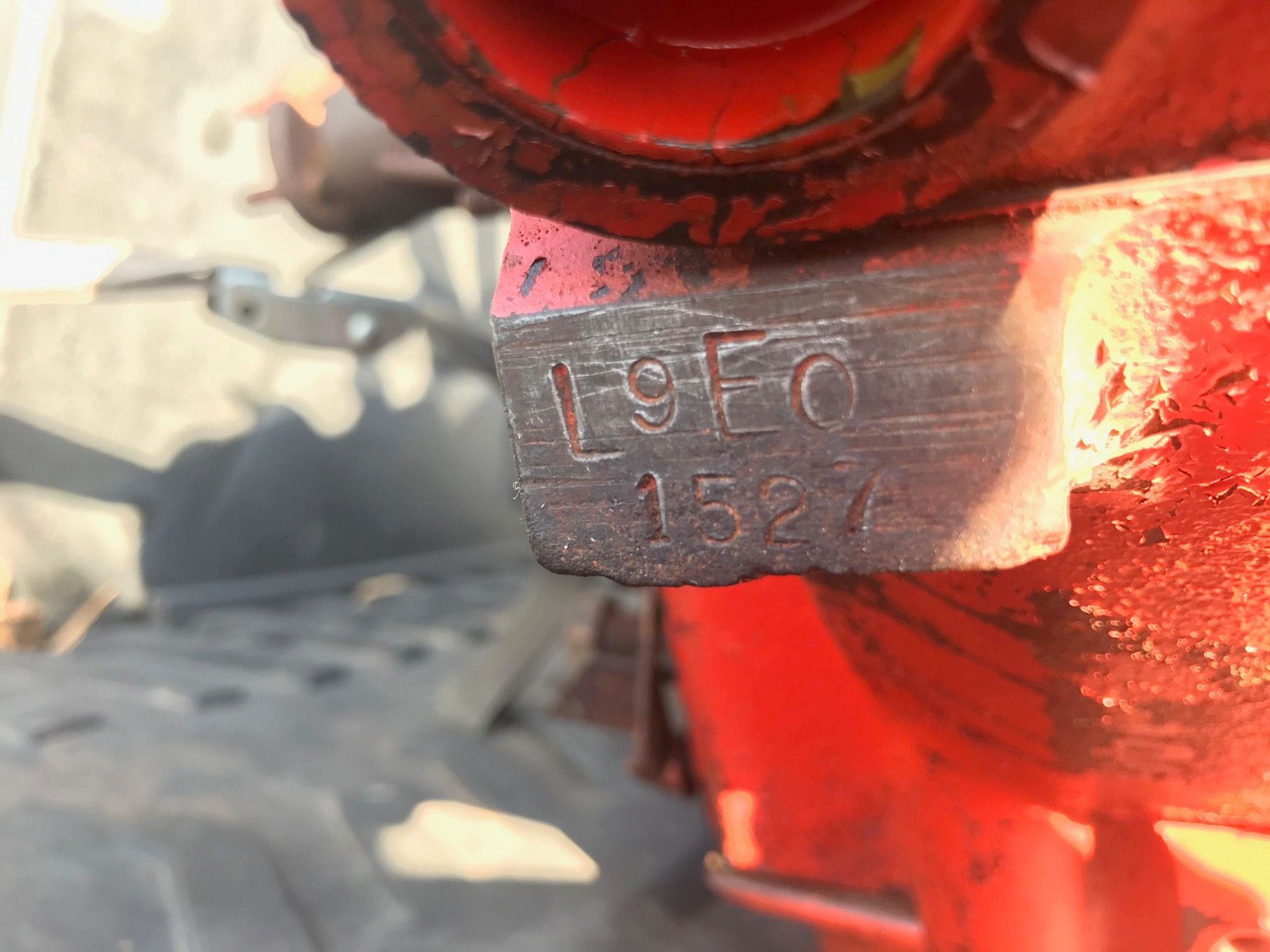

I am trying to find out what 455 I have. L9E0 stamped on the left front pad. All the info I have found mentions at least six numbers of the VIN? It does have a 70-72 iron 4bbl intake and a pilot bushing in the crank. 396021F. "C" Heads. Thanks in advance.

For marine engines, there is a number that begins with an "L". This strange "VIN derivative" (or engine unit number) number starting with L denotes a marine motor. This may appear something like "L8E00", where L = Marine or irrigation engine, 8 = 1968 model year, and E00 = engine serial number (although there are usually more digits in the serial number). There might also be a drill spot on the pad.
It looks like it is a boat/irrigation motor. This may explain why I can not turn the crank. Hopefully I did not end up with a boat anchor. The rocker arms and top of the heads look almost new after removing the valve covers. Anymore input would be greatly appreciated.

it is a factory assembled service / industrial / warranty / boat engine, not a factory installed automobile engine
https://classicoldsmobile.com/forums...2/#post1231474
https://classicoldsmobile.com/forums...ock-id-147019/
there was a thread with additional year & usage decoding info, but I can't find it
what is the casting number on the intake manifold?

404521 is the '70 455 automatic transmission intake manifold
I believe there are at least 4 "C" heads: big VS. small intake valve & small heat crossover (early) VS. big heat crossover (late)
early VS. late took place during 1968 model year
do you have a full pic of crank flange? block appears to be cast 70th day 1968 = Monday 3/11/68

The OP found the answer himself in Post #3. That block is from a non-automotive application. Could be industrial, could be marine. Only engines originally installed in production cars got VIN derivative stamps. Olds sold a lot of motors for non-automotive applications.

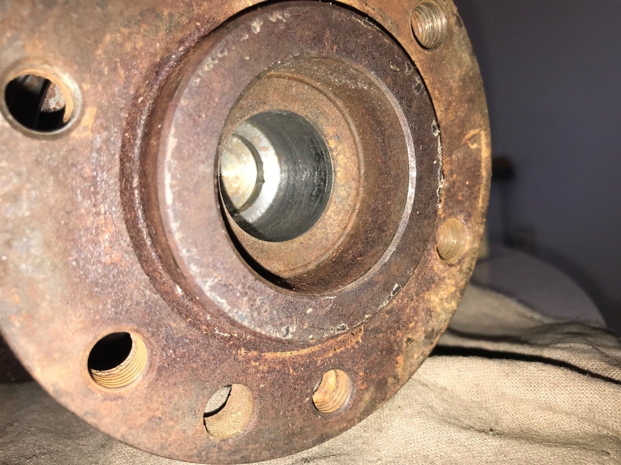

The U notch is the run of the mill nodular crank. This photo shows MT (left) and AT cranks. Note how the MT crank has a much deeper hole with a bore for the pilot bearing and clearance for the input shaft.

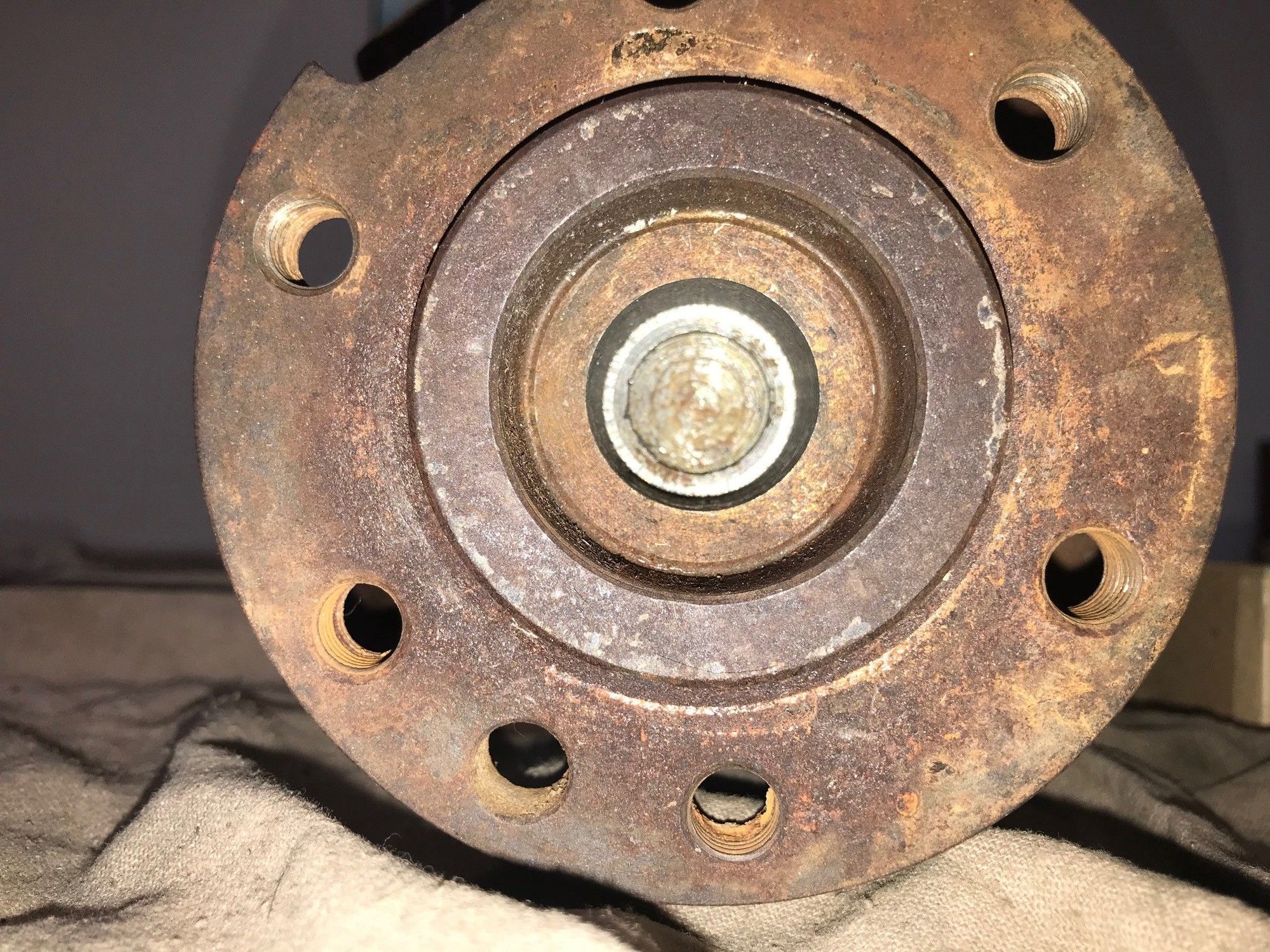

Here is what I have and I need a MT crank. Notch is not very visible.
Old Oct 22, 2020 | 10:20 AM
Posts: 50,770
What are we looking at there? Is that an AT crank with a conversion bushing pressed into it? Can't really see the details of the end of the crank with that bushing in place. Why not just machine the one you have for a pilot bearing?

That looks like 68-69 MT crank. 70 and up had a groove for a snap ring
Old Oct 22, 2020 | 11:53 AM
Posts: 50,770
It looks like an AT crank with a conversion bushing pressed in, but as I noted it's hard to tell with that bushing in place. A real MT crank would have another step where the pilot bearing would go.

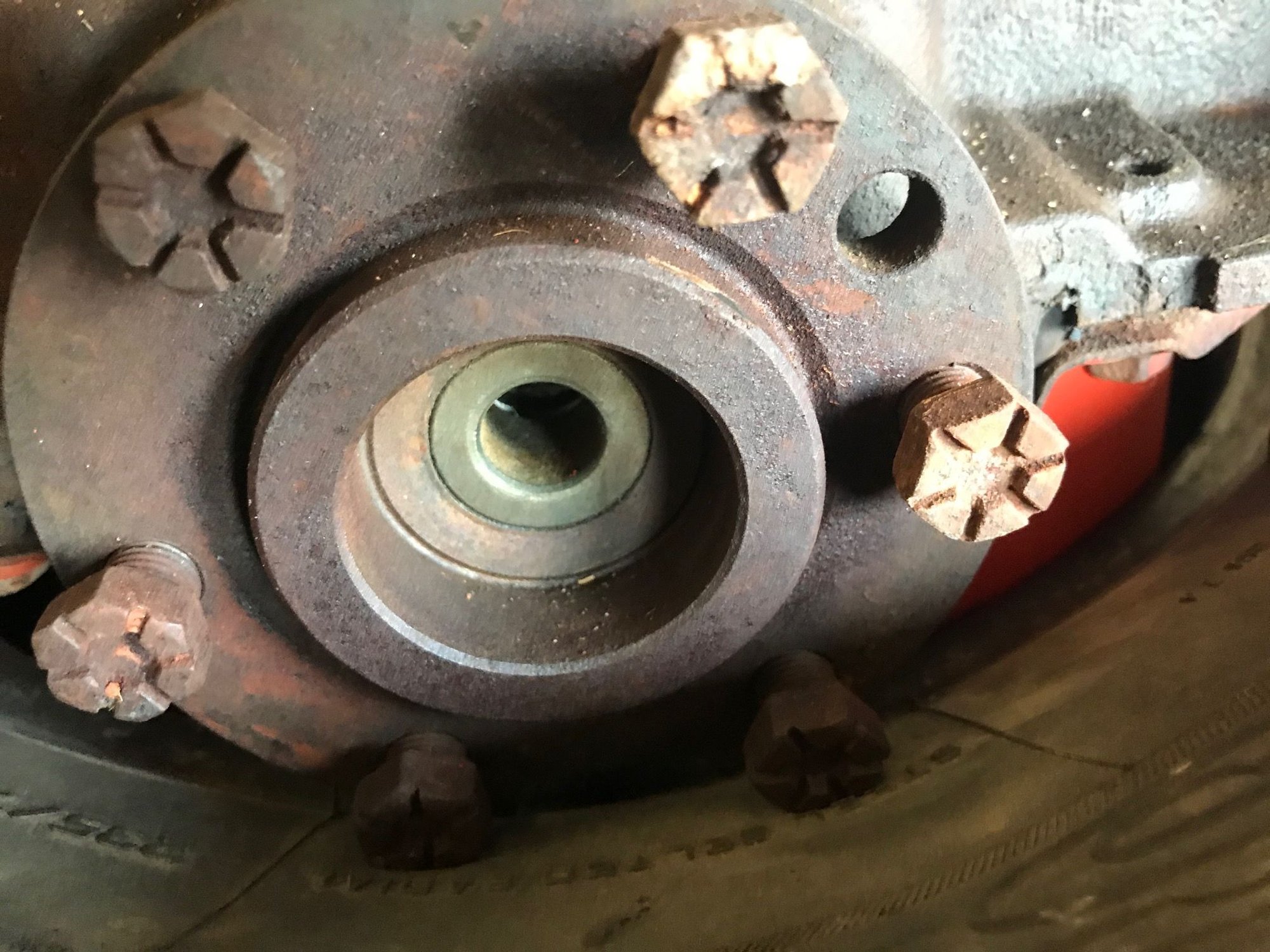

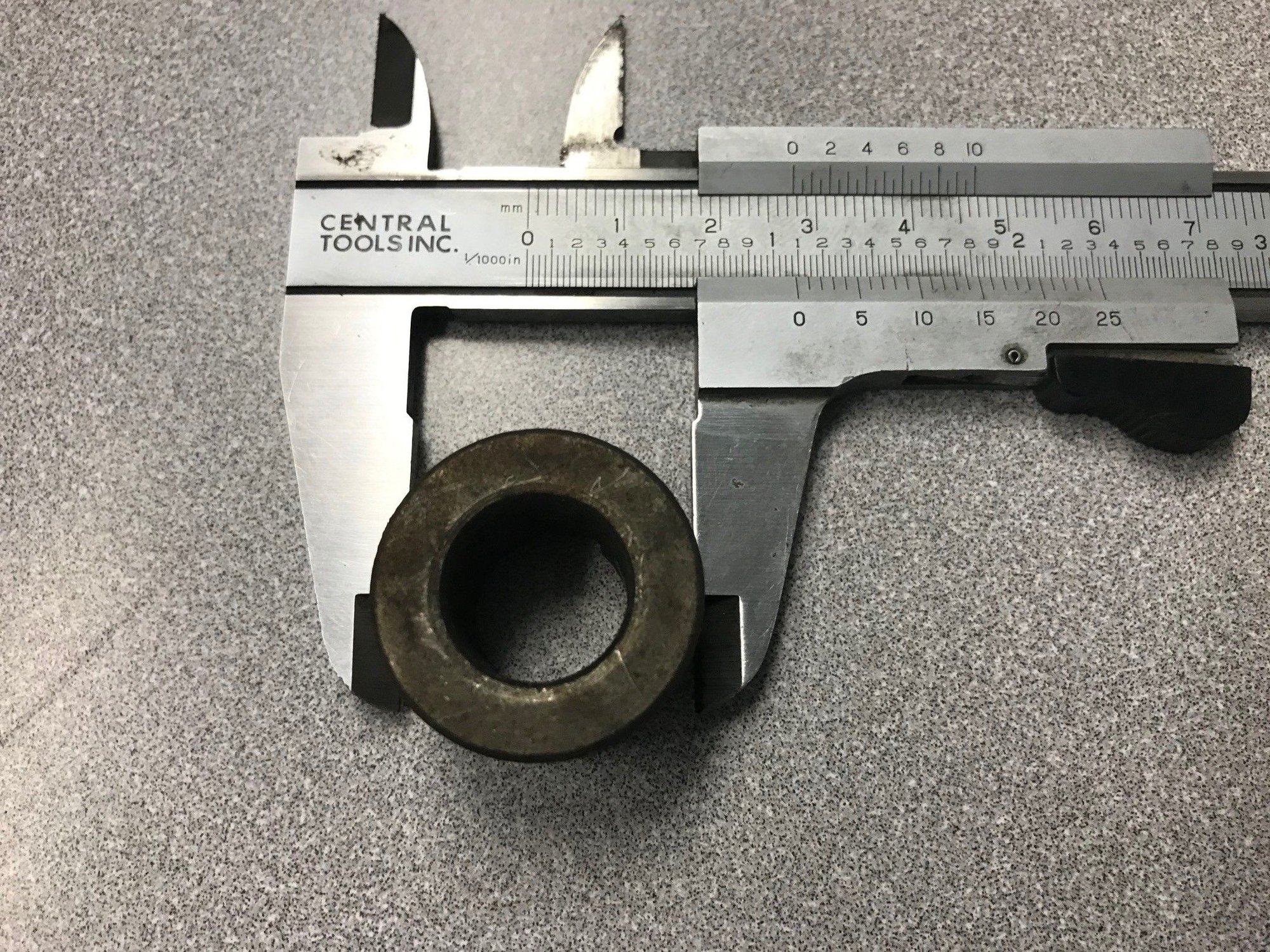

I was able to get the bushing out. Does this crank look like it is drilled correctly? It is an "N" crank. Rock auto list this pilot bearing on their site that measures about the same OD.
PIONEER 873008
Bearing; 1.093 O.D.; .642 I.D.; .715 Depth
They also have three other bearings with 1.37 OD that match the drill to spec.
https://www.rockauto.com/en/catalog/...t+bearing,1964
