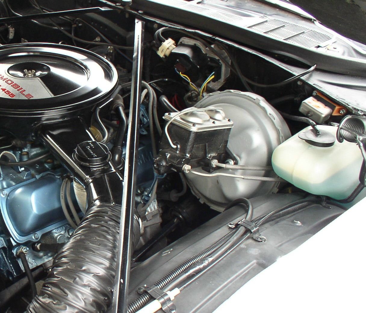

I have Ka heads on my 1974 Hurst/Olds, not the best pic but you can make it out...
