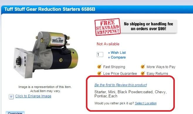

When in stalling the Mini Starter I keep hitting this "ear" piece off the side of the block just above the oil dip stick area, was wondering if I could shave this piece off and what is it's function, thanks for any help.

What brand of mini starter are you using and what motor

That's for the support / ground / torque strap for the OEM starter. See the assembly manual for an illustration. You don't neeeeeeeeeed it, no.
Rather than alter the block permanently, could you maybe clock the starter to a new orientation?

The starter is
olds 455 The starter is the Tuff stuff Performance 6586b, I have tried to clock the starter but there isn't any setting that will fit, unless I add like 1/2" spacer in between the mounting plate and the block. Thanks Octania.

is it the right starter for olds ? I think a lot of guys here run the powermaster mini starter....mine bolted right up no interference
the summit page lists yours for chevy and poncho

olds 455 It's the tuff stuff 6586b which is suppose to be for the Buick Olds Pontiac cars. No matter how I adjust it the solenoid bumps against that ear piece. I see some on eBay for under $150 was wondering if I should just get a completely different one. I think they are called "Snap ez start" they seem to have a lot more adjustments versus the one I have. Just confused.

Well you can try any brand of mini starter you want but consider this!You have been advised on a brand that works with no issues.That brand is powermaster and while you may and i say may find a cheaper starter to work. Why not just get one that works and is proven not by one guy but two.I have three powermasters on three engines no fitting problem.Mine was a 9510 for a 455 a body. Enough said! You choose if you want to follow a path of trial and error till you find one that works.

Thanks for all the help, I put the factory back in and will order the correct one, can always count on you guys for the best advice, Happy Holidays to all.
