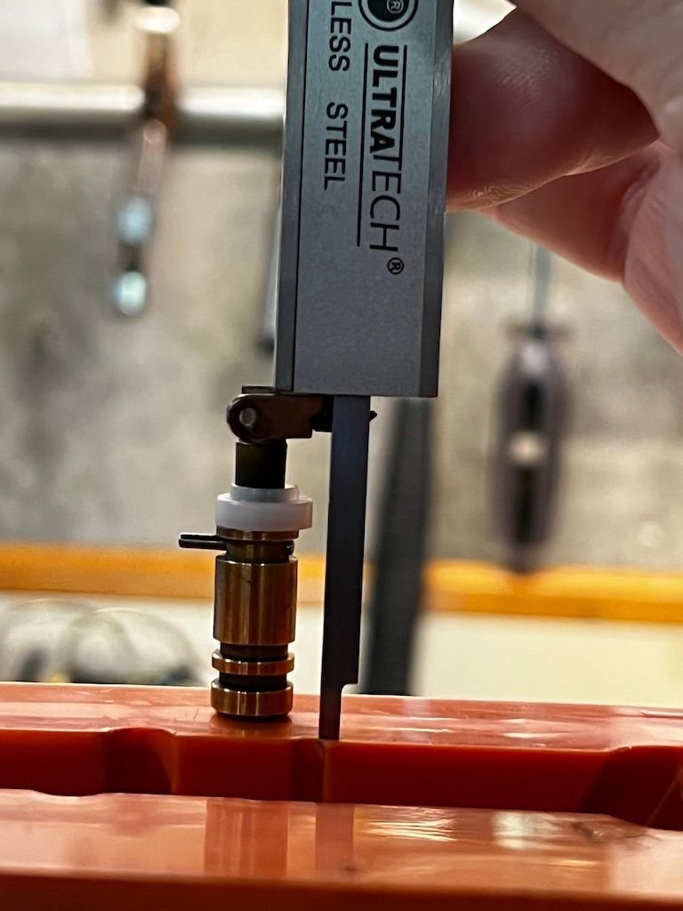

This morning I took a few minutes to get a reference height from my most recent carb redone by SMI in 2017 using a digital caliper. The reference height SMI used was 1.3350” from the bottom of the cylinder to the top of the arm. Lots of my power piston arms were much taller or bent or otherwise off kilter. So I just went through a bunch & set all the rod arm tops to 1.3350”.
Here's where I was taking the measurement:
Use the depth gauge feature on your caliper to measure the height of your qjet primary rod arms - get 'em equal for consistent side to side fuel metering.
Here's what that depth looks like on the gauge.
Height from bottom of 170 Series qjet power piston to top of rod hanging arms.

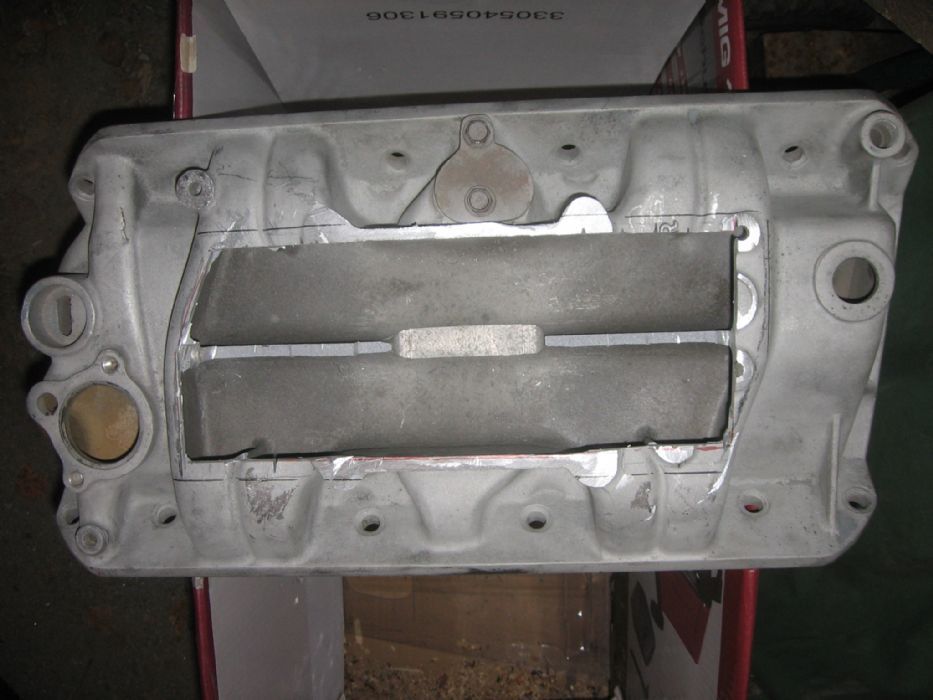

I'm not making the connection between the left/right offset on the primary rods and the O2 sensor left/right differences, though. For that to happen, each carb primary would have to feed one side of the engine, and that is not the case. You can easily see in the picture below the left side primary feeds cylinders #1 and #4. Am I just missing something here?

Are manifold runners that close to mirror images? My opinion is no, the first thing the dual plane manifold does is different things at the plenum. Not really knowing or having one in front of me I can’t evaluate, I don’t profess to know, just putting it out there for discussion.

Insightful post, but I question the connection between metering rod height and side-to-side lambda variation. If you have a dual plane manifold, each metering rod feeds two cylinders on each side of the motor, so each of your dual O2 sensors is seeing both primary barrels. If you have a single plane manifold, one can argue that there might be a bias, but I'd counter that the pulses in the intake will mix the flow and likely mask any side-to-side variation.
This would only be an issue if you had one of the goofy Offy single plane intakes with the divider down the middle, and anyone running one of those has bigger problems.
