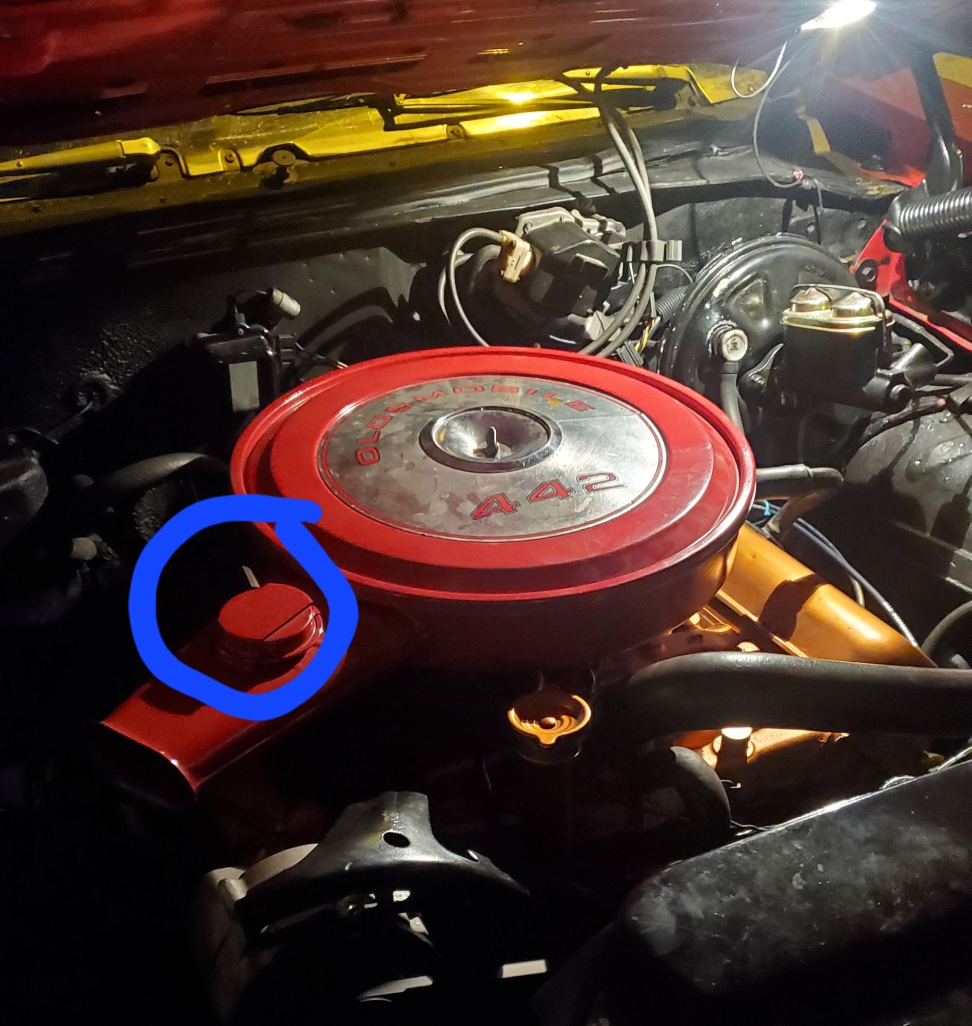

Latest victim is the hot start hot air valve on the air breather (no mechanic around me knows what the part is actually called let alone a part number or source. It's getting vacuum but not closing on a hot start, making hot start very rough, need to pump the gas for a few minutes before it'll clear up.
Any info on the part name, part number, or potential sources would be greatly appreciated!
The part:

That's the Thermac door/valve, at least that's what I've always heard it called. If your Olds has trouble starting look at the timing and choke before blaming the inoperative thermac system.

Thanks for the info, a mechanic has confirmed that the flap isn't closing when receiving vacuum. Cold start is fine, though it is taking a while to get up to temp. Immediate hot start is fine, but cold day, warmish engine after sitting for half hour is no good. Wants to sputter and die.

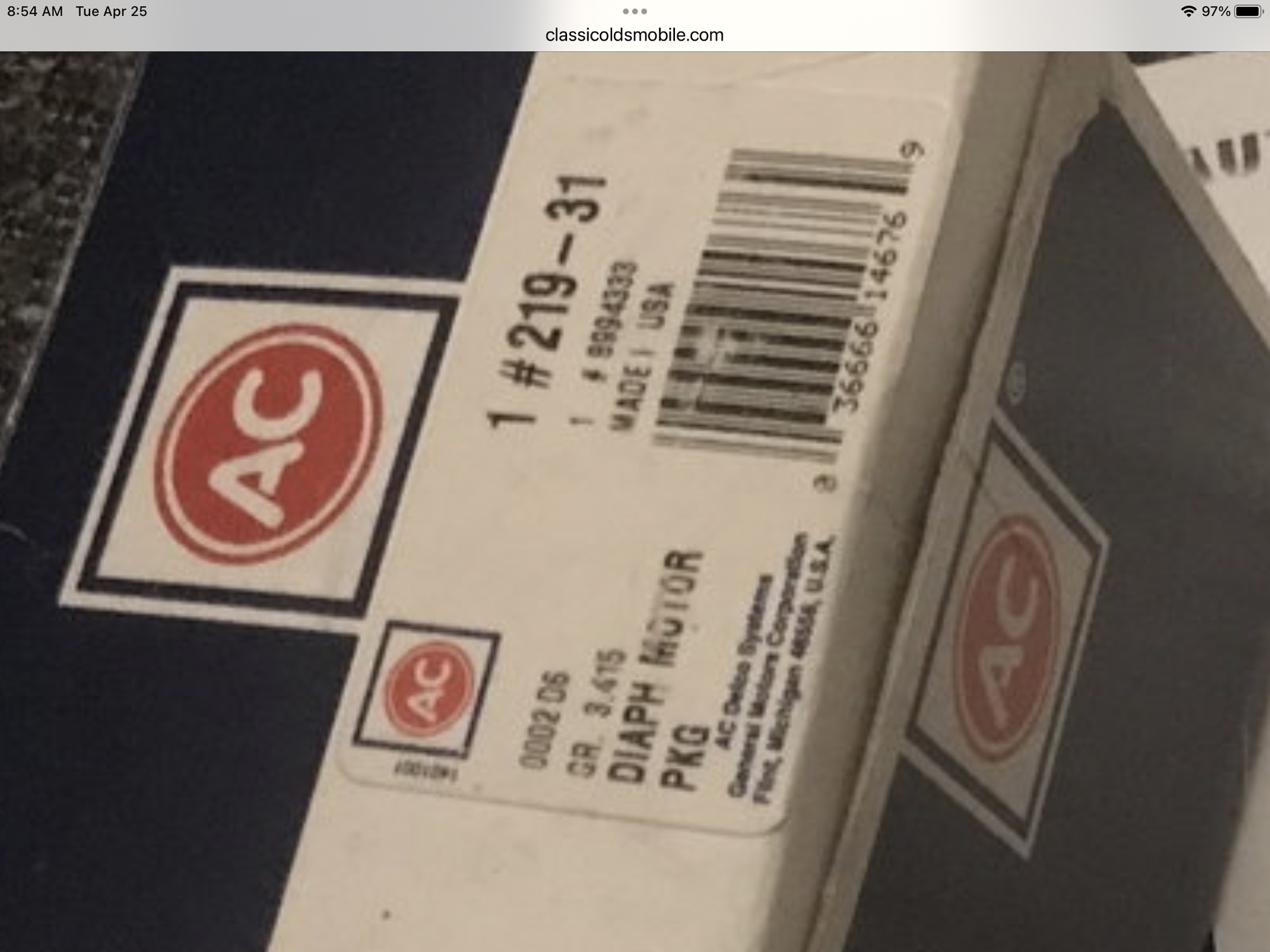

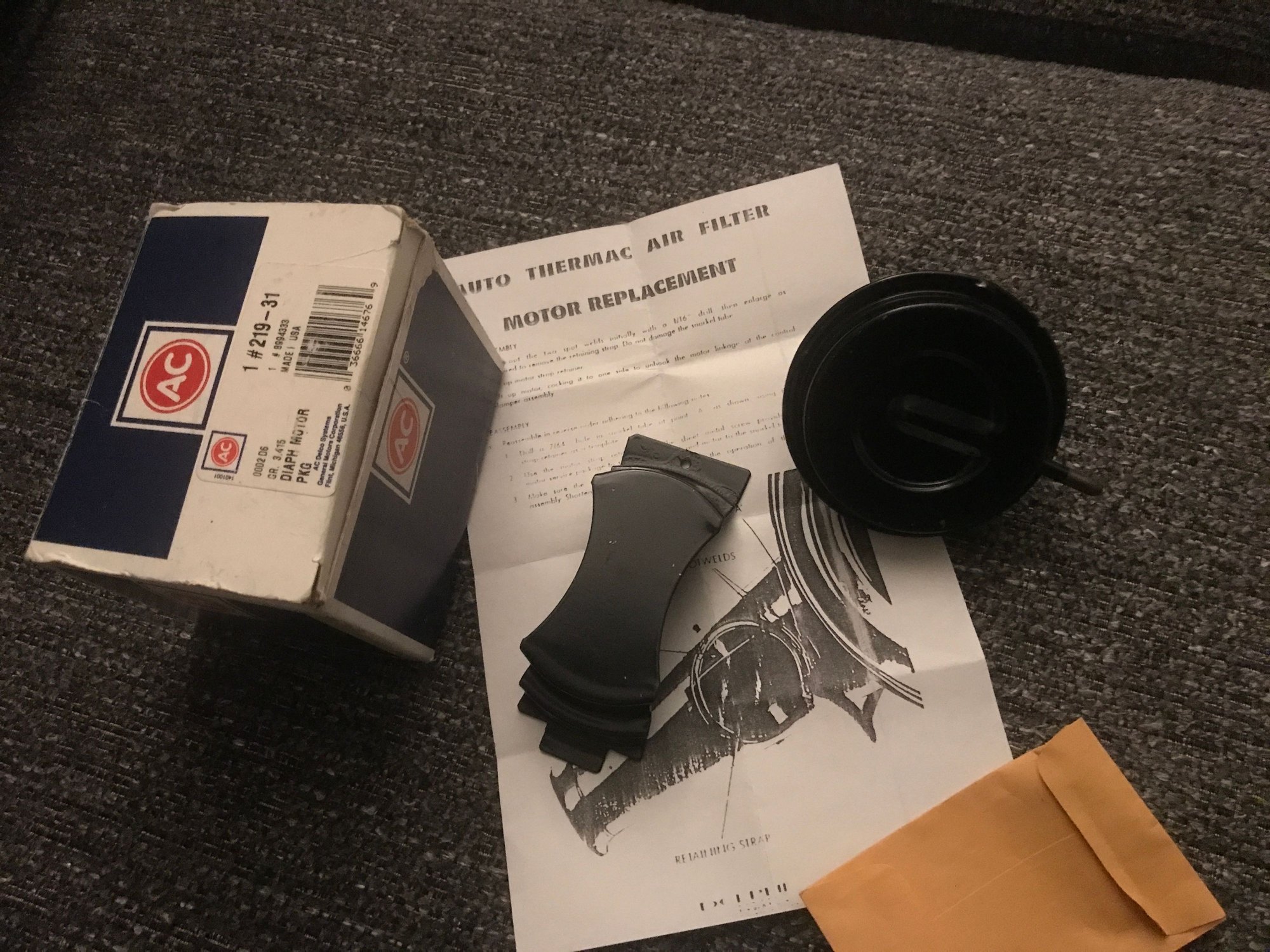

Choke motor it’s called. You can get them in AC delco replacements, even comes with a pop rivet, painted glossy black, yours is red, don’t know about that
That's awesome, can't find it on AC Delco's site with the P/N, any chance you have a link?
Old Apr 24, 2023 | 07:44 PM
Posts: 50,768
And yet, neither the box nor the instructions in the photo you posted refer to it as a "choke motor". Sometimes it pays to just crack open the CSM.

I couldn't find a part with the AC Delco #219-31 that Burd posted.

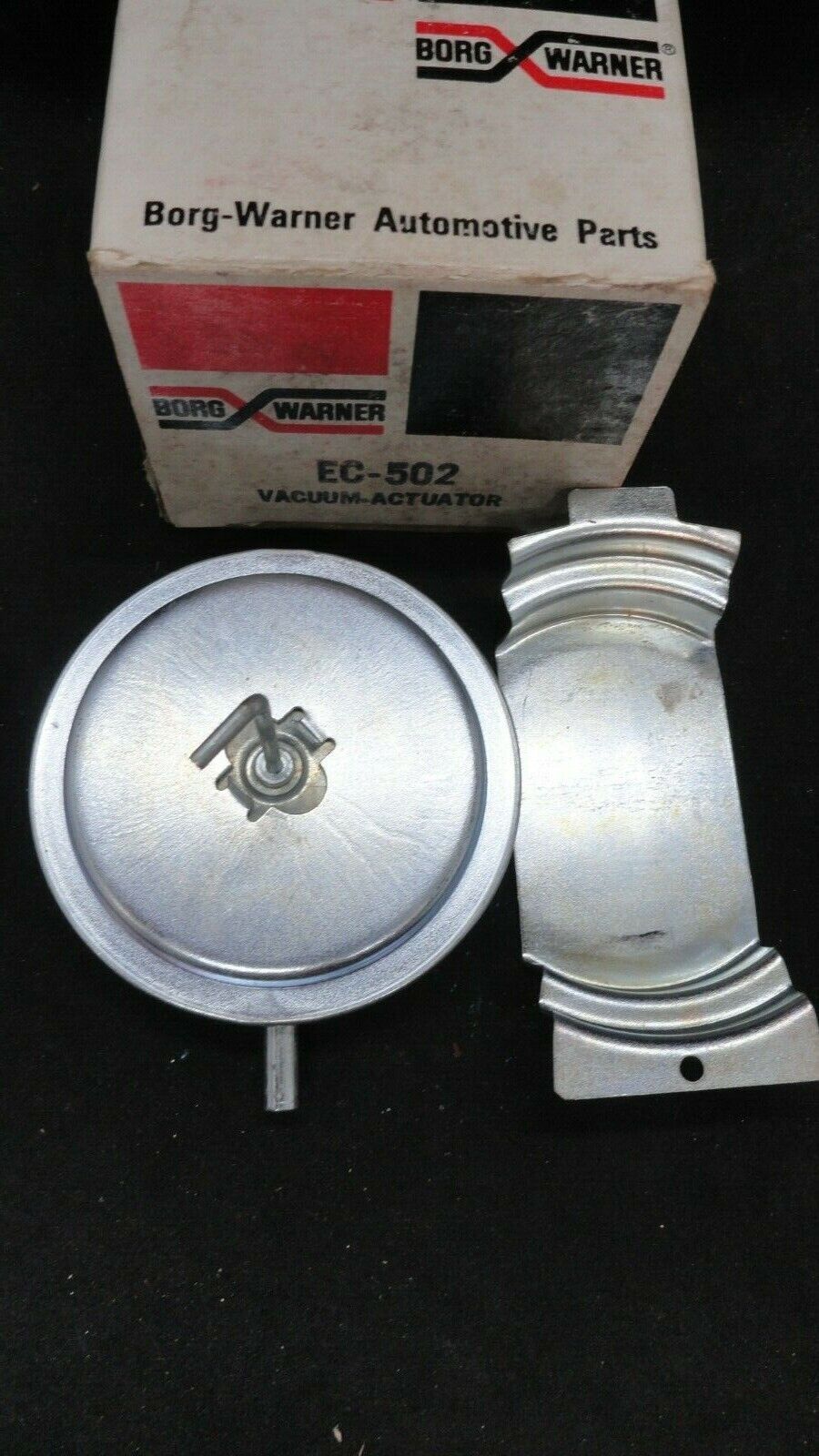

The original part number for that actuator is 6484246. Search that number and you'll find NOS ones and new replacement ones, like this one.

They called it a motor?
