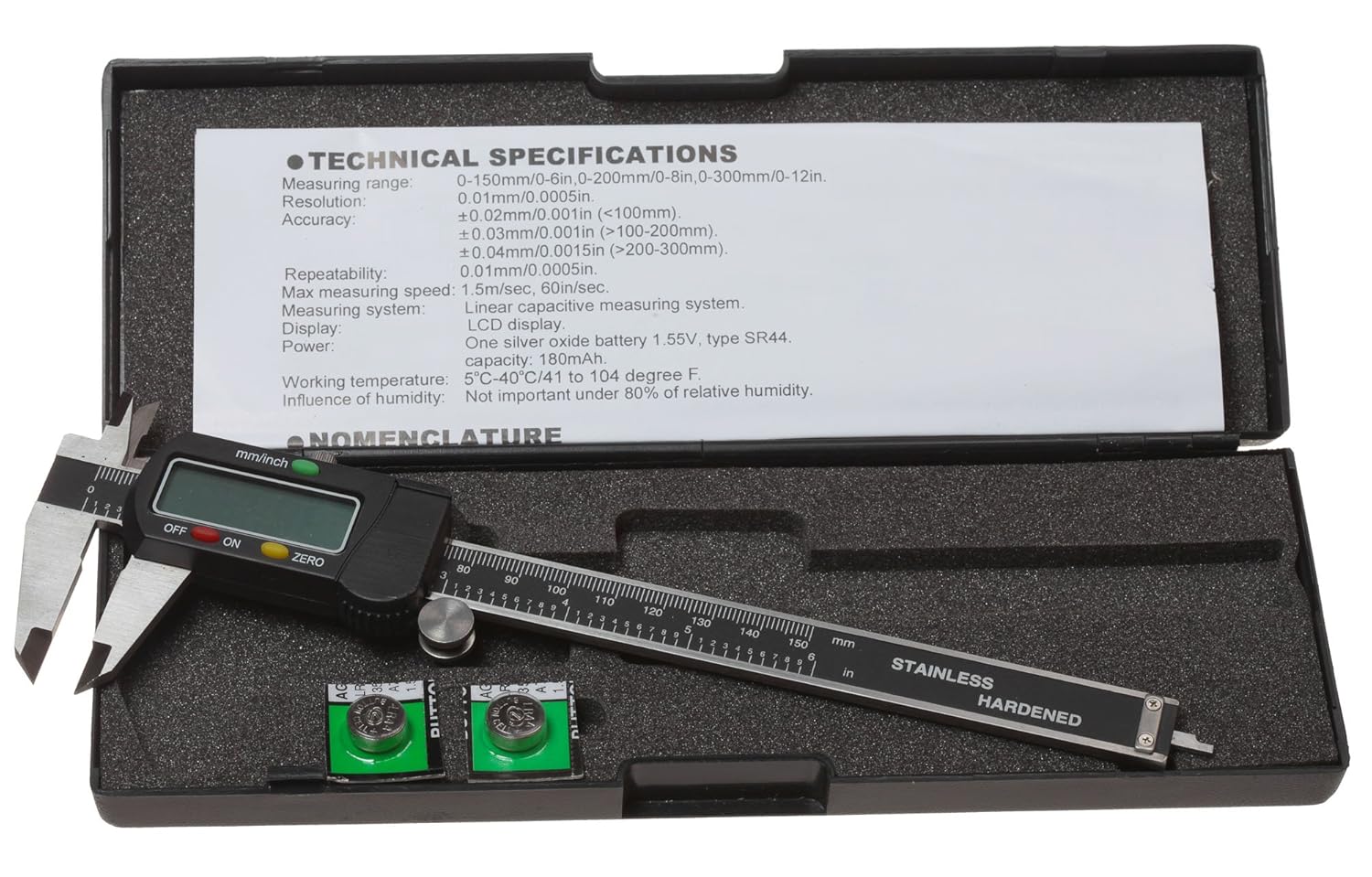

If it were me, while the engine is open I would measure the head combustion chamber volume, the piston dish volume, and the piston-to-deck clearance. Those numbers would allow determining the exact compression ratio, with no guessing.
Old Sep 23, 2014 | 05:32 PM
Octania's Avatar
Posts: 7,286
http://www.ebay.com/itm/6-Inch-150mm...item27ec32e766
