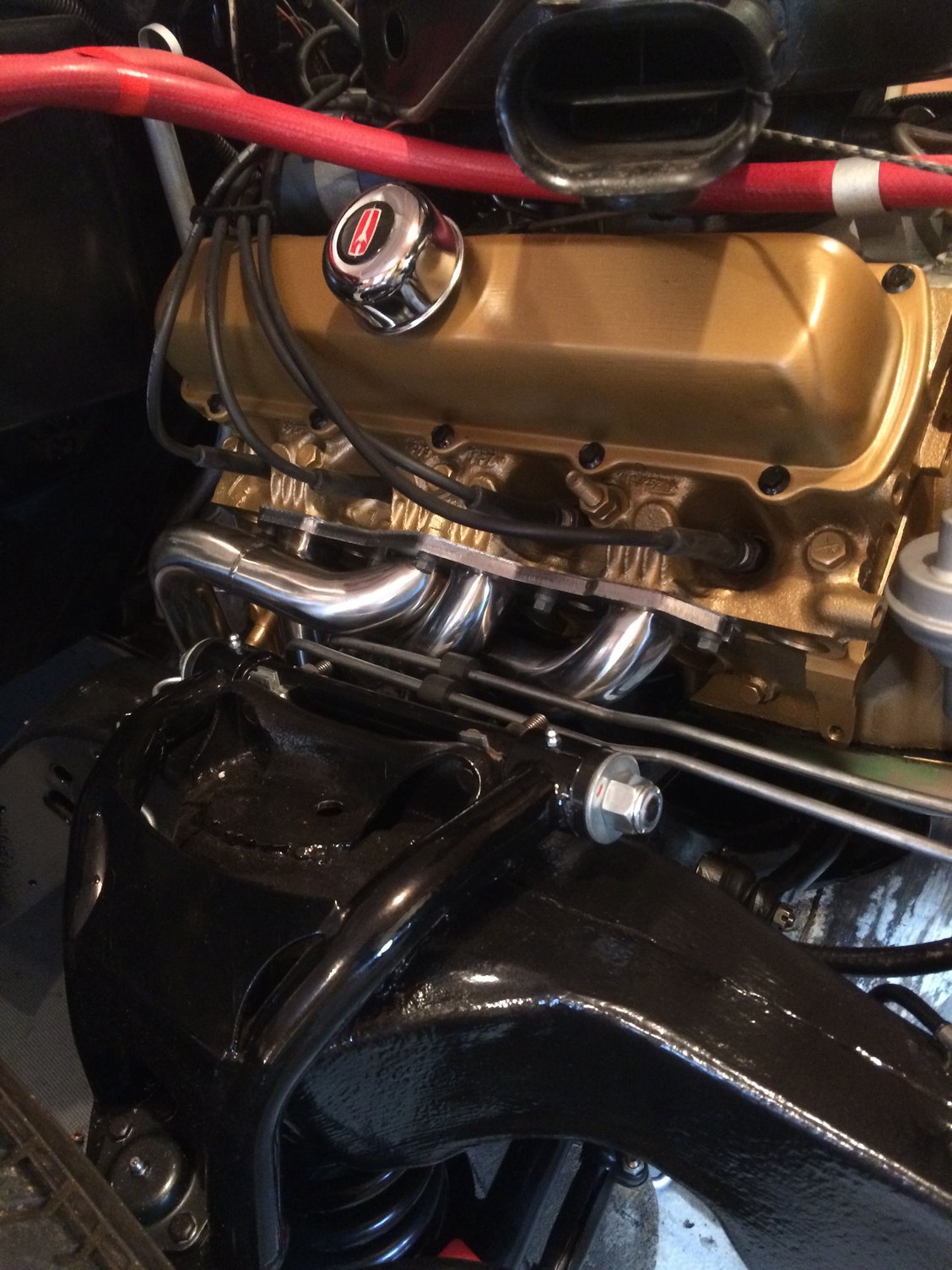

I gotta say I bought the cheap stainless headers off eBay and so far they’ve been great . Nice thick flanges been on there almost 5 years and no leaks . They do hang a bit low but my 72 350 cutlass has plenty of clearance .

In the photo the trans cooler lines look like they are touching or very close to the header tubes. That can cause high trans fluid temps. You may want to reroute the cooler lines to protect your trans.

That pic was taken just after engine install .I addressed the lines after that.The header on that side installed with ease .
