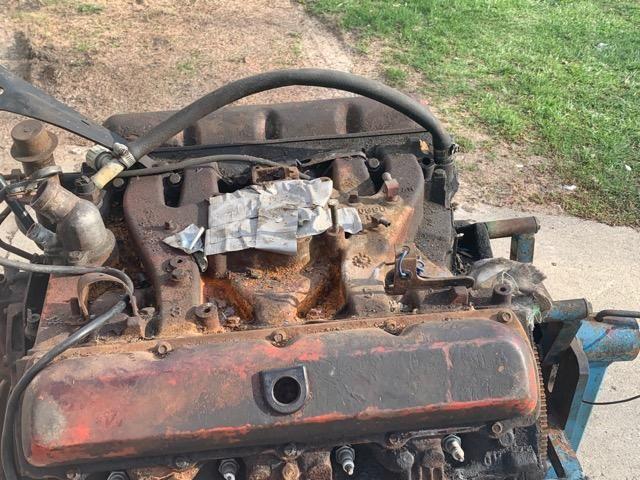

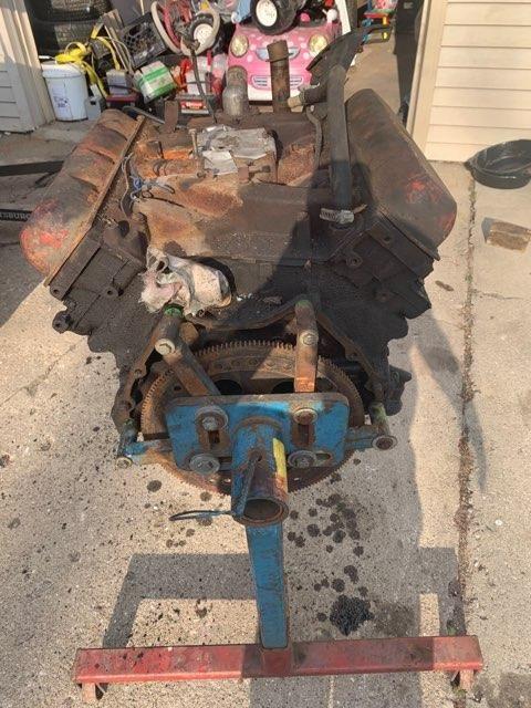

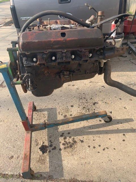

Got a chance to get this 425 let me know what you guys think!
Old Mar 13, 2022 | 04:32 PM
1978DELTA's Avatar
Joined: Feb 2022
Posts: 51
From: Allen Park Michigan
Hi Olds family!...your fellow brother Nick here from Michigan building and restoring my 1978 Delta 88 in memory of my late wife who passed away January 7th of this year...now I have a chance to pick up this 425 off of a guy locally for $400 dollars...I initially wanted to build a 455 or do the unthinkable and splurge for a Rocket Racing block...but everyone has one of those on their wish list...let me know what you guys think of building the 425 or should I keep searching through hell and high water for a 455 in my area or just shoot for the RR block and build it over time...this isn't a rush project by any means and would love to hear your input because I plan on building a wolf in sheeps clothing while keeping a pretty much stock appearance with the interior and exterior of the vehicle...thanks everyone!
Old Mar 13, 2022 | 04:50 PM
Sugar Bear's Avatar
Posts: 4,098
425's are excellent motors. Unless there is something wrong with it grab it. Check it as you would check any other used motor. All 425's are steel cranks.
Lifters and camshafts can be difficult or $ to source.
Again if it meets your criteria, grab it fast.
Sincerest condolences for your loss.

Decide what you want. A 455 has the 39 degree block and cam choice off the shelf is better. A 425 could be 39 or 45 degree cam angle. A 425 can be a 455 with a 455 crank, connecting rods and minor work on the block.
I wouldn't give more than a couple hundred for the 425. If it was me, I would pass on the 425 and find a 455.

I'd get the 425. It's a great engine and as stated in a previous post it has a forged steel crank. The 39 vs 45 cam thing isn't that big of a deal.
Old Mar 13, 2022 | 06:48 PM
Posts: 15,395
I agree with the others about the 425. Think of it as an overbored early 400 engine. Those were awesome, and 25 more cubes is even better.

At least one head is a C from the pics. If that head is original would C make it a '67 and likely a 39° block?

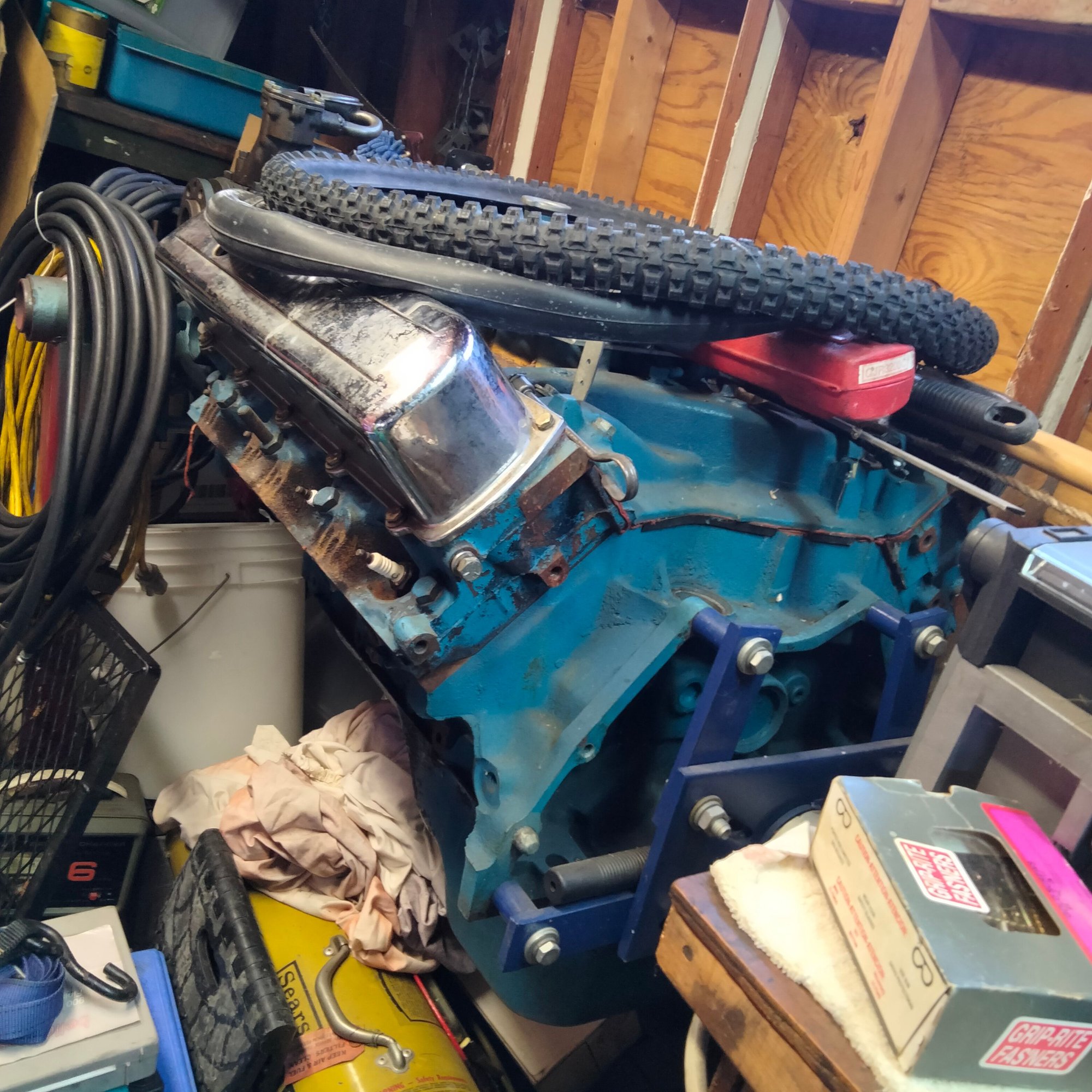

Finally found a 455 locally!...messaged a guy about a carburetor and he's currently restoring a Cutlass not sure what year but older fella and he was nice enough to let me know that his friend has a 455 for sale!...so I will be purchasing it from him here soon...waiting til I get off work to talk to him over the phone...I'm very excited!...I think the wife had something to do with it from Heaven...here's the picture he sent me...I'll post more as I get them!...not sure what heads are on it either but I'll find out and let you guys know!

Something weird????
why fo the valve covers look “Buick ish” I know it’s not a great picture and my eyes aren’t what they used to be but that valve cover looks strange , it could be the aftermarket valve covers ? But it looks more like a Buick 455 then an olds check all the numbers and head letters etc I do hope I’m wrong and if so my apologies
Old Mar 23, 2022 | 04:14 AM
Eddie Hansen's Avatar
Joined: Jan 2008
Posts: 3,515
From: South River, New Jersey
That said
Buick 455s have angled plugs? Something just don’t look right though
Old Mar 23, 2022 | 05:01 AM
Tri-Carb's Avatar
Joined: Apr 2020
Posts: 1,076
A Buick 455 has its distributor on the front of the engine in the timing chain cover. You can see the opening for a distributor at the back of the block in his picture.
Old Mar 23, 2022 | 05:22 AM
Joined: Jan 2008
Posts: 3,515
Yes indeed
yes indeed, thank you , the eyes are the second thing to go !!! lol but don’t the valve covers look odd? Maybe it’s me that’s odd lol
Old Mar 23, 2022 | 06:02 AM
32redman's Avatar
Joined: Apr 2018
Posts: 79
From: South Texas
The valve covers look like tall Moroso covers.
Old Mar 23, 2022 | 09:39 PM
Posts: 6,096
thats exactly what they are.
