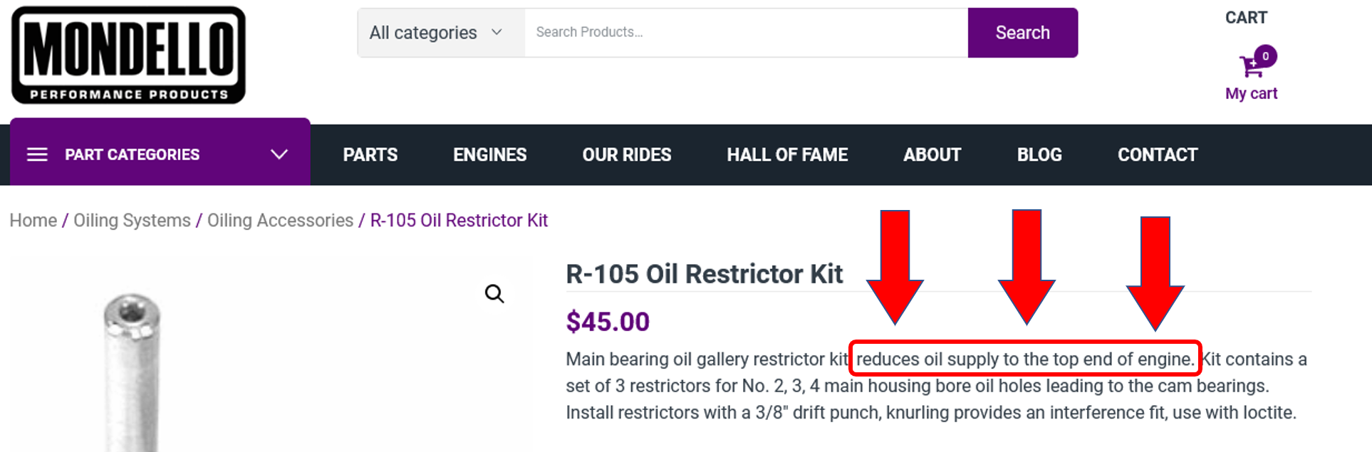

Anyone with a brain who spends 30 seconds looking at the Olds oiling diagram can tell by inspection that the restrictors that go in the passages that feed the cam bearings won't do squat as far as restricting oil to the rockers. If anything, they will (admittedly by a minuscule amount) INCREASE the amount of oil pumped upstairs because a fraction less goes to the cam bearings. Most of the time these restrictors are really good at causing premature cam bearing wear.
For arguments sake only, not doubting you..Mondello thought it did something and he seemed to have a solid brain.

And I'll ask it again. How does any oil get from the cam bearings to the rockers? Sorry, but this ad pegs the meter.
I hear ya, your an engineer, I am not..my thinking on a common sense level is the following…if your objective is to keep too much oil from flowing to the top, thus emptying the pan at higher RPMs. Then simply using restricted pushrods will restrict the push of oil up into the top end..unless you have a very high pressure pump the system equalizes itself simply by having smaller orifices in the pushrods keeping more oil down below. I guess my curiosity is did JM develop this as a potential fix or just a marketing thing to sell small widgets..curiosity killed the cat
You are correct that restricted pushrods or restrictor plugs in the 16 holes that feed the lifters are the only way to reduce oil flow to the rockers. Oil through the passageways to the cam bearings only feeds the cam bearings then flows back into the pan (via the spinning crank, which splashes that oil around to help lube the cam lobes). These restrictors that go in the cam bearing feed holes do exactly NOTHING to reduce oil flow to the rockers and nearly nothing to increase oil to the mains (which is not how they are advertised anyway).
