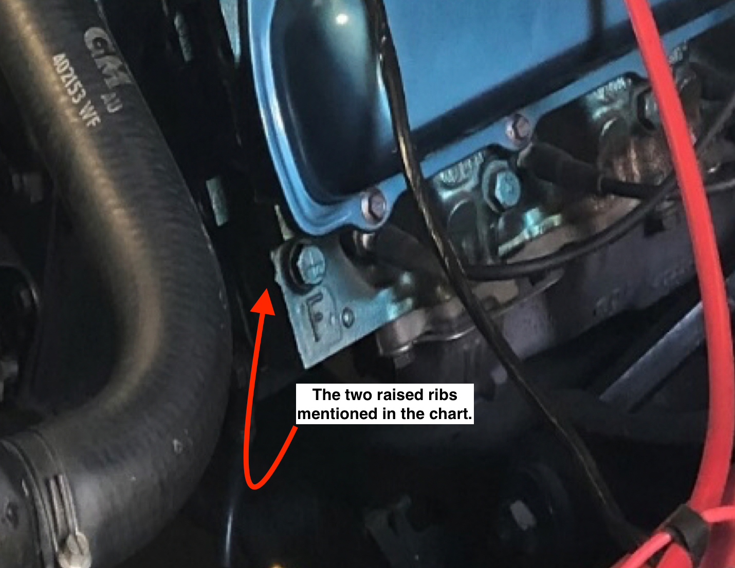

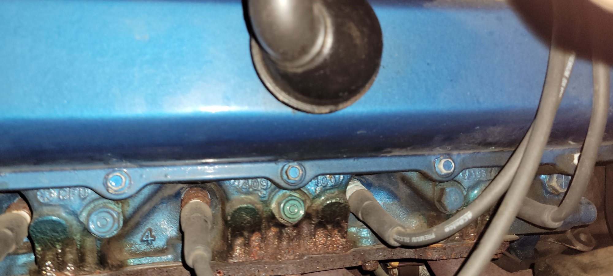

The intake could be a reproduction and the seller totally FOS.
No seller fully up front saying he built the car as what he wanted. I knew ahead of time it was a clone and prie reflects that.
Now look at the cast letter, sure look like an OEM F head
Casting #s

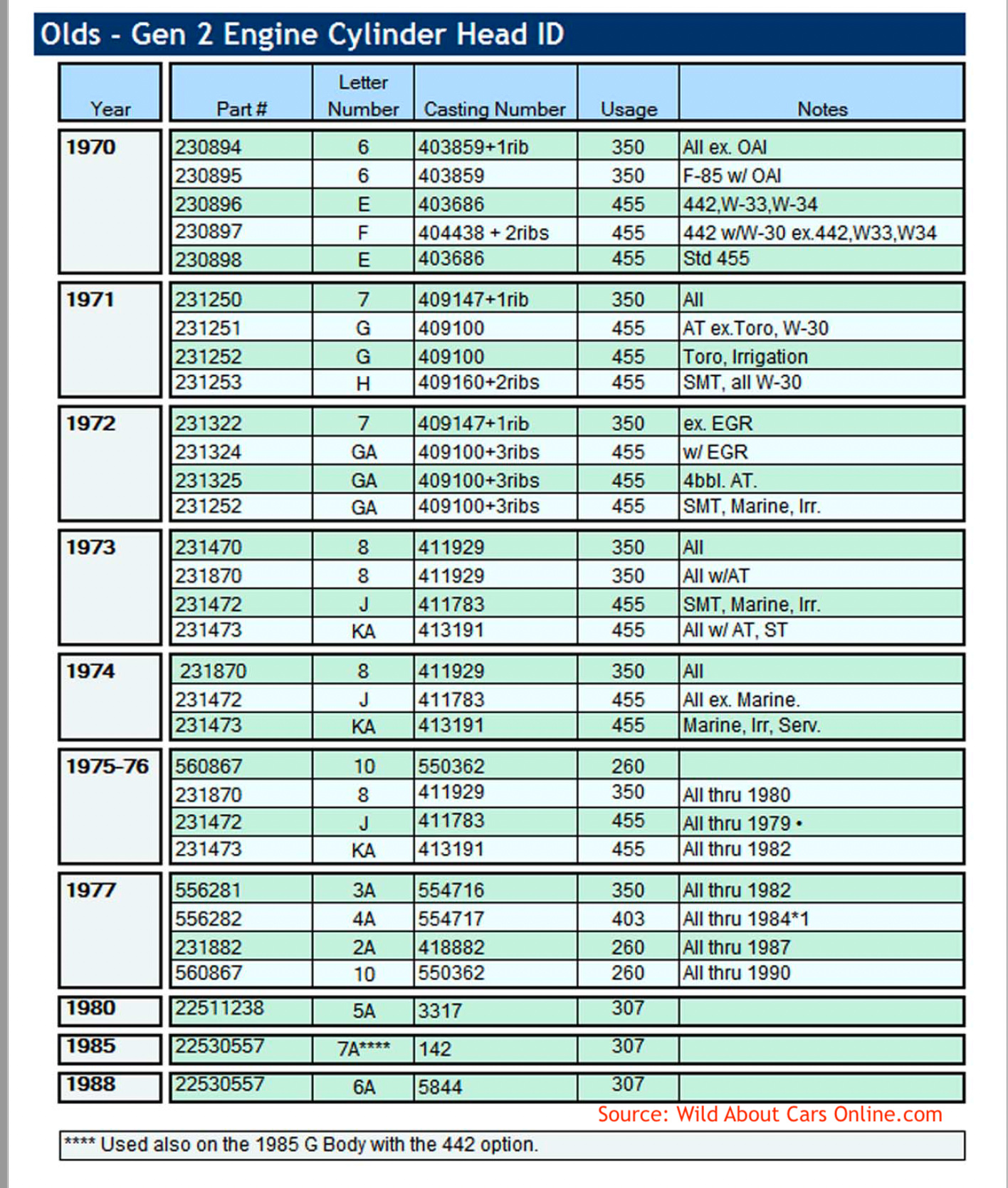

409100? Those should be G heads correct?

Here ya go.....

Those are Gs with a fantastic fake F. Score 1 for JB weld
Old Jun 20, 2022 | 01:51 PM
New2oldsw30's Avatar
Joined: May 2022
Posts: 270
Yep I agree really good fake. Even looks like tge ribs there as well. I was asked to post a picture so I did.
To me it don't really matter. Will port the helloutta whatever they are and probably the original intake unless I go single plane fir tge Sniper install.
