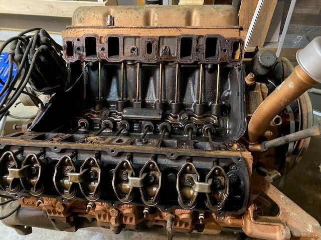

Hi Guys - I bought a '68 400 for $100 at an estate sale. Looks extremely clean yet I feel the need to crack it open and take a look. Supposedly the owner was a local Olds mechanic yet that could be complete bs.
Intake bolts are ugly - i've coated them with penetrator several times and one simply stripped the edges of the bolt. What's the smartest way to break these babies loose without screwing it up ?

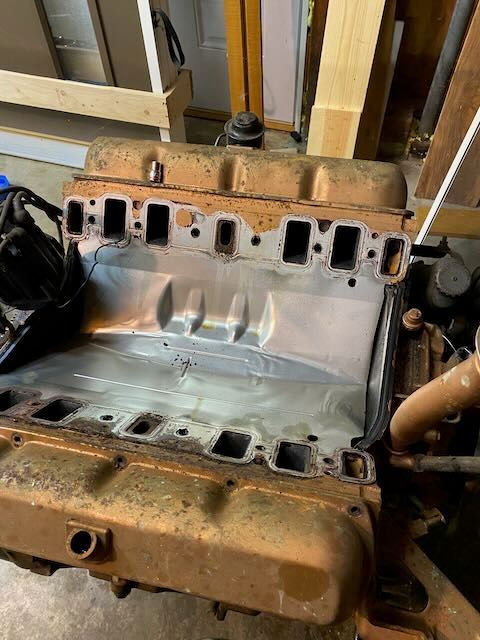

The winner is..... a 6 point socket. To my defense I'm working remotely with a crappy lowes socket set. Once I used a 6 point the bolts barely broke loose before stripping.

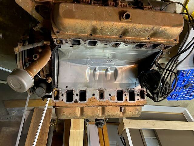

Opened it up a bit more - will post more pics when I have time to pull heads.
From the looks of the pan gasket....somebody was in here soon after this thing was moth balled.

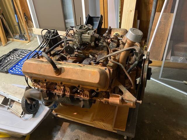

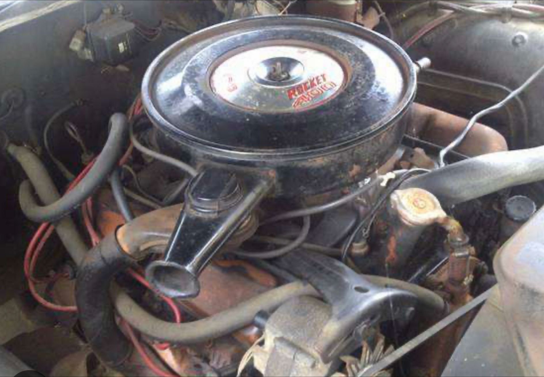

Couple of things of note. First, the curved oil fill tube was only used on A/C cars. The compressor forced the air cleaner snorkel to clock towards the front of the engine, and the curved tube was needed for clearance, however that's a non-A/C alternator bracket. Second, the 400 only came in A-body cars, which means that every one of them left the factory with notched valve covers, which this motor doesn't have, so those have been changed also.
Old Dec 14, 2023 | 04:27 AM
Andy's Avatar
Joined: Jan 2020
Posts: 2,890
From: Sarasota Florida
Joe, I believe that’s a 400 2bbl from a 1968 turnpike cruiser, for unknown reasons turnpike 400 all had the same curved oil fill tube. A couple summers ago my brother and I bought a 68 442 with a curved oil tube and a later model 4 bbl on it. I believe it was Allyolds and I did a bunch of research as that car I bought was a factory turnpike with added 4bbl. Every pic we could find of turnpikes had curved ac tube. The whole convo is on here I believe under cars for sale as I had posted the car on this site to sell.

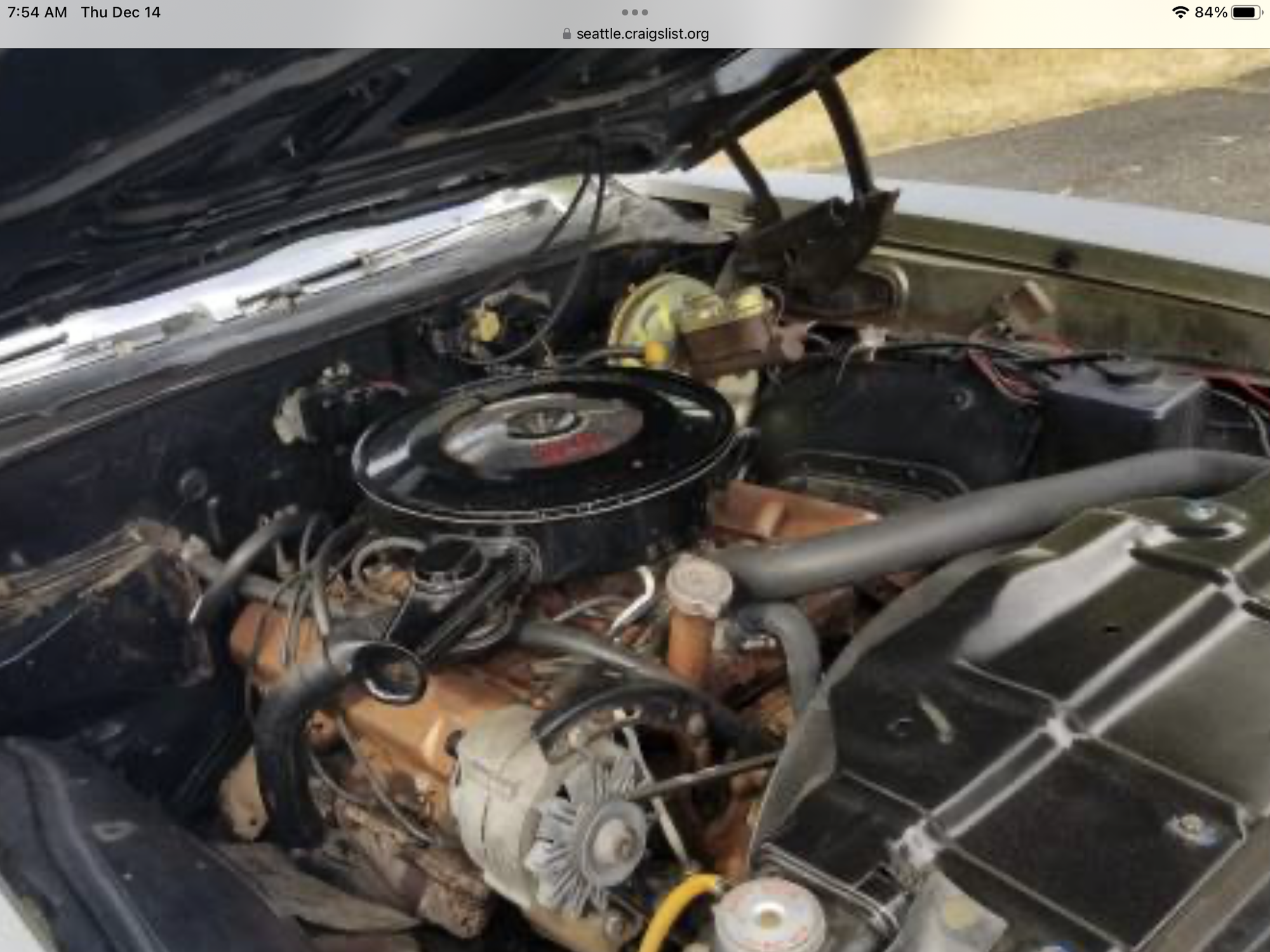

Originally Posted by Andy
That car also has the valve covers on backwards...
Well ok, I have seen many pics online of old cruisers, they all have the curved oil tube. Went to post some but to large of file. Your challenge, Find me one pic of. 68 TPC without a curved tube.

That oil fill tube and cap are not for a '68 400. They look like '67 (and earlier?).

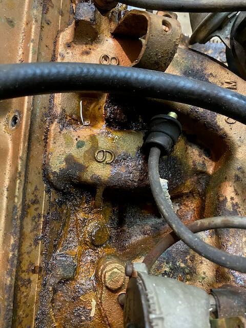

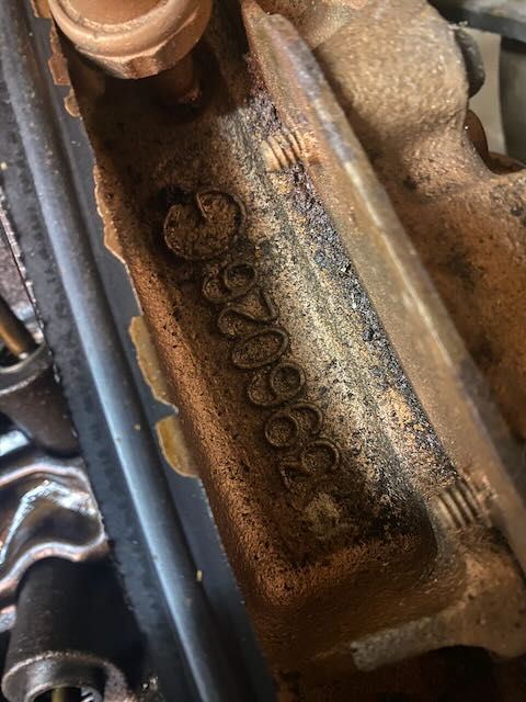

What's the block casting number? See below picture for location of casting number.
the tube is, the cap isn’t
I think you’re right. Here’s a pic of an original. The curved tube is definitely needed here with the a/c
I am with you..Understandably as it has ac, I have yet to find a 68 TPC pic with no ac and a straight oil fill tube, all are curved. The car we had bought was a solid numbers matching car TPC non ac, with a curved tube.

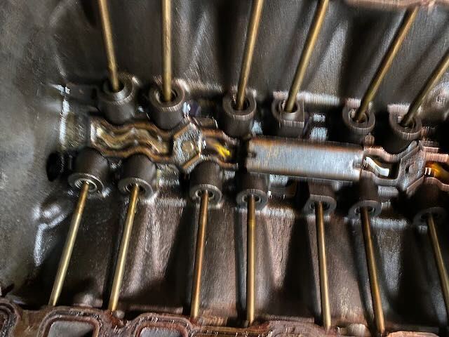

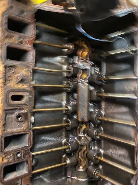

I think I found the reason this thing was moth balled years ago. Passenger side push rods- 3rd from the back - it's got a pretty good bend. I'll dig in deeper when I have time. Someone asked for the casting number - attached.
Thanks
