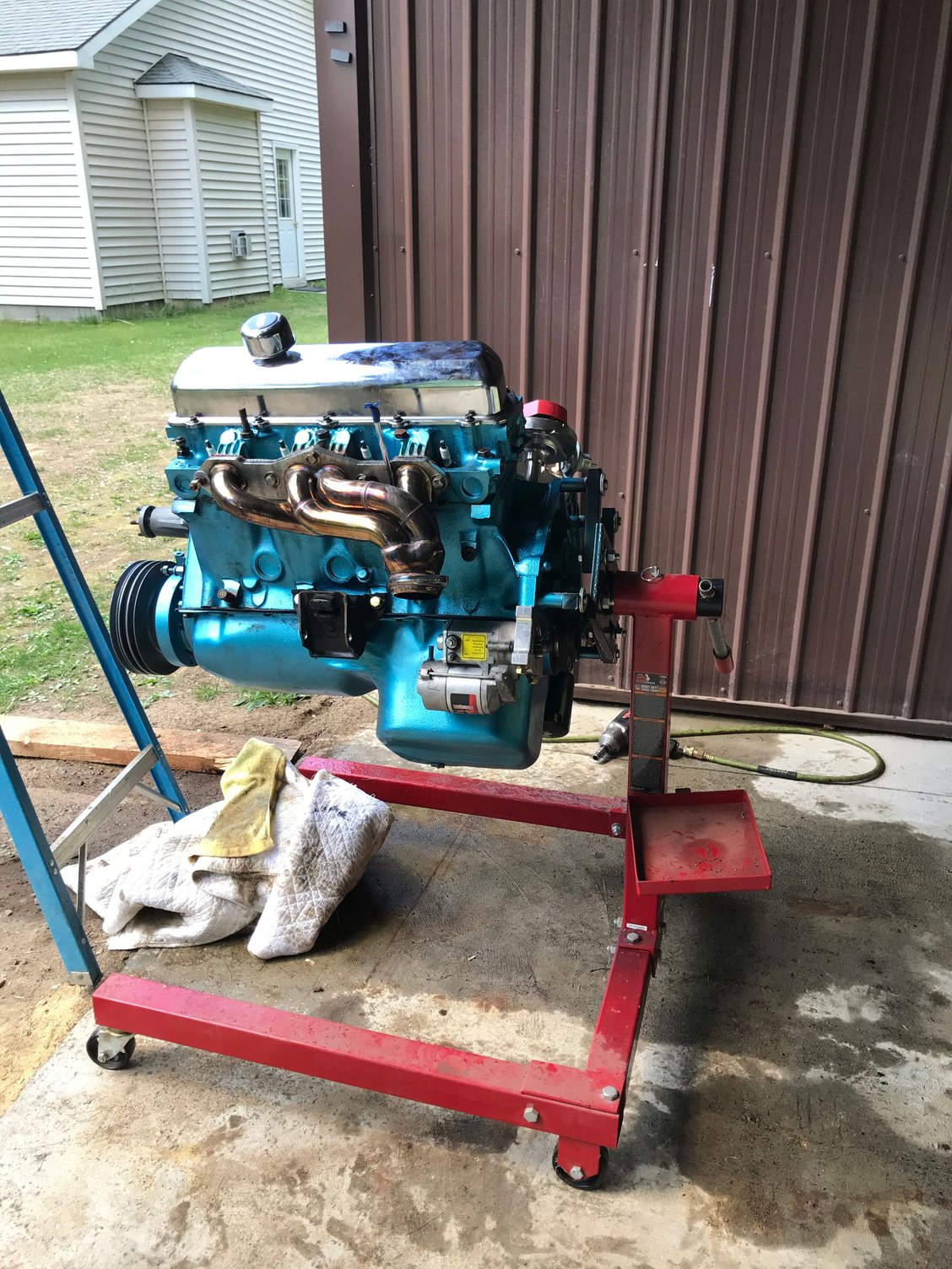

Pulled the motor today to try and get to the bottom of the leaking . Took me 5 hours to get it from inside the car to the engine stand .feel like someone beat the hell out me 😳

Tore things down today to replace the rear main seal. it was installed with lip facing forward but had excessive rtv between the seal and crank surface .there shouldn't be any rtv in that area.There were also parts of the oil pan gasket that we suspect.Got a pretty good look at the cylinder bores and they look good with good cross hatch. Found one of the main bearings wore down to expose some shiny copper in it so that will have to be taken care of.Getting the block side of the seal out and the channel cleaned out was a real challenge because there was plenty of rtv in that channel as well.Got my new oil pan,pick up screen and gasket set today .
