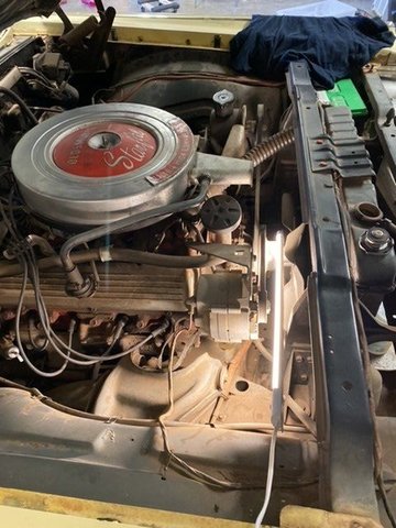

Hi all! Working on my new to me '64 Starfire with 394. Been running well however I think we have some old parts...
I was running yesterday and just as I was getting into the garage I believe the top bleed hose on the radiator broke. For the life of me I cannot find an overflow or anywhere where it may reconnect, and my service manuals don't come until next week but wanted to get her out this weekend. Any help on where this ends up would be great... did these have an overflow tank?
(also, not sure why pictures are improperly rotated...)
Where is anything in here?
Hose location
Old May 29, 2020 | 01:12 PM
Posts: 42,475
It does not go anywhere, its routed along side the radiator to spray the coolant to the ground. If the radiator is filled to the top there is no room for the coolant to expand when it gets hot and it will muscle past the cap. Leave approx. 1.5 inches of head space below the neck to prevent this from happening in the future.
