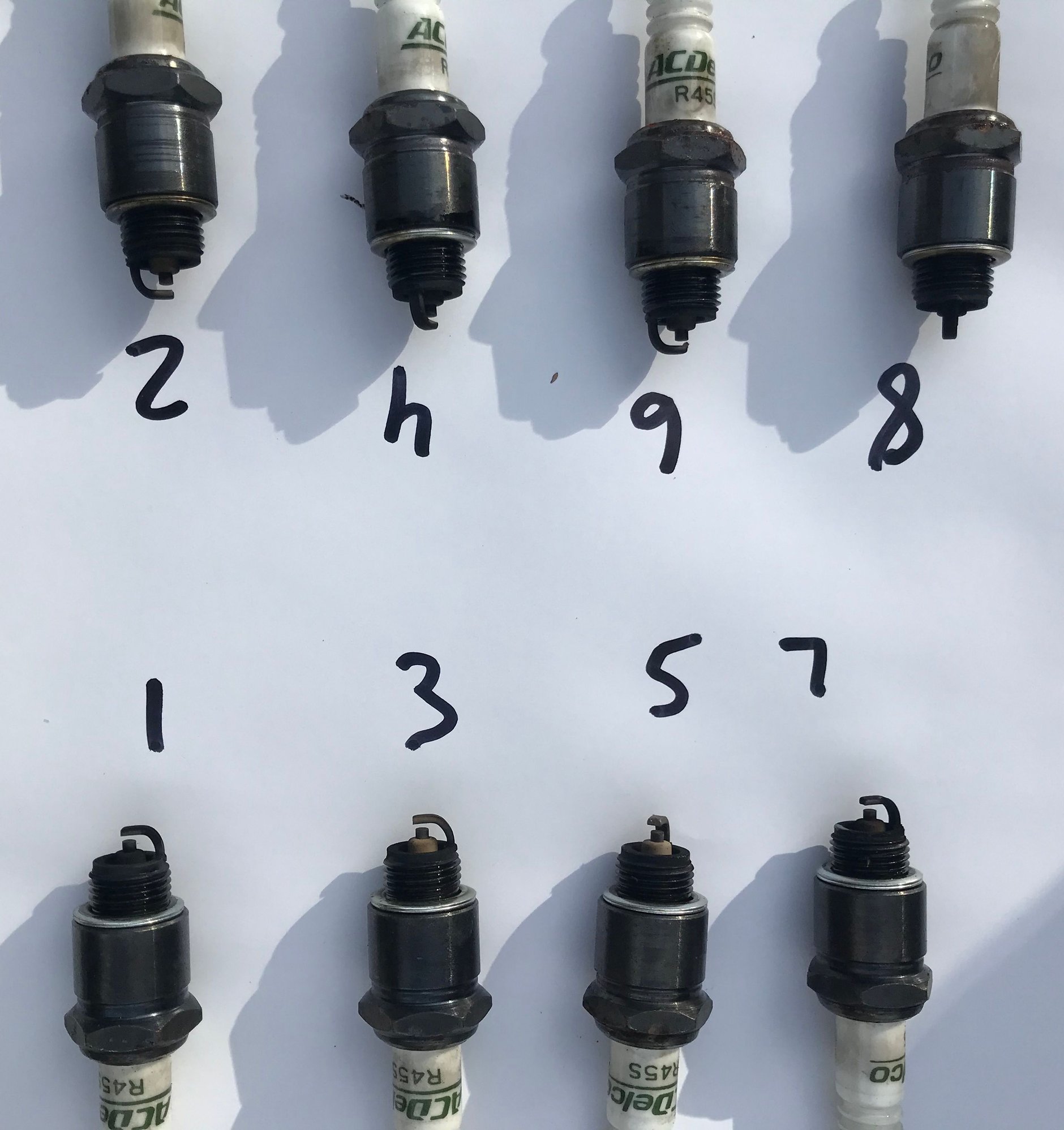

When the plugs are pulled keep them in order and try to read them, sometimes they give indications.

if i have time ill pull the plugs tonight and post pics here .there is no pressure in the oil fill tube at idle so thats something i can check tonight as well

Are the valve covers stock? I'm wondering about a defect in a baffle or vent. Were these valve covers on before the rebuild? Could probably do the glove test on the valve cover ports.
Are plugs 3 and 5 burning well and the rest are rich?
Did the car overheat before the rebuild? Was the rear end ratio changed? Was the radiator changed before or after the rebuild?

Aftermarket chrome valve covers with baffles been on from day one .it does appear that those two plugs are burning better than the rest.i bought the motor to rebuild no idea of its prior history ( it was hot tanked and magnafluxed)I did go from a 273 open rear to a 323 posi .radiator is new summit 4 core aluminum went in with the motor runs about 175 degrees all day

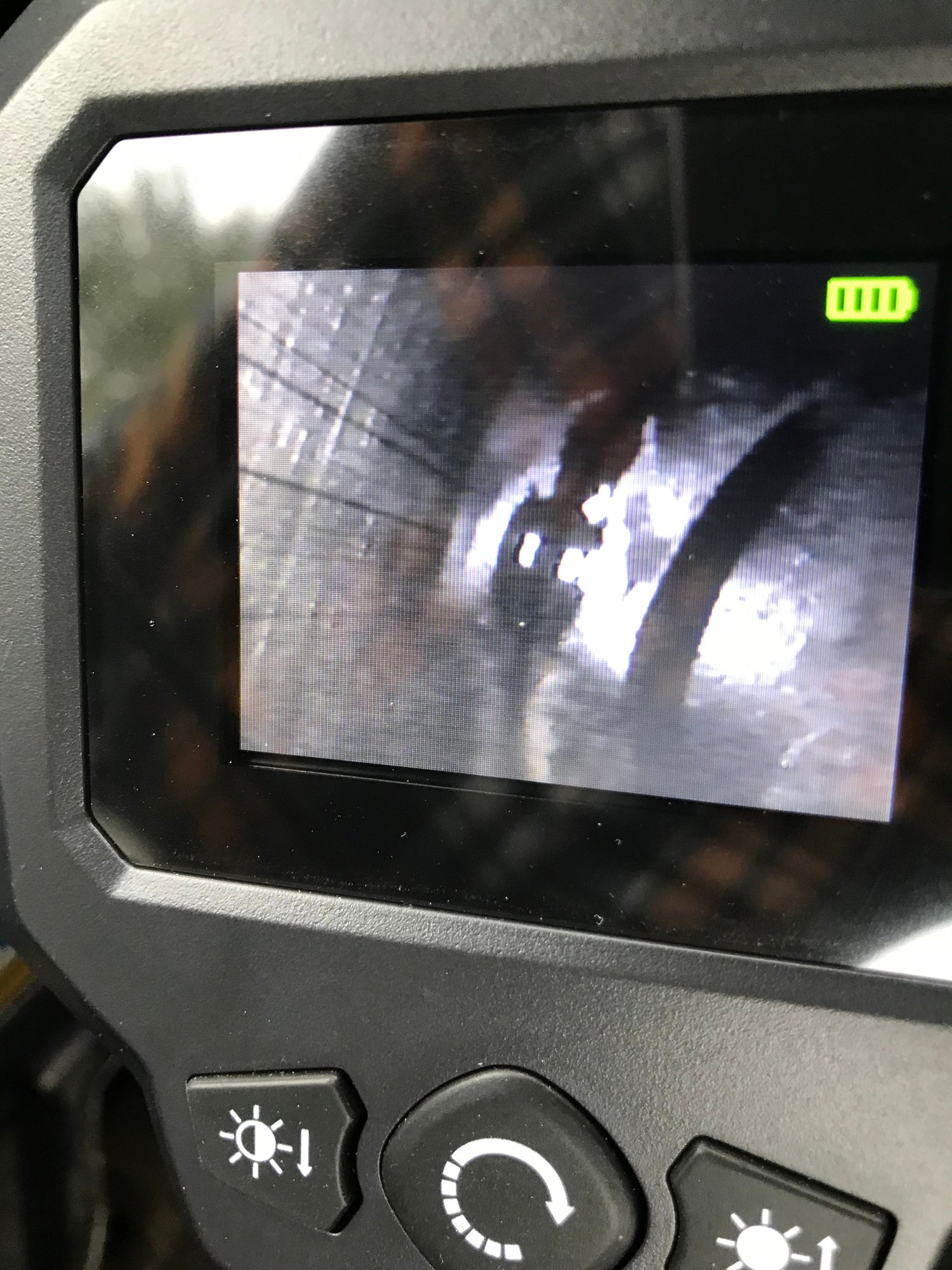

my oil pressure is 40lbs at idle and about 65 cruising .the seal was installed by the machine shop(they do make mistakes) i had quite a lot of run time on this motor before this issue developed .wouldnt an improperly installed oil seal leak from day one? i took this pic from my bore scope and appears there are vertical scratches in the cylinder wall most likely where im getting blow by.Now, i agree this may or may not be the reason for the leaking.In any event looking at this pic the motor will come out sooner than later
Old Apr 10, 2020 | 03:20 PM
deadeyejedi's Avatar
Joined: Sep 2012
Posts: 1,968
From: saratoga springs,n.y
wouldn't load try again
Old Apr 10, 2020 | 03:24 PM
Sugar Bear's Avatar
Posts: 4,098
It would be great if the leak could be identified before pulling the engine. The picture didn't post of the scratches, how bad are they? Need boring or slight/honeable?
Old Apr 10, 2020 | 03:26 PM
Sugar Bear's Avatar
Posts: 4,098
Pic is there. Can you scope another cylinder for comparison and post pic?

i should have done that sugar bear but ive had it for one day. its not the greatest picture. im curious if those lines would show up in another cylinder as well.Ill get back to it tomorrow

Those vertical marks don’t bother me nearly as much as what looks to be a very poor crosshatch. I think a teardown is imminent.

mark I don’t think that picture is telling the story . I remember getting this block back from the machine shop and it having nice crosshatch in all the cylinders . Regardless the motor is coming out when I have time and money to deal with it .does this crosshatch Remain in the cylinder wall well after break in ?
Likely correct. I've seen how a camera (especially with flash) can pick up or exaggerate details that are near-invisible to the eye. Problem is, you're not going to be able to verify without disassembly of the engine.
An engine can retain honing marks for tens of thousands of miles (potentially well over a hundred thousand miles)--but only if the air/fuel ratio is kept correct, (i.e., feedback fuel injection, no carb will meter this precisely) the oil is clean, the engine runs appropriately hot enough, and an overdrive trans helps by bringing the RPM down.
"Washing" the oil off the cylinder by over-fuelling; or running the engine so cold that the cylinder walls don't expand properly and the oil get contaminated with water, will not only allow the honing marks to be removed, you'll wind up with a ridge at the top of the cylinder. The ridge is the original diameter of the cylinder, the "step" below it is material worn-away by the top ring.
The Vortec 5.7L short-block I bought and rebuilt had only 0.0015 wear to the cylinders; and hone marks still on the walls except at the very top of the cylinders. I have to assume the engine had far more than 100,000 miles.

At it again and found something interesting i double checked with a hose to my ear to be sure the leak- by is in fact going into the block and not out the exhaust or intake valves.confirmed. got the engine up to good operating temp and seems to be much better when hot @70lbs of air right gauge showed 66.5 so about 5%leak down while hot so it appears the blow by gets better with heat.yesterday i feel the motor wasn't that warm by the time i did all the compression tests and leak downs but a cooler motor didnt seem to affect the other 7 cylinders.

That is good news. The camera might be distorting the actual condition of the cylinder wall, a comparison to other cylinders with the scope may be the best alternative before pulling apart the engine as it may be fine.
If they all look comparable and the dipstick stays in place, the leak as mentioned by others may be unrelated i.e., a bad seal or mating surface.

i did check some other cylinders and got similar lines and distortion with the scope so im hopeful that cylinder isn't as bad as i first thought, at least not enough to start tearing the motor apart . i will have to address the leaks and in the mean time might as well try the old school break in .
