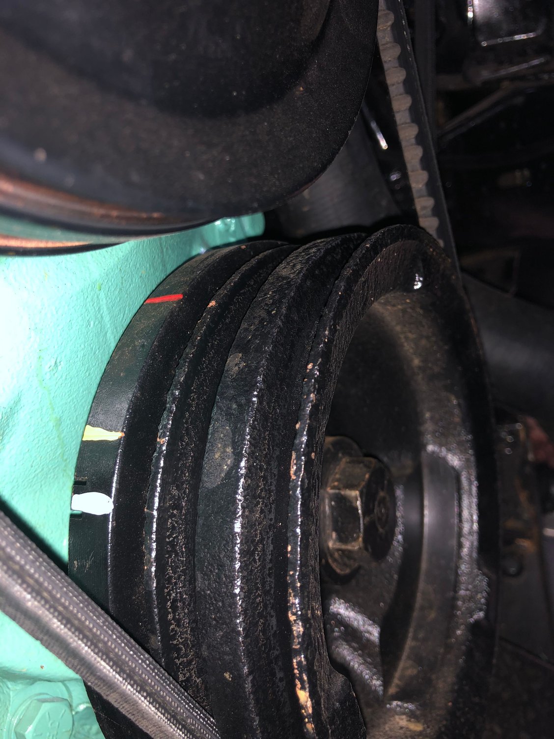

Onto the Timing.
Making progress with the new tools.
I disconnected distributor vacuum and blocked hose and dist. Connection.
Had running @850 rpm.
light is dead on the red mark which is way off the white mark I would think is TDC as it has two saw marks each side of it.
I am thinking yellow mark is 5 deg before TDC according to the book.
Just tested again and now the timing mark is showing about 7-8 degrees before TDC and nowhere near that red mark now.
Any advice on this red mark please?
Old Jul 16, 2023 | 06:33 AM
  #44
Posts: 25,789
John - Sorry, can't help with those marks. I would "think" the white mark (as you noted sits inside the two saw marks) is TDC & I suspect you've checked the manual to validate what the saw marks represent. Someone most likely painted on the yellow & red marks but what they represent I have no clue. I feel for you trying to narrow down this surging issue - like pulling teeth to find the right one, eh? You wouldn't think these 1st gen engines would be so difficult. So many items come into play on this - dwell, timing, carb (float bowls) and I'll mention the distributor itself and the vacuum advance canister.

I read this earlier this morning, including the history of your 394 & Charlie's 394 rebuild. Setting the timing appears modestly straight-forward; however, this member lists some interesting considerations which may provide some insight. Good Luck!
How to Set timing on oldsmobile 1964 98 394Ci

Just a shot in the dark, but could your points be set to close? Your surge could be the difference from a cold distributor lobes at start up and the expansion after warm up. You might have had a change in the gap( slipped) since the first install and be overlooking something simple.... Tedd
Tedd,
yes they were out now Re set with Dwell meter then did the timing again.
