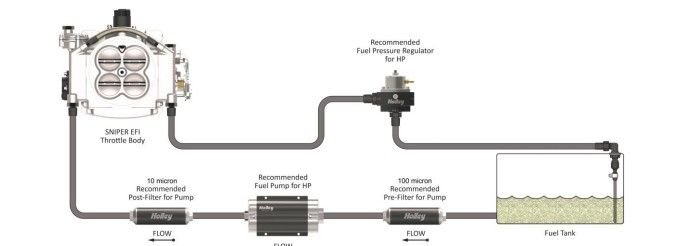

Quick question for those running an external regulator with a sniper 1. Is there any advantage to using a bypass regulator. Or just go with feed side unit? Pros? Cons?
thanks in advance
Pete

To be clear, it already has a return, Removing the Sniper1 internal reulator, I can either run a return from the regulator to the tank and cap and gut the original, or gut the original and put the regulator on the return.
Pete

For the record this is what Holley recommended from the help line. Their reasoning is to maintain cooling of electrical components. As i already have the sniper running with the internal regulator, the supply and return lines are already in place. This is likely the simplest option for me. Gut the original regulator and add a bypass regulator on the return side. I would likely do the corvette regulator if i was starting from scratch. Will advise results.

I didn’t say running an external regular was a bad idea. I said running the bypass off the external regulator is bad because he was going to gut the original reg and CAP the old reg port.
sniper 1 and 2 are designed to cool the internal electronics WITH BYPASS fuel
that’s why both have fuel bypassing through them ALL the time. Holley agrees with me on this
I don’t know how you get through each day without hurting yourself
