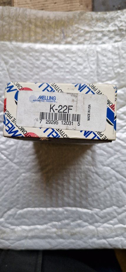

Ok Jim , ordred a nos Melling rebuild kit K-22F because the gears were worn and these stick out a little from the housing. There was a gasket in the Melling kit but it have a little damage of the gears in the box. But it measured 0,3 mm so i think i should try a 0,010" who are close ( 0,25 mm )

I have bolt on the cover with the damage gasket and the gears runs nice and i can also feel
a free play in the gearshaft. I looked in the Olds manual and it says free play of 0,0025" up to 0,0065"
and that should be 0,06 mm to 0,16 mm .
Trying to measure the freeplay in the shaft and it looks like 0,10 mm to 0,15 mm ( 0,0039" to 0,0059" )
so maybe it,s best with a 0,3 mm gasket similar to the one i tested with now so i got clearence.
