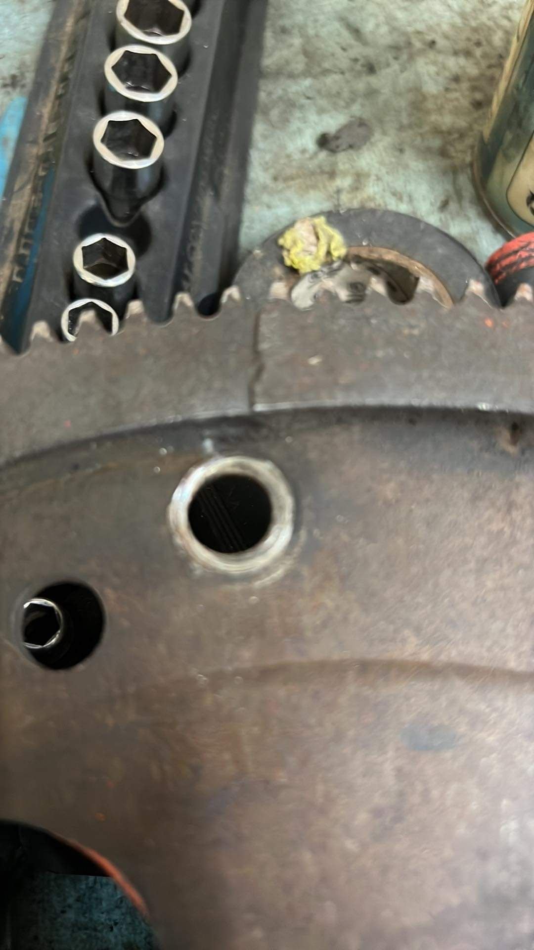

Well after checking a few things turns out it wasn’t the engine making the noise, it was a cracked flex plate.

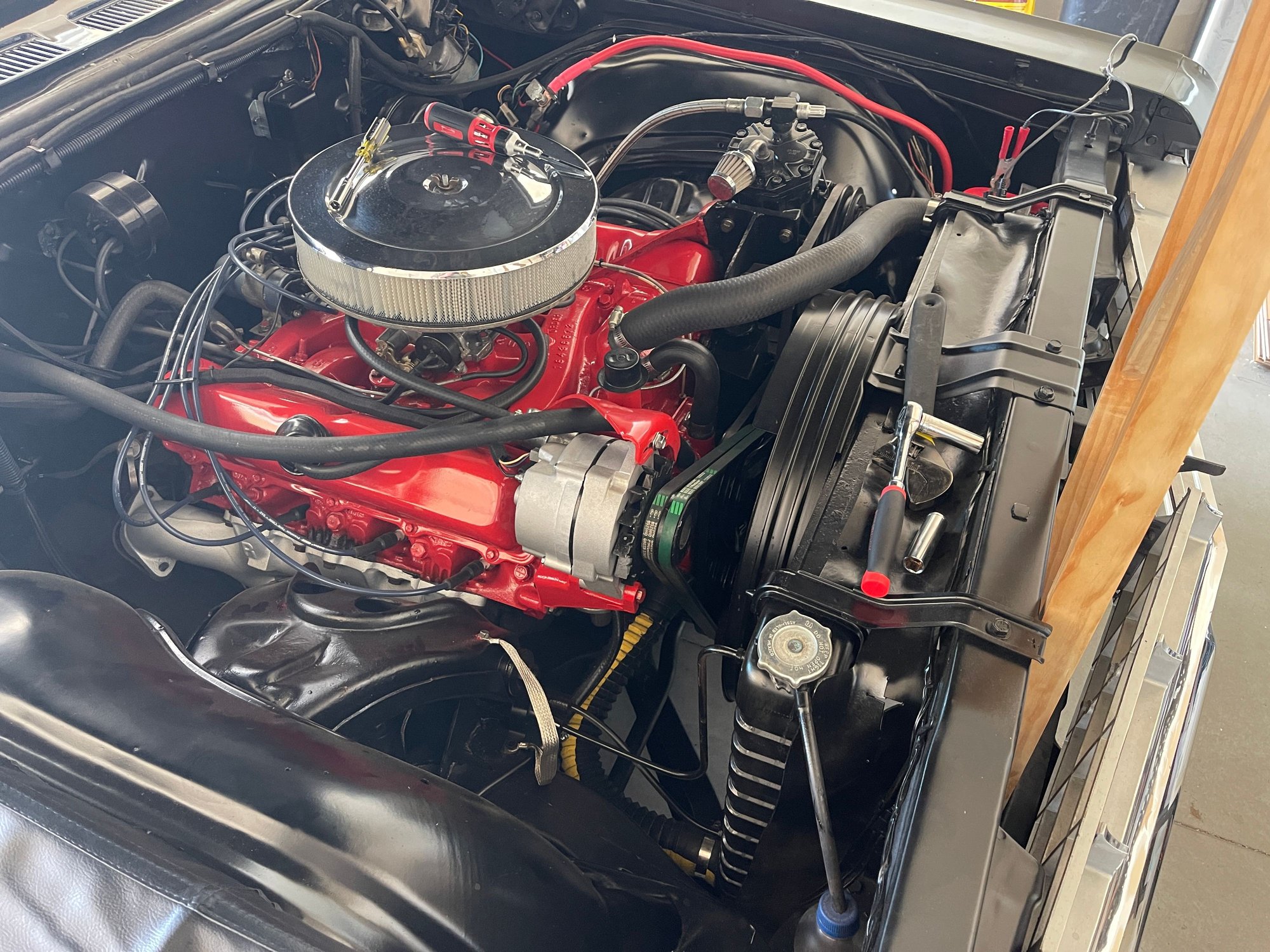

Just curios do you have a fan shroud in your car , looks to be a non ac car like mine.
i do and it is secure, we replaced the flex plate and new lifters are going in today. Lobes on the cam look fine, rockers, springs and push rods are ok. So hopefully this new set of lifters does the trick. 2 of the lifters don’t appear to be letting through the oil like the rest so fingers crossed.
Is it possible to get a picture of the shroud ? i,m very intrested to have one in my car also,
have only the small non ac style now.

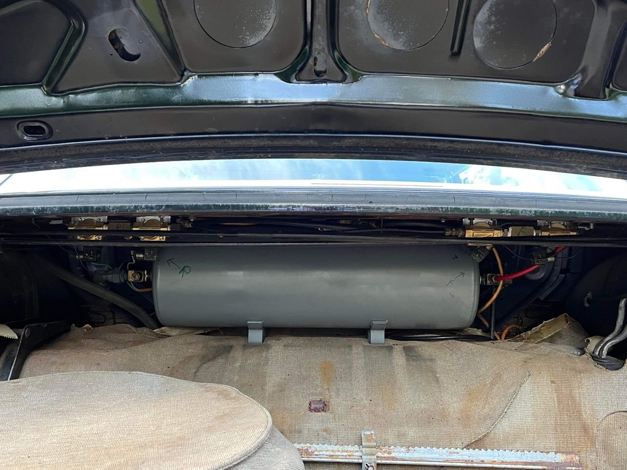

that’s also a compressor for the air ride you see mounted on the right.
Wow what a nice engine compartment Thank you very much , looks to be the same that i have in
my 88 ac car here. But i think it,s very difficult to buy one of these here i Sweden.
Edelbrock ?? Yes i suspected air ride . The whole car is awesome , very nice.

Your car is beautiful , spotless engine bay too ! What/who's red paint did you use for the engine?

your car is a head turner for sure. Looks great, Need more pics please
