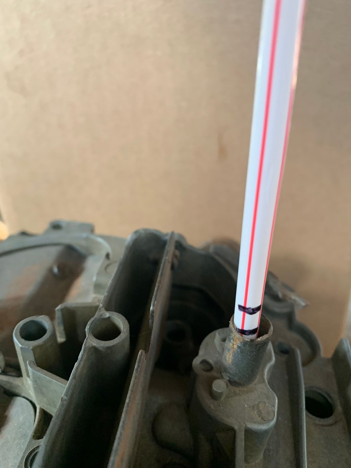

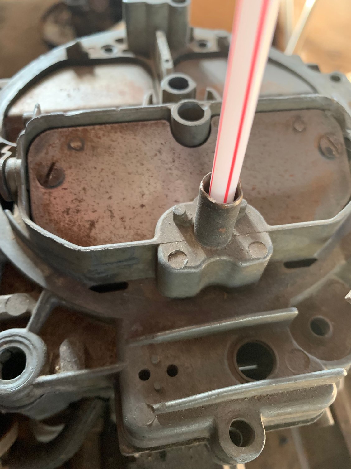

your WOT looks pretty good at mid 12’s so your full throttle afr isn’t your problem. You need to do a full throttle run through all the gears to see if it’s staying between 12.5 and 13
the lean part throttle/cruise can be richened up with a rod change on the primary while keeping the same jets by going to a more aggressive tapered rod while keeping the same tip diameter. If you know what rods are in it now, I can give you a number that will richen up part throttle/cruise.
you can also check to see if your power piston is staying fully seated at idle and not fluttering up and down by inserting a plastic straw down the fuel bowl vent and resting it on top of the power piston. You can check it yourself with engine idling..but needs to be checked in gear idling, which needs two people..have the other person watch the marks on the straw as you drop it in gear…it should stay down.
when you tap the throttle like doing a small brake torque, the straw should rise instantly and drop back down after its back to idle speed.
first make sure your power piston moves up and down freely,, mark the straw at max up and max down positions before starting

Interesting, ill have to see if I can get a helper to test that with the straw. I'm hesitant to do a full throttle pull through the gears due to the detonation, but I do understand the point.
I do not know what's in it unfortunately, but my basic knowledge had me wondering if it just needed to go up a bit on the rods and/or jets.
Based on the fact the idle doesn't return consistently, if I understand the power piston issue correctly I'd think that is a point of contention as well.
