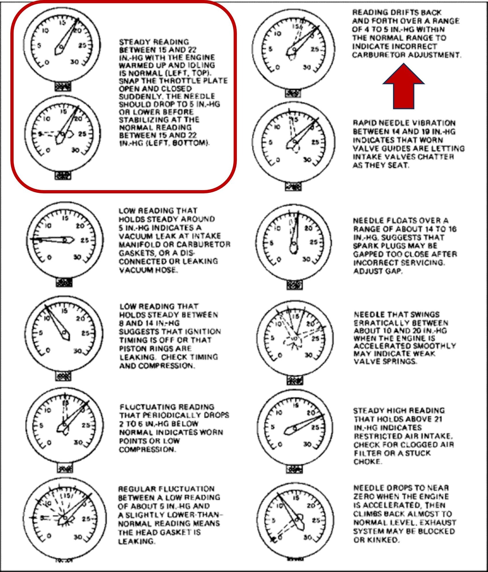

Coincidentally, i did some digging and found how to check the vacuum advance canister via hand pump. It obviously didn't tell me how much it's set to, but it did tell me the diaphragm isn't busted as it held vacuum.
How do I verify how much advance the vacuum advance is producing? I cant trust the spec sheet for the distributor unfortunately.

Hook up your vac pump to the advance unit. Hook up your timing light to number one. Start the engine and at idle using your dial back timing light, dial your timing mark on the damper to tdc and note the degrees on your timing light. Then apply vacuum to the advance unit and dial the mark back to tdc and note the degrees on your light. Subtract the lower number from the higher number and you have the degrees of advance the vac advance unit is capable of.

I've read this thread numerous times. It is absolutely critical without any question of doubt you must be able to perform the test in the upper LH corner of this illustration. If you cannot pass this test, evaluate very specifically why you cannot pass the first test. NOTE: It is critical the vacuum gauge remains "steady" - no bouncing, no jittering about, no loosey goosey, it needs to be rock steady.
Regardless of carburetor, I can give it a quick throttle whack and it will jump about 10hg, bottom out, then return to where it had been (i may have the order backwards, but I know I have verified that before and it checks out..just my numbers are low from the start)
OK. Yes, I provided you the diagram twice in two previous threads. You have so many threads it becomes difficult to ascertain exactly what's happening - it requires researching your threads in hopes to gain some insight. I noted last year in August 2023 you were going to install the wide band. That hasn't happened because evidently you're going to have the shop performing the Dyno install the wide band. I guess that's why it isn't installed yet?
Yeah, it seems like no matter which way I go about it, I end up with the same problem/troubleshooting/etc..ha!
Correct, the idea was when the exhaust was installed, they would be putting the bung in and at that point I'd run it straight from there to the dyno. Between that time, and when the exhaust was put on, I'd switched exhaust shops, committed to buying this new carburetor, and a few other things..followed shortly thereafter by the ball joint failure which took my attention from how it ran to how to ensure it can go down the road safely.
That brings me back to the current goal of, I just want the thing to idle/run like it should, so I can confidently send it to the dyno and know we wont be an unnecessary amount of hours of labor into it on the simple stuff like trying to get it to run.
The wife and I had the conversation last night about all this..and I think my biggest frustration in it all is I've gone through this before and been able to tune it out..but for some reason this is beating me. Whether thats because I'm not allowing myself to go "too far" since it is the numbers matching engine on a car that they made less than 2500 of (and not a run of the mill 318 on a $500 car) or what..but its really wearing on me. I told her she was lucky she and the kid liked it, because I've about hit my limit..ha!

Did the intake to head angle get checked after machining (port matched)?
The angle should be even as in parallel or 0°.
As the heads and block get machined the intake to head interface changes.
The heads and deck height go down toward the block. The intake will now sit higher between the heads.
Whatever amount was shaved off the deck & heads needs to be shaved off the intake to (port) match the new head height & angle.
This can affect performance and in extreme cases cause a major leak as the gasket is no longer effective.
Snap some pictures of the head to intake interface.
Is the low to no vacuum signal steady or does it bounce several inches? Fluctuating as in 5" is a valve(s) not sealing. Steady 1-2" is a leak.
The shop that did the block/machining is not the shop that checked the intake and subsequently built the engine. That concern has been expressed, but the first shop did not document what was milled, so without tearing the entire engine down to measure I don't have a way to account for it. I have considered that though as a viable concern, but if it's leaking it's doing so internally. I do know though just the block was "zero decked", no milling to the heads.
The low vacuum signal has been pretty steady, however with this carburetor it does seem to have a fluctuation of 1-2hg.. but that coincides with any stuttering the engine does.

A dyno session will not fix a vacuum leak, and that's what you have. That engine with that cam should pull a minimum of 15 Hg all day long. Any engine that can only manage 8-9 Hg is not functioning properly. Having apparently performed all the tests possible to identify the source of the leak with the engine assembled, you (somebody -- probably the guy who built it if you're still confident in his abilities) may have to take the intake and heads off, measure everything and re-gasket in order to deal with its source..

The only place it could be leaking is internally. I have heard some say 15hg minimum, I have heard some say 9-12 is about what I should expect. If this debacle hadn't cost me way more than it should have in the first place, I'd be in a better spot to yank it and have it gone through once more. Like I said earlier though, I'm about at my wits end with this..and the kicker is the fact that having 2 shops local who were trustworthy put their hands on this engine and it's still in the state it is..I'm not sure where to go without dumping another few thousand into it.
I'm hopeful that I can get out of work on time and test it again with the changes suggested last night. If that still doesn't seem to trend in the right direction, then it may be time to just shut down and reevaluate some things. The whole premise of this car was to get it out of the barn it was rotting in, drive it around for a couple years, and then find someone better suited to take care of it. So far, I've accomplished the first part, and the second part..maybe the "better suited" is a harsh reality I didn't actually expect to encounter.
