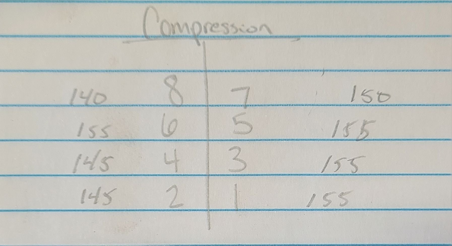

So, I think at this point I'm going to do the compression tests more so as a formality, but I'm strongly leaning toward just pulling the engine. I'm not really set up for it, but either I pull it and have it gone through, or I have more pages of scratching heads and frustration. The more I think on the process, the less confident I am. The engine was "zero decked", and balanced at shop A. Shop A couldn't commit to assembly, so it was taken to shop B. where it was discovered that shop A had missed the fact that rods were bent and the skirts on the cast pistons were hitting the counterweight. So at that point, we moved to different rods/forged pistons but I cant swear that the height was the same. Also at shop B, they cleaned/checked the intake and went ahead and assembled..but I'm not sure they took into account the "zero deck". I've thought about putting the smoke machine on it, but that won't help low compression numbers. Even if it showed a leak, I doubt there will be one visible to make up 4+" of vacuum that I've not already seen.
If I for sure go that route, I know I'm not taking it to either place that's already had their hands in it.
Not sure if you know this.. Pull the coil wire and make sure to have your throttle opened 100% to get a accurate reading.

Originally Posted by 66_Jetstar
This is a bold move. You're adamant that its a carb issue as the motor runs fine with the other carb, but now you wanna pull the motor and inspect everything? Is there more to this story?
Compression lower than it should be, vacuum lower than it should be. Unable to verify things were done correctly at the machine shop, which could be the culprit of both the compression and vacuum issues.
I think the carb has a little to do with the bouncing of the needle (more than usual) and probably the slight detonation, but that's about as much as I'd pin on the carb.
Old Oct 17, 2024 | 08:26 AM
Yes, hard to imagine you'd be having detonation issues with those compression numbers unless timing is thoroughly FUBAR or carb is very, very lean.
The builder unfortunately has plenty of reasons to be suspect about, not just pertaining to this engine. He installed the distributor 180 degrees out (A), He did NOT degree the cam, beyond that swore that degreeing a cam wasn't necessary (B), they charged me for break-in and pulls on the dyno, as well as a carb rebuild..but claimed they "didn't have time" and only broke the cam in using a "shop carb" (C)
I'm not blaming the assembly shop for the machine work, and while it would've made sense for them to check the intake wasn't going to be a problem, I unfortunately can see it being an oversight if they didn't do the machine work.
As for the cam, I have heard both this is "too much cam" and that this cam "provides plenty of vacuum". Usually the "plenty of vacuum" supporters are those who've run this cam. I'm not opposed to it, but I know if I'm going through the work of changing cams, I'm going to verify the block and intake issues at the same time.
dont listen to the uneducated…it’s a mechanical issue. even your highest compression reading is a poor one.
I said this right from the start..it’s got **** poor static compression, probably awful quench distance and a cam that’s not advanced enough.
pull it and we’ll walk you through checking everything out. hopefully you’ll listen.
another thing I would like to know is how fast the needle on the compression gauge goes to on the first and second hit ? that’ll tell you if your ring seal is good. mine get to 85 or 90% on the first hit on basic builds … If yours is taking 4 or 5 kits to reach that poor number..you also have ring seal problems
video the gauge when you do the test and post it
IIRC, the needle jumped after 2, maybe 3 rotations. The cam was something like 20° retarded at the time, and like I said I've not tested since. Not sure if that much difference can be made up in that instance, but I am for sure curious.
The guy that works on our trucks & trailers at work also brought up the smoke machine idea and the leak down test. He doesn't have the smoke machine, but does have a leak down tester. I know you can get machines online for pretty cheap, but I struggle to see how you'd see smoke if it's leaking internally.

Do the new compression test and go from there, 20 degrees more advance should bump compression a lot. If it is still low, then leak down test. Do it step by step till it fails the tests.

Well, bronchitis hit the house pretty hard last night..so we've been kind of a mess today. I did go out and get the cold compression test done. There was some improvement in most, but cyl 6 & 8 still leave some questions.
I think the best thing to do is just walk away for a bit. Unfortunately, its probably best to yank it and have it gone through, but I've lost enough sleep/energy trying to find an alternative.
Below are old vs new numbers for reference.

Well, at least in terms of consistency, now it's worse. Biggest discrepancy before was 15 lbs ... now it's 25, followed by 20.
when you do the compression test again, post a video of the gauge as you’re cranking it
