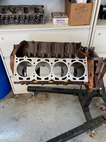

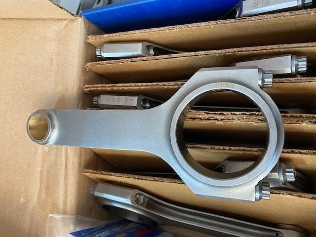

Building this one for another Olds customer.
1970 .030 455 Block. Line bored, .honed, cam plugs, .010 polished crank, Eagle Rods, SRP Pistons (I'll try to provide specs on pistons and cams later), "C" heads, bowl ported, 2.075 Intake and 1.78 Exhaust Ferrea valves, Competition valve springs setup for roller cam, Howards, roller cam, 4/7 swap, Howards roller lifters, new pushrods, screw in studs, Comp roller tip 1.6 rocker arms, W30 aluminum intake (repop), W30 exhaust manifolds, Dick Miller Q-Jet build to match combo.

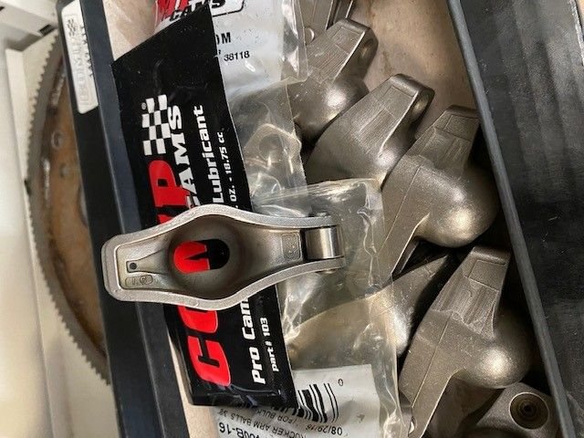

You do realize that rocker is at its limits with the spring pressures needed for a roller cam correct?

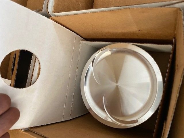

And I’m guessing the piston is really a CP and the ex valve is a 1.68? That’s what they look like anyway. Thank you for the build outline!

No I did not. That's a good point. Thanks for pointing that out. Yes, typo on exhaust valve. Didn't know the piston was a CP either. Going to check everything here as I go, as all of my prior Olds build have been very stock. Thanks for the feedback.

The pistons say SRP, but maybe they are rebranded.

but I have sort of the same / bigger set up. I had to go with the bigger/ gold rocker arms. Barely fit under the valve cover too
