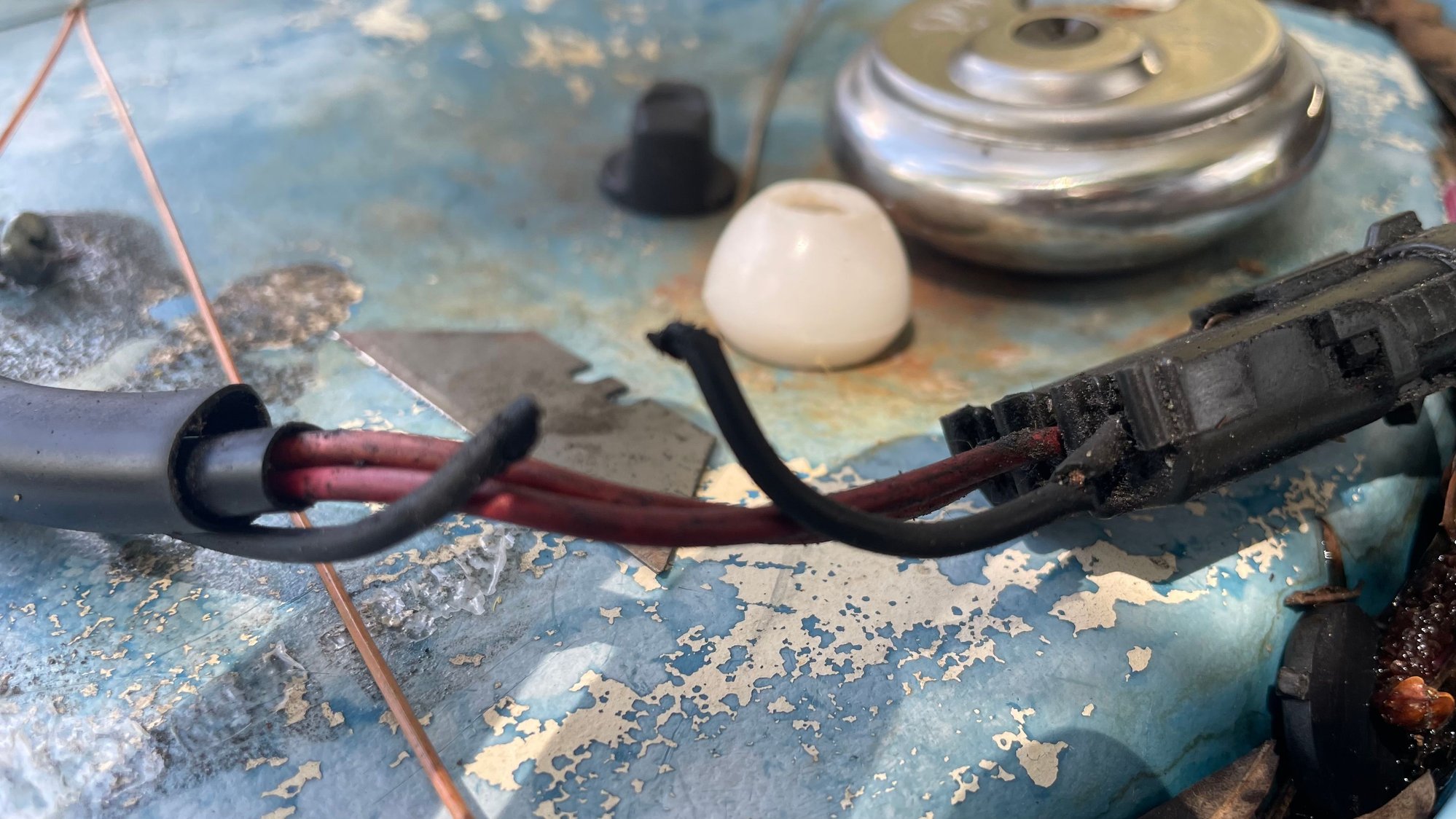

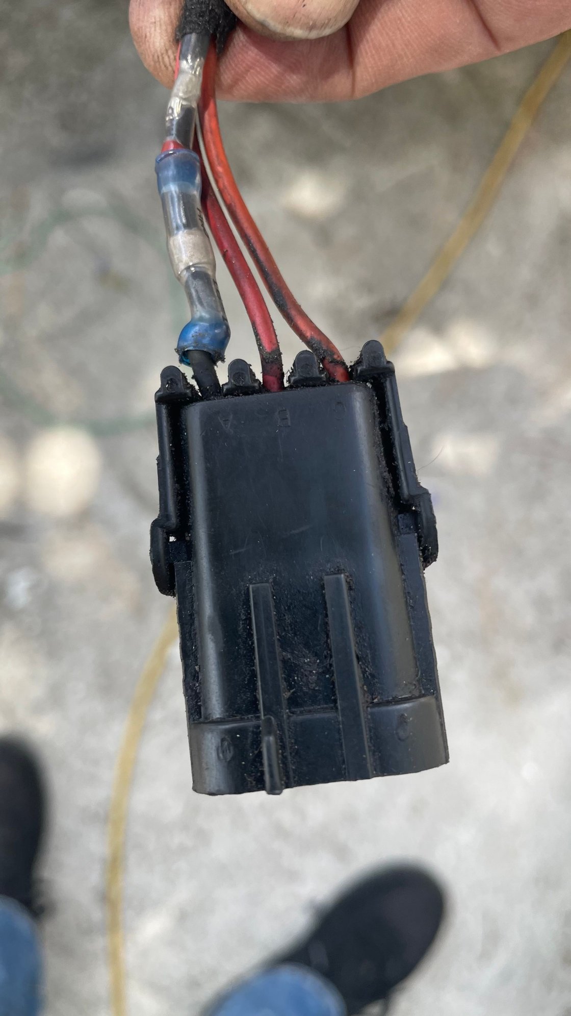

Thank you everyone. Turns out a rat ate the ground wire on the MSD distributor. AQ little challenging to find because the wire was under the distributor and difficult to see where it was nibbled. Did a quick repair and now car starts fine…. Will order a new one this week.
