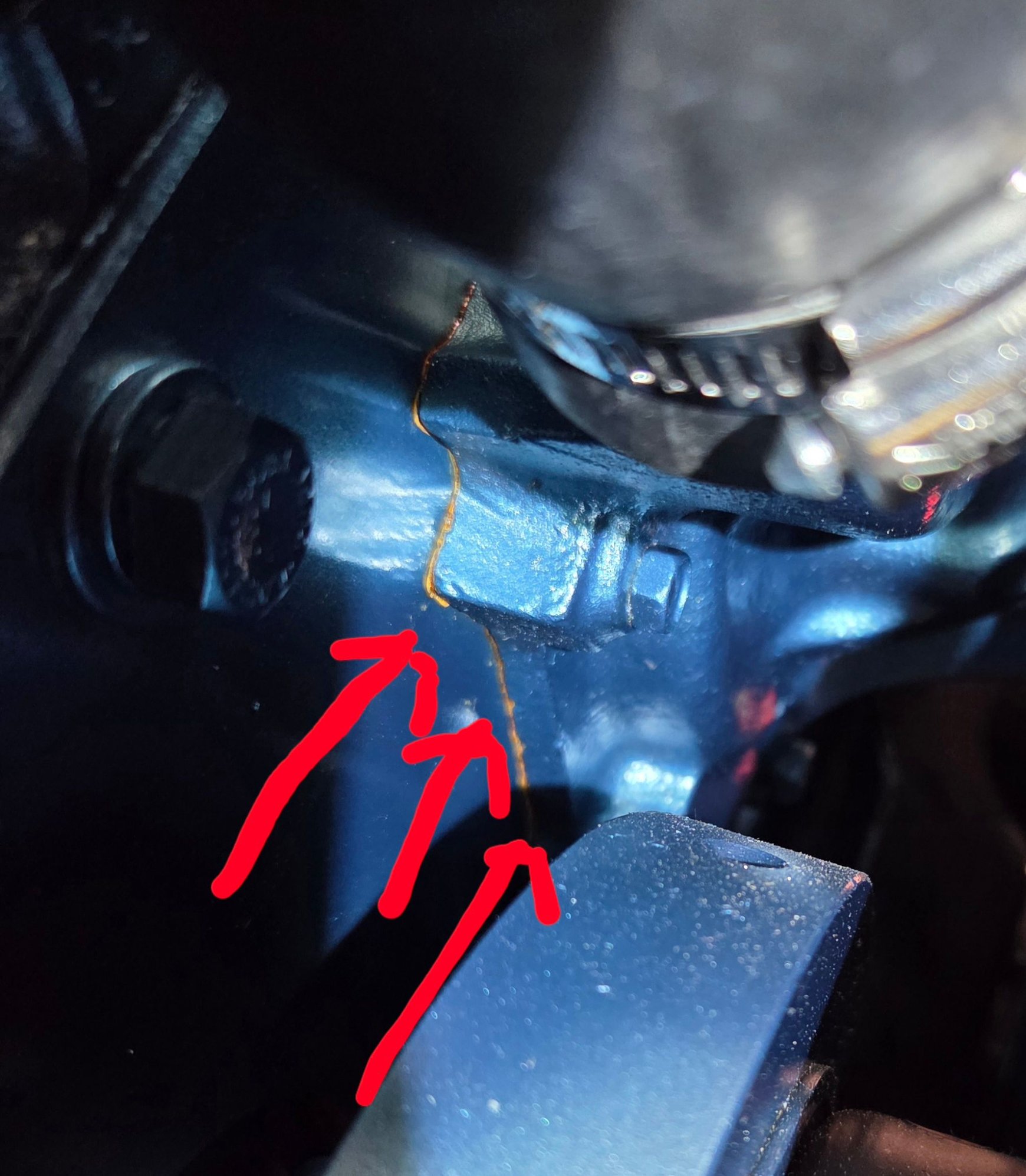

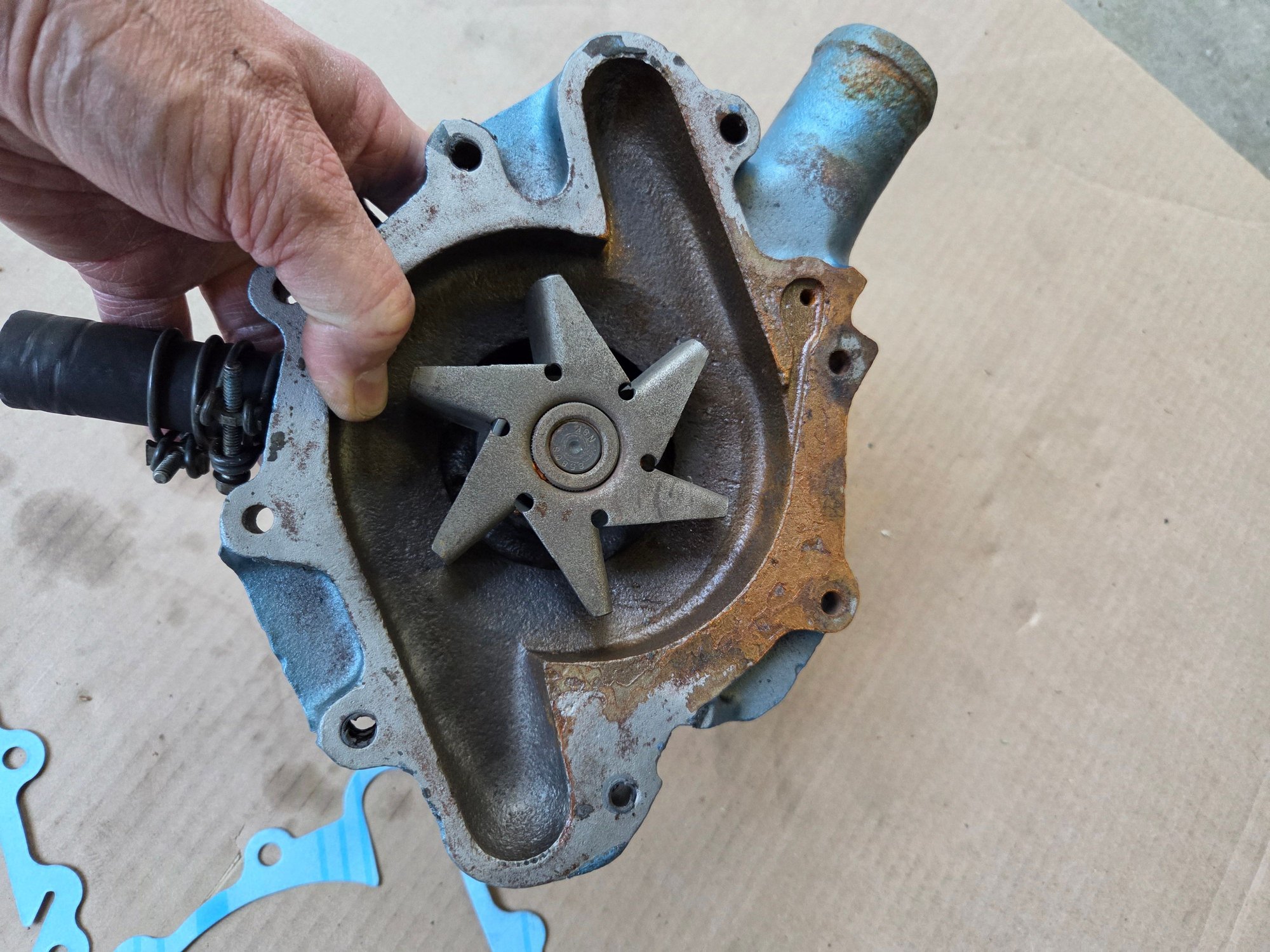

Old school Chebbie guy assembling first Olds. Have had trouble on other threads, now it's a water leak. Engine is in and all hooked up - I always do a straight water fill for the initial start just in case of an issue (coolant is soo much messier right?) I don't even get a full gallon in and already hear it hitting the floor. The leak is big and is along the bottom of the water pump in 3 lines. Pouring out like the pump isn't touching the timing cover. See pics. Dont know how this is possible, all bolts in and tight, the little ones aren't stripped out, all surfaces were super clean, pump was working fine before tear down...did I miss something obvious?

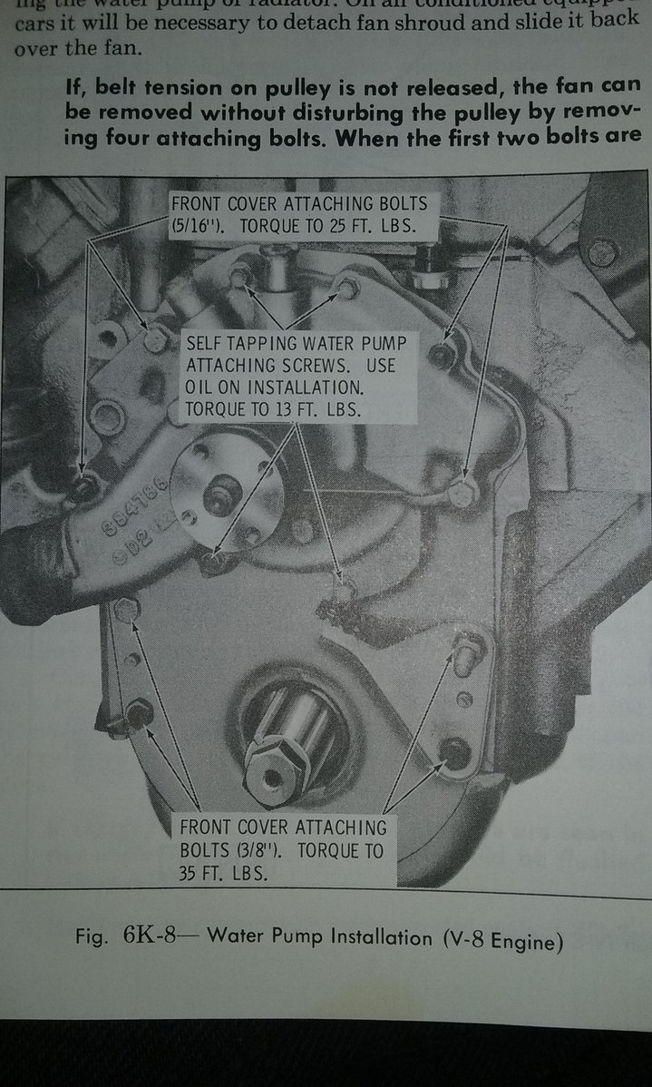

Also be very careful with those self-tapping 1/4-20 fasteners. They only thread into the sheet metal front cover and are very easy to strip. Use the factory recommended torques.

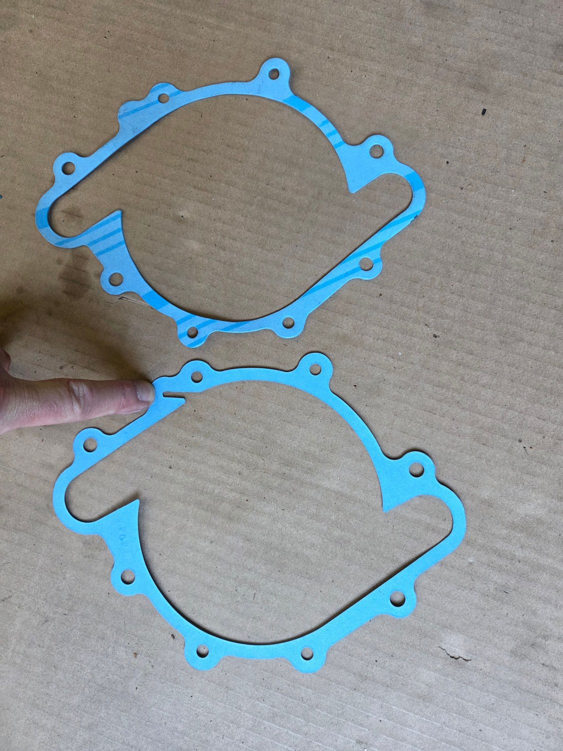

So these 2 gaskets are very similar - only diff is this slot. Which one works better? I haven't cleaned up the pump surface but both gaskets line up nicely.
Old Apr 16, 2026 | 03:30 PM
Posts: 50,626
The one with the slot is for this bleed hole on your water pump. Just fit it up and be sure it completely covers the sealing surface. I'm not sure it does.

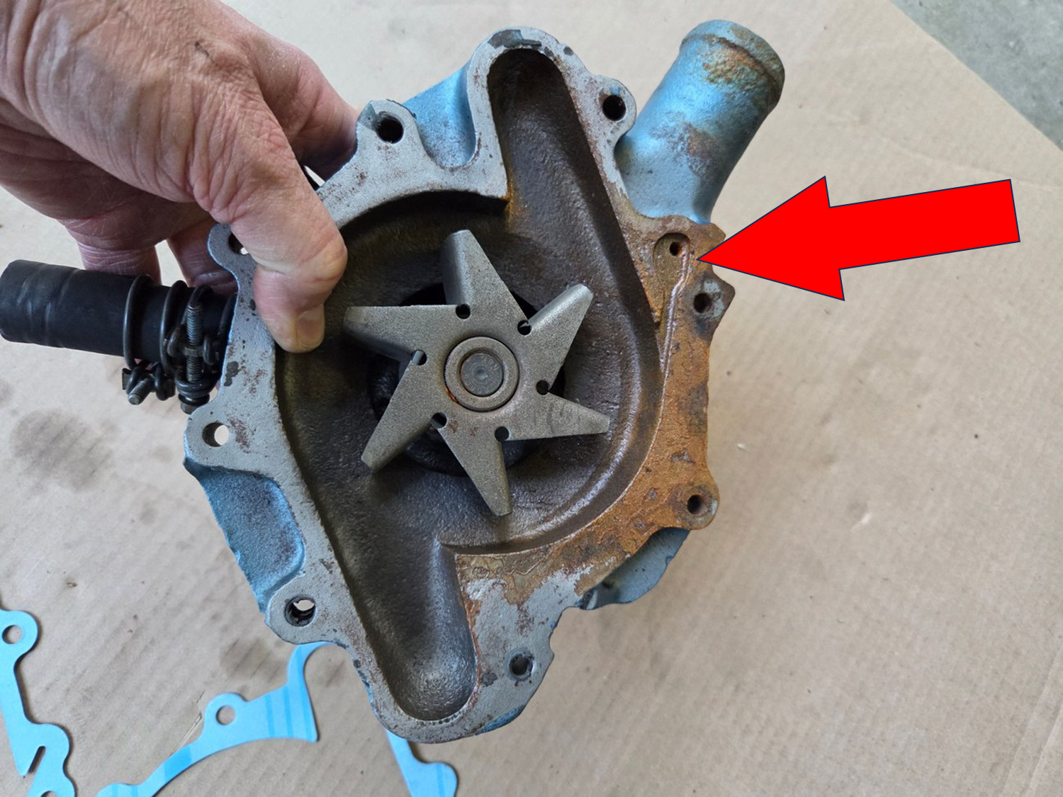

Ok so on close inspection BOTH of these gaskets are wrong. Each has 2 small places where the paper drifts off the pump casting. (Like suggested above) perhaps my pump is wrong for my car? Casting 412265 and my car does have AC
When I did the 307 in my Wifes car a few years ago I had to go through 3 different pumps from different manufacturers to get one that matched the original. I ended up with a GMB and it has been fine. And if I remember correctly I had problems with the gasket matching also. Especially around the bypass area.

Previous owner installed the pump with great stuff and no gasket material. BTW I noticed the lower rad hose is too big for the pump outlet and had 2 clamps and sealant when I tore it down
Old Yesterday | 06:16 AM
Posts: 50,626
And HERE's the issue. 1970-older pumps use a 2.0" inlet (and a 1.75" outlet at the bottom of the radiator). 1971-up pumps use a 1.75" inlet (with a 1.5" outlet on the radiator). Obviously you have the late style pump and an early hose. Try VICTOR REINZ 711397400.

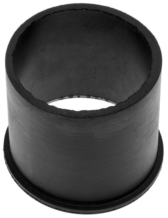

And to fix the half-fast hose attachment, use a 2.0" to 1.75" reducer bushing. Gates P/N 26392.

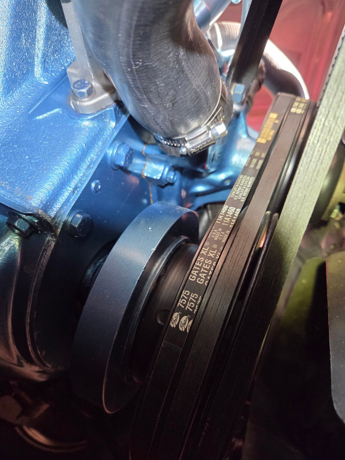

The 404847 pump would solve a couple of other issues, like the mismatch lower hose size and the pulley alignment. Turns out my current pump has a 6.0" height and I need the 5.6. Has anyone had a good experience with the reproduction pump?

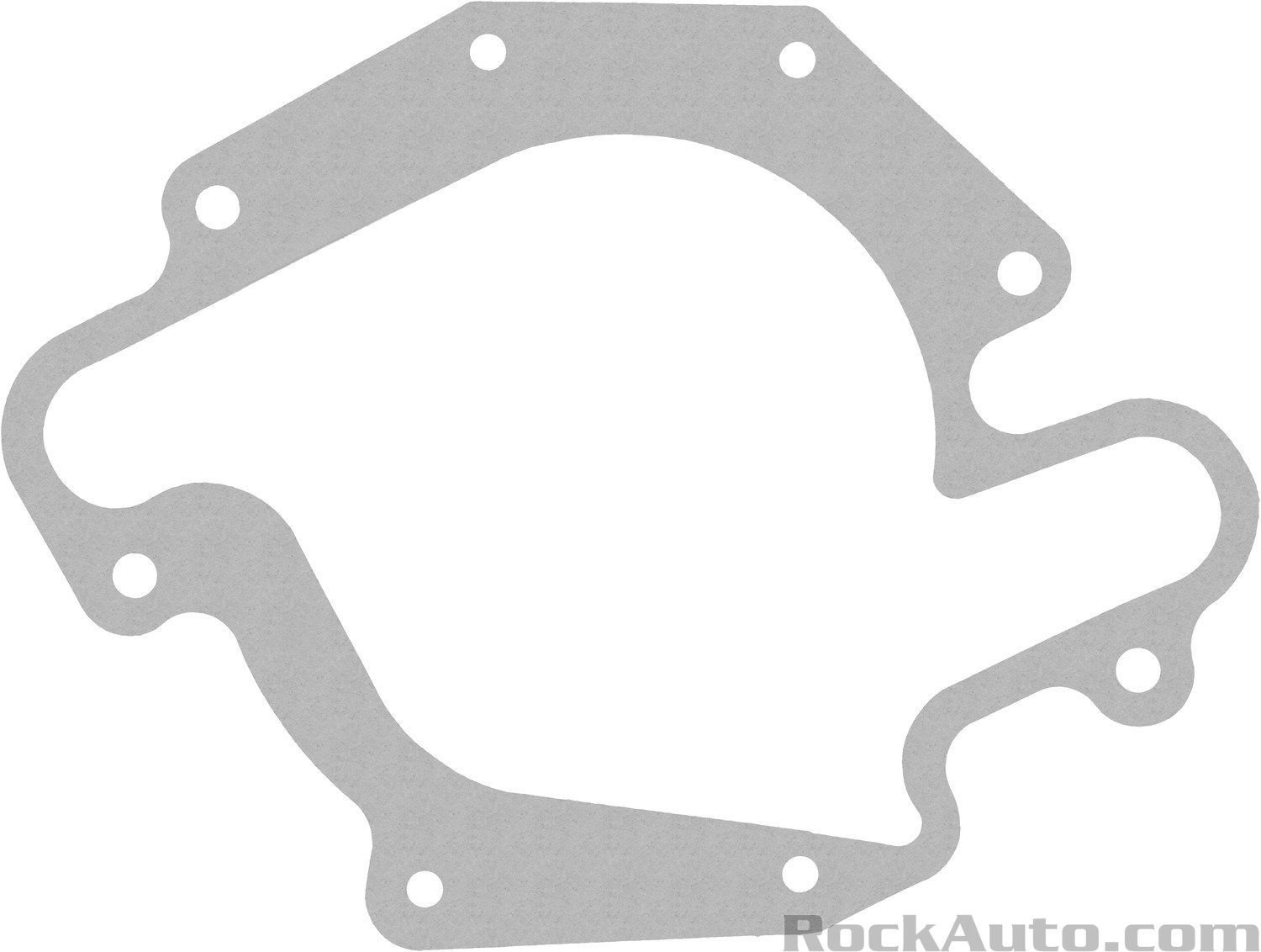

It makes me wonder why the factory used the larger outlet then shrunk it down. I find the gasket pictured us always the right one but I only have the 6" long A/C pumps in standard rotation, probably have 5 of them. One is a factory closed impeller cast iron pump. I have one of the riveted plate on open impeller Flowkooler aluminum pumps, does nothing positive for cooling but has not failed in 15 years. I bought the second to last Flowkooler reverse rotation V6 diesel water pump with their billet closed impeller, very nice, probably helps. It fits much tighter than the smaller open impeller. With a 455, I would go closed impeller, since they tend to run on the warm side.
