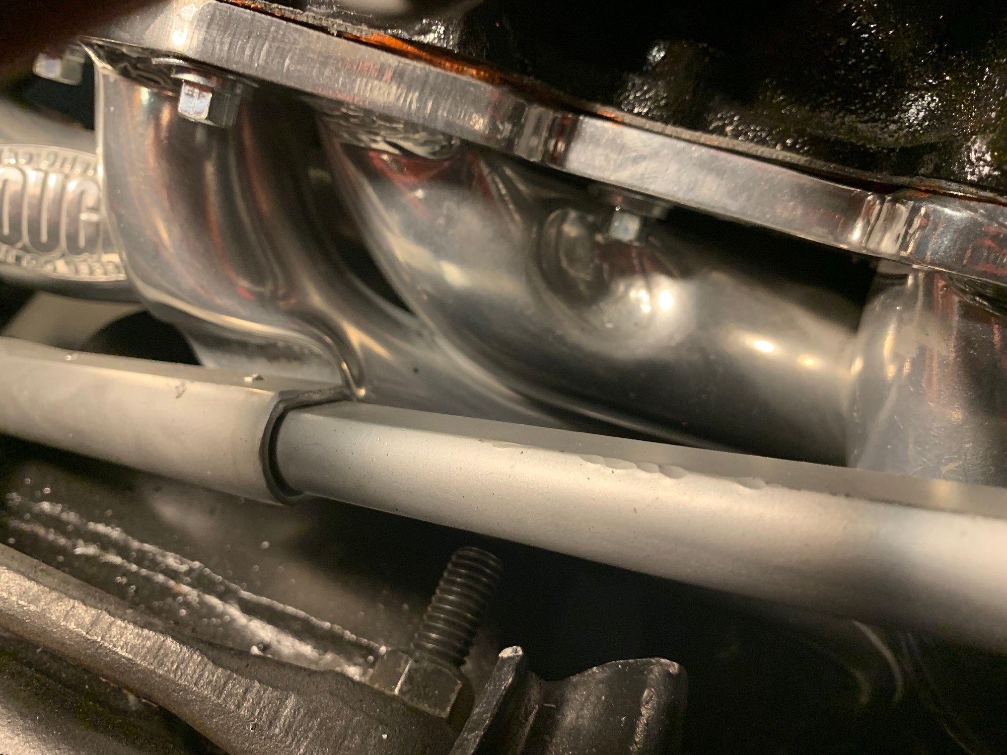

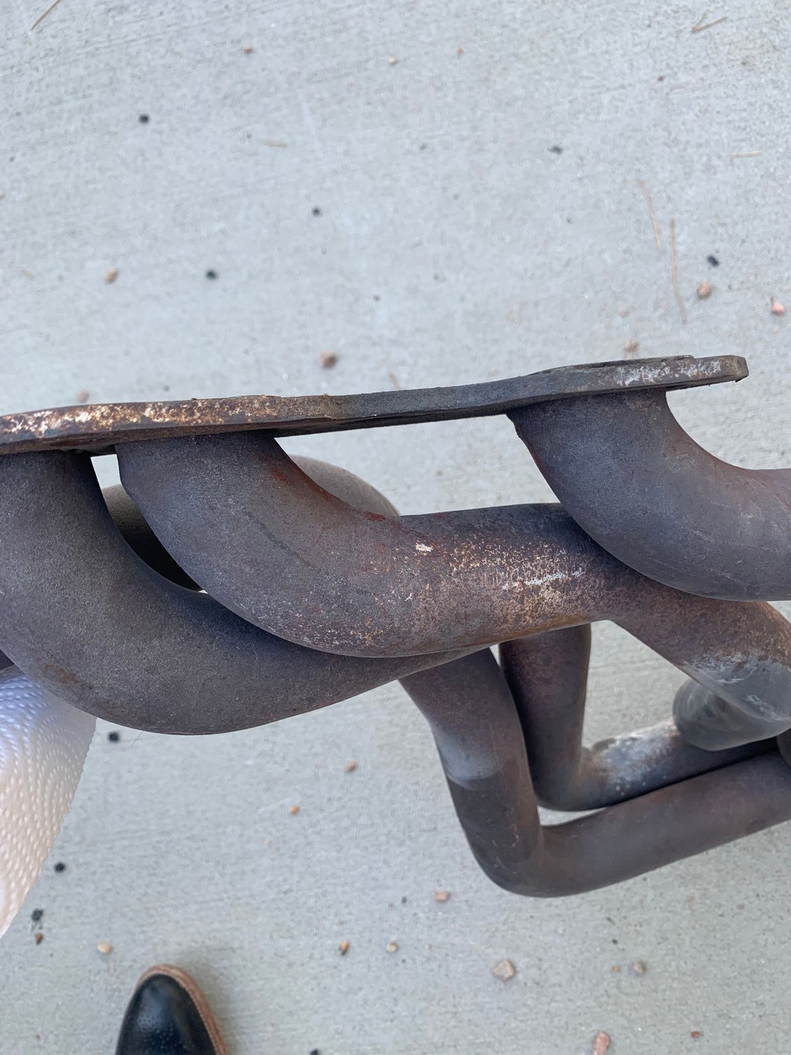

Here are the two different sets of headers. The first picture are the Doug’s 1 7/8” and you can see how tightly packed the tubes are. The second picture is the old headers which were only 1 5/8”. Plenty a room to fit the dipstick on those

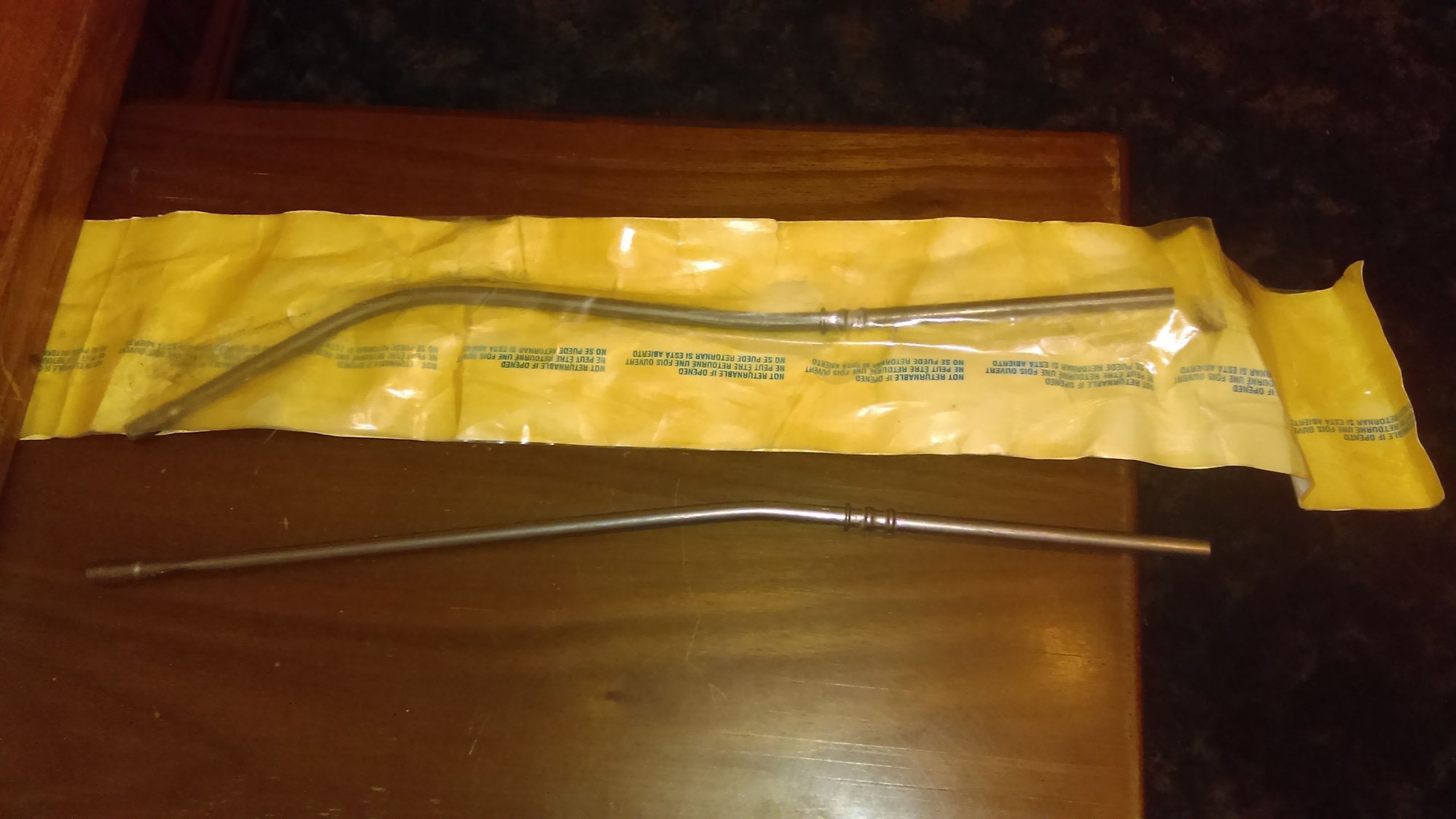

Here are two OEM options available:

These are not aftermarket, they are OEM Factory NOS guides... The ones in the photo are for big blocks... The one in the wrapper is for 74/75 455 (Part Number 417091) and the other one is for 68/69 400 and 69/73 455 (Part Number 401357)... I do not have the matching oil indicators... I do have some available for sale, but I can not guarantee either one will solve your problem... You can use the part numbers provided to see what is available aftermarket...

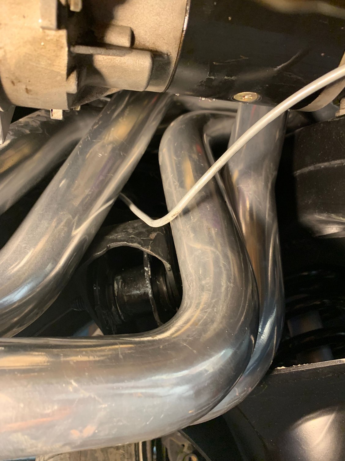

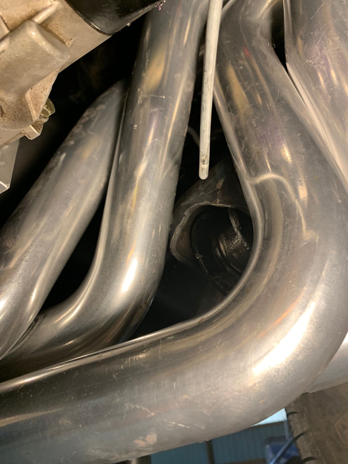

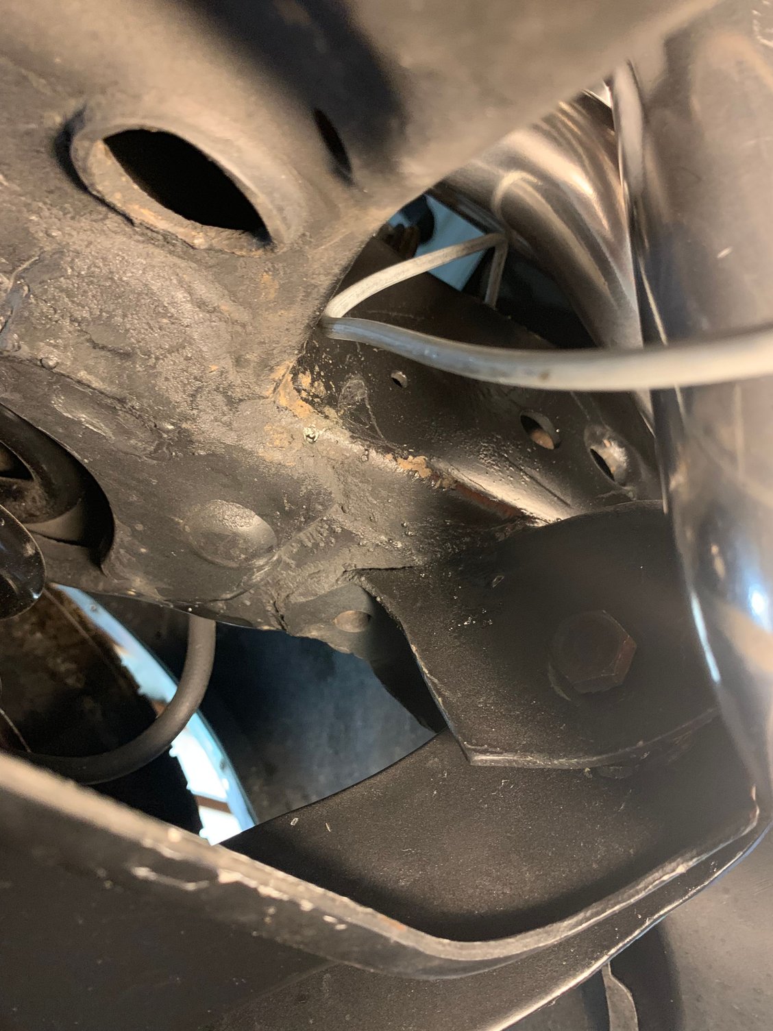

First 3 pics are drivers side. Last pic is passenger. Brake line is brand new from inline tube. Headers are Doug’s 1 7/8”. Mainly concerned at this point about brake line proximity to headers. No chance of any dipstick fitting as tube is too close to engine block.

Posts: 42,475
You need to make the brake lines follow the frame.
